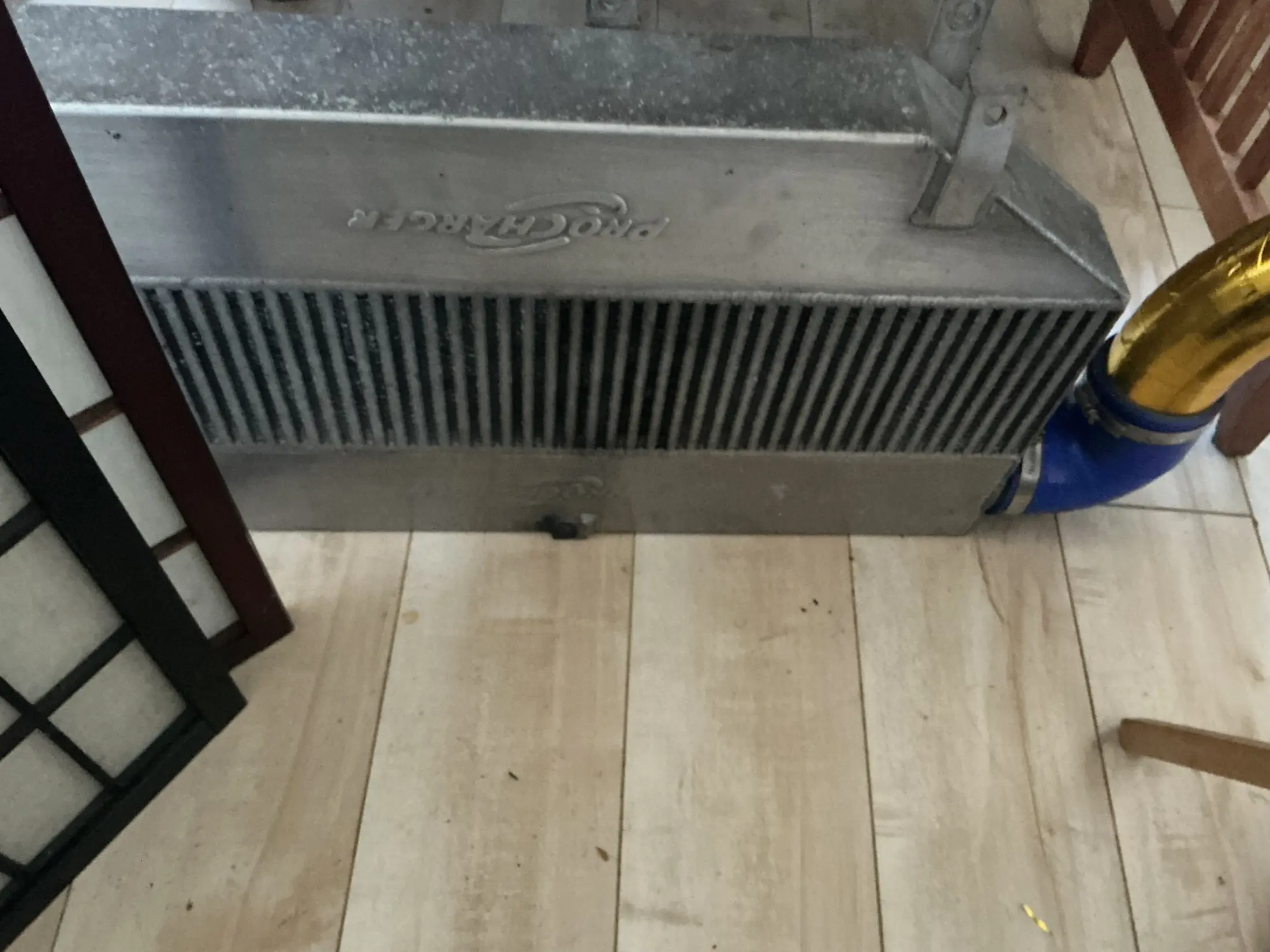

Thanks for recommendation. I think I might have found problem. Supercharger isn’t installed correctly. It’s breathing hot air, colling fan is partially blocked by intercoller piping. Racing Procharger intercooler in descreasing 60% of air flow to radiator . I already fixed all of those problems, just need to do some test driving.

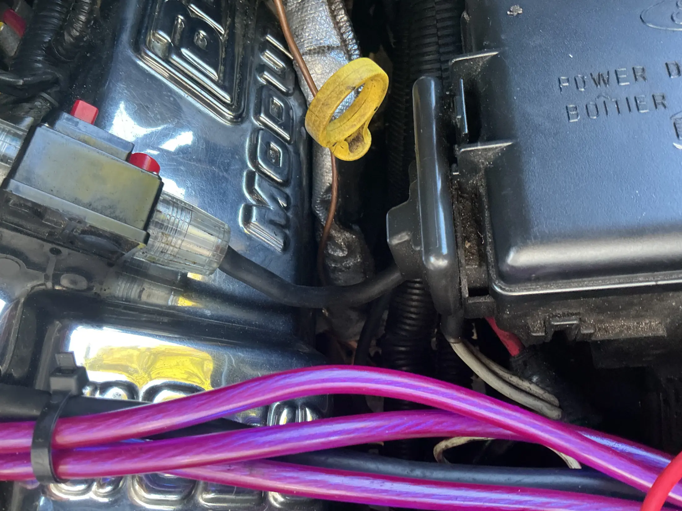

Sry for my messy car, but one of the pictures you can see that insulation is bubbling. Right by the gas pedal.
The cable is almost touching the header. But I still don’t think it’s the cable but may be wrong.

This intercooler is blocking 60% of all air flow. So that means really small amount of air flowing through the engine, and the headers are too close to the bellhousing and chassis.
