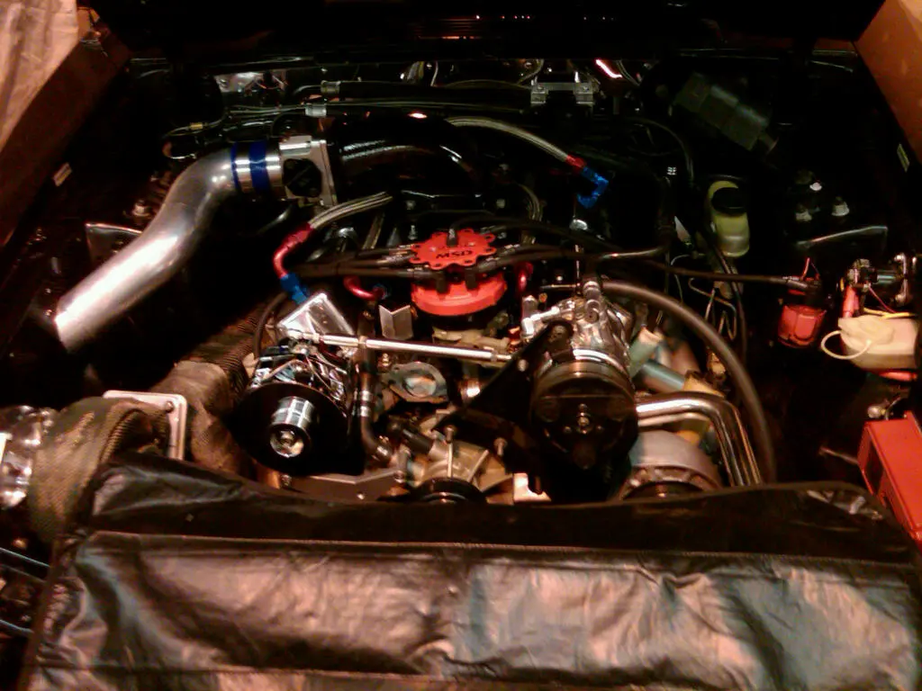

You can use -10an lines, just try to keep the can as high as possible in the engine bay so it will not want to pull oil, gravity is a bitch.
Do you run converters? If so the Evac kit isn't the best thing since if you do pull oil it can clog up the cat.
Here's a pic of a set-up I recently did -10 off each cover, -10 tee then to the can I fabricated and hid behind the passenger side shock tower.
