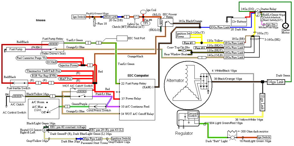

The key element here is that there is no power on either
side of the inertia switch. It should have 12 volts on at
least one side. That means the EEC power relay is not
suppling power to the computer or fuel pump circuits.
There is either a blown fuse link in the EEC power circuit or
the EEC relay has failed.
See the following website for some help from Tmoss
(diagram designer) & Stang&2Birds (website host) for
help on 88-95 wiring http://www.veryuseful.com/mustang/tech/engine
http://www.veryuseful.com/mustang/tech/engine/images/88-91eecPinout.gif

Ok, I can't seem to get my fat butt to the EEC relay, I pulled the speaker panel and glovebox and it's a tight squeeze in there but I tried to get to it.. I checked via Hissin50's post and I get no power to the WOT red wire either, so now I suspect power to the EEC is bad.
Then I go under the hood. I follow the wiring diagram I downloaded earlier in the week, and decide to check the dark blue fuse link. Seems "rubbery", like there's no wire inside. OK so the dark blue fuseable link looks bad. I cut it out of the harness, it matches up with an orange/black wire. I cut the fuse link away and temporarily jumpered it over to the solonoid stud. I get sparks, melting wire, and smoke immediately.
I'm guessing I'm not getting a good ground somewhere. Do you still think the EEC relay is still the issue?
Help?
Dan

Dan, I'm no JR or Saleen, but it sounds like a short-to-ground in the power feed wire (Or/Blk) from solenoid to the the EEC relay.
Wait for others to comment in case I'm way off target.

EXACTLY WHAT IT WAS!!! Red wire trapped under intake!!!
Removed, reconnected red wire that was smashed, hooked up orange/black to stud and "grounded the test" plug and the car starts and runs!!!
OK. Now, since I'm still not getting a ground from the ECM unless I jumper the test port, does that mean I have a bad ECM ground or is it still something else?
Dan

I didn't think you would have anything at the WOT relay since you didn't have anything at the inertia switch. I'm betting that anything connected to the output of the EEC relay and the splice won't have any power either.
I think Hissin is on track with the BK/O short. I would check both paths for that wire from the solenoid to the EEC relay and from the EEC relay to the computer.
If you can manage to remove the EEC relay it would be easy enough to check out of circuit. Just connect a 9v battery across the coil and listen for the relay to energize and verify contact closure with a meter. With the relay out it would also be an ideal time to see if there is a problem with the relay socket or other wiring in that area.
