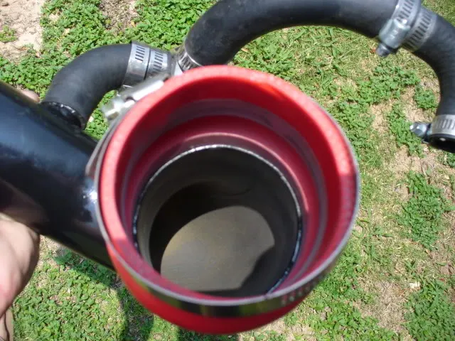

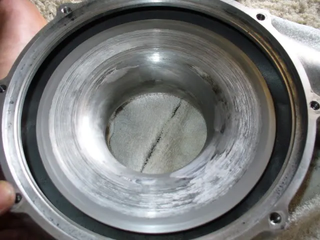

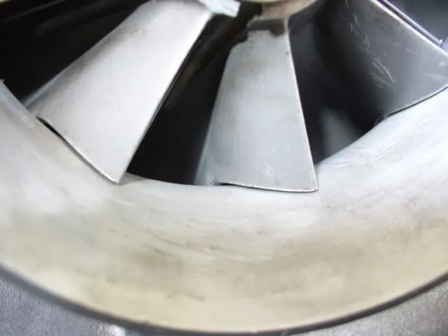

On Thursday I was cleaning the stang and decided to take the discharge pipe off. Look in it and there is a silvery powder inside the pipe going tall the way up to the plenum. Obviously the impeller has been rubbing on the housing. The shaft is still tight but the gears seem to have a bit of slack if you twist it back and forth. The belt is still on, I dont have the tools here to work on it. So in summary, it was a sad day. Ive already rebuild it and had it rebuilt again. That bi*** is cursed. I got it for free from a cousin, since then it has already blown an engine and other things.

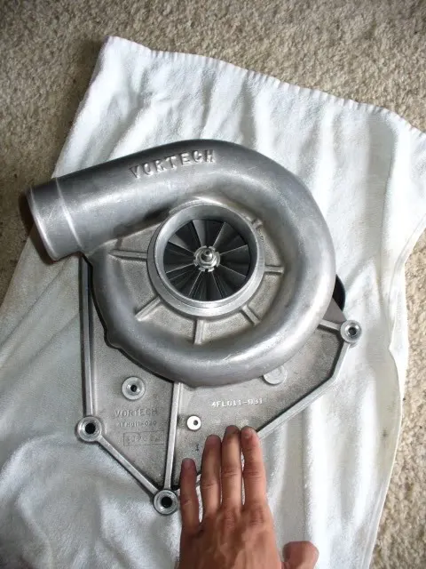

His ad below:
A used vortech V7 Y-trim supercharger. The supercharger is a great replacement for V1 and V2 supercharger because it uses the same brackets they do. The supercharger performs like a T-trim but has a high and more efficient top end. I picked the V7 Y-trim over the YSI because it is a better supercharger for higher boost but I never got there with it. I used it on the stock ls1 block and never took the just to go forged so here it is. Getting rid of the car so this has been off for a while but still has oil in it and everything. It was boosted to 10-11 PSI and has somewhere between 4000 and 5000 miles on it. Car was a street car so it really didn't get much wear on it. The blower impeller has never touched the housing and the impeller doesn't have a mark on it. The shaft has no play and the gears have no slop. The blower is a great upgrade for people that have a S-trim and are thinking of going to a T-trim because this will do everything the T-trim does but better. This is rated at 1000 horsepower and cost $3,000 new. Believe me when I say that I am going to take a huge hit on selling this item.

If you have rebuilt it twice and it now needs another rebuild I would look at a possible oiling problem. Check to make sure your lines aren't clogged or anything. It would suck to put a new blower on there and ruin it too.

blubullett I know that the oil feed line was working perfectly about 400 miles ago. I just recently changed the oil as well. Could be the prob but I havent taken the blower off to see if the bearings are crashed. The shaft doesnt have any play though, kinda weird. In any case I was going to be changing to AN oil feed and drain fittings with steel braided hose so that will come along with the new head unit.

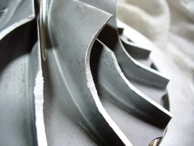

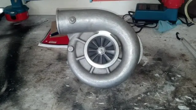

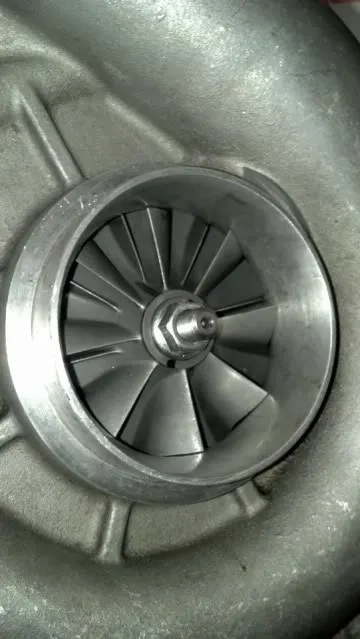

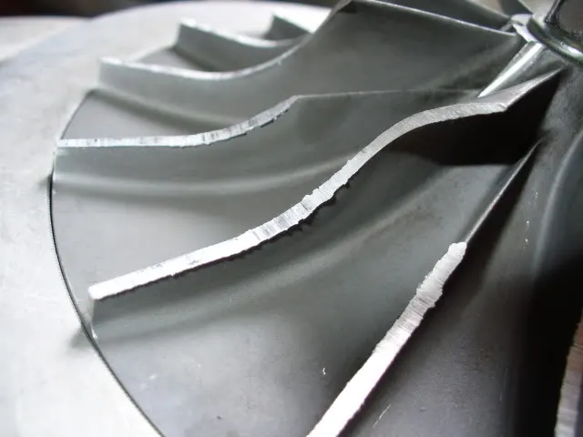

Here are a few pictures I took today while taking the vortech off. It is as I suspected, the impeller has been rubbing on the housing. It feels like one of the bearings is rough. Still saving up some cash for an new SC.
