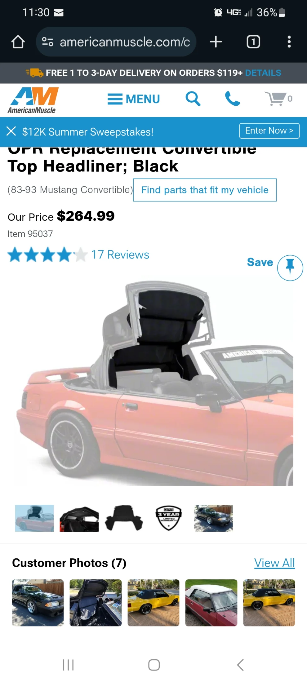

It is posible with cheaper tops. To save those types of issues I use clear flex seal spray. Used to use rubber cement but not anymore. A head liner will hide the bottom of the top, make it cooler in the summer, and warmer in the winter. They are easy to install and really make the car look a whole lot better.
While I don’t know the brand, the top does have a glass back window- imagine those would be expensive tops regardless? Anyhow, any idea what could’ve caused it if it wasn’t just :poo:ty material? I believe I have a headliner in the trunk, I’ll have to check tomorrow. Afaik none of that will stop it from creasing when I put the top down though, right? Is a patch pretty much the only option? Last thing I want is the crease being visible from the outside the way it is from the inside.
