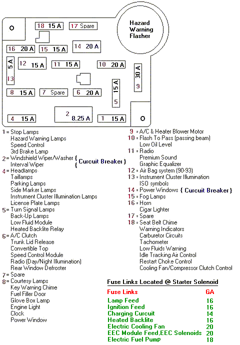

M michaelmmiller New Member Jul 13, 2006 20 0 0 Jul 24, 2006 #1 Jul 24, 2006 #1 for some reason the other day my cruise control and horn went out for no reason at the same time and i was wondering what caused this cant quite figure out why they both went out at the same time

DmnStr8 Member Apr 16, 2005 0 0 16 NH Jul 24, 2006 #2 Jul 24, 2006 #2 I believe that they both share the same fuse or relay. Check that?
jwzg Member Apr 6, 2004 237 0 16 Prattville, AL Jul 24, 2006 #3 Jul 24, 2006 #3 The fuse is the same.
jrichker StangNet's favorite TOOL In Remembrance. Thank you for your contributions Mar 10, 2000 27,512 2,813 234 Dublin GA Jul 24, 2006 #4 Jul 24, 2006 #4 Diagram courtesy of Tmoss & Stang&2birds See the following website for some help from Tmoss (diagram designer) & Stang&2Birds (website host) for help on 88-95 wiring http://www.veryuseful.com/mustang/tech/engine/ http://www.veryuseful.com/mustang/tech/engine/images/IgnitionSwitchWiring.gif http://www.veryuseful.com/mustang/tech/engine/images/fuel-alt-links-ign-ac.gif http://www.veryuseful.com/mustang/tech/engine/images/88-91_5.0_EEC_Wiring_Diagram.gif Check the cigarette lighter - it uses the same fuse. Sometimes a coin will fall into the socket & short it out. Attachments MustangFuseBox.gif 23 KB · Views: 215
