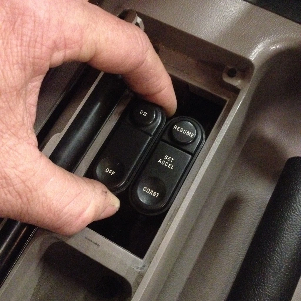

i did a grant steering wheel install. Now moving buttons for cruise to console. Can't figure it out. There's a black, purple and blue wire. I've got them all hooked up. But, when I push the button to turn the cruise on, the horn blows. I can find 50 ways to make the horn blow, but I can't get the cruise to turn on. Gotta be a simple error here. What is it?
I have my clutch switch bypassed with a 5amp mini fuse. I wonder if that might be complicating things. Because pushing the clutch in shuts off CC in correctly wired cars. But I still don't know why that would make the horn blow when I push the cruise on button
I dont know if that helps. I know the horn is tied into the cruise circuit as it all was in those rings
Btw, the pic shows the buttons from the 92 airbag wheel. I recently swapped it out for an 89 tilt column. I also tried the cruise buttons from the 89 stock wheel. Same thing happens. Push cruise on and the horn blows.

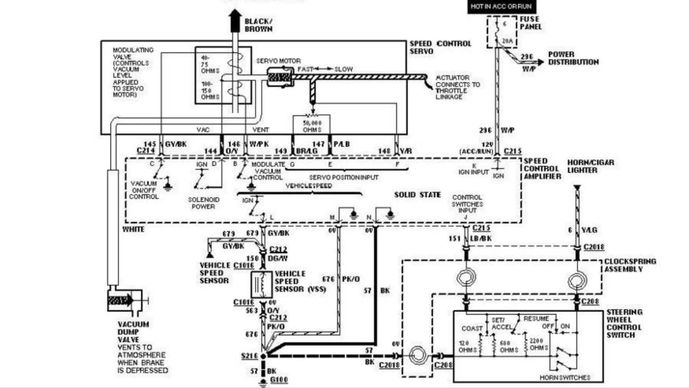

I think you have two wires swapped. The blk wire is ground, and one of the other wires will be constant 12V and the other is the signal wire to the CC solid state.
In above diagram. Blk wire is ground, yellow looks like it should be constant 12V+. The red wire would be signal to CC solid state.
When you turn cruise on, you get a connection from yellow to red wire so the CC solid will see 12V constand. As you manipulate the switches, the voltage will drop as the same power grounds to the blk wire through resistors, so you get a voltage drop on red wire.
Horn beep is yellow to black
I guess step #1 here is what color wires do you actually have. Which wire has continuity to vehicle ground, and which as constant 12V hot? Which wire is neither a ground or has power? Then we can assign those to the above three colors and figure out wiring

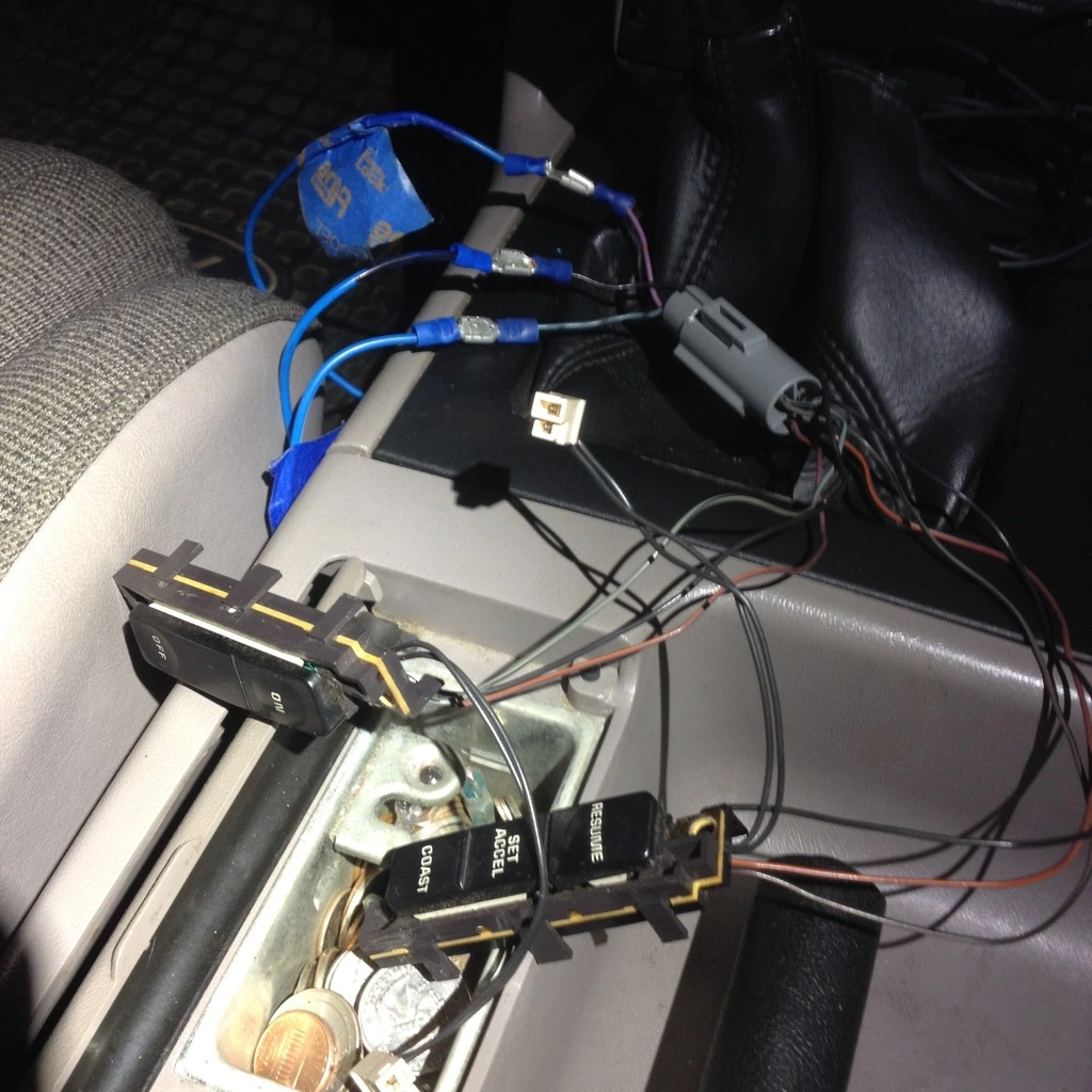

I figured out what I did wrong. When I spliced the extra lengths of wire to run them down to the console, I left the cruise control wire connected on its way up the column to the steering wheel. Up there it grounds out on the Grant horn clock spring thingy.
So, the constant hot for the horn needs to run up the column to the horn button and it also needs to be spliced to what ever location you install the cruise buttons, (in my case the ash tray location). But, the cruise activate and control wire gets clipped on its way to the column and only goes to the button location.

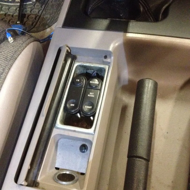

I noticed in the pic above that there is a fair amount of normal funk build up around the ashtray area, and the buttons themselves.
Do You think you could offer up a cleaning solution so as to make the future reloc area for those buttons look like they belong there?
What do you say Davie Homemaker?
Cleaning solution? Like windex?
As for making a surround for the buttons, you're the man for fabrication. I just make sht look like it did before, not much brain power involved there.
I'm not finished but I decided to use the ash tray itself as a mounting platform. The '89 CC switches were just a tad too wide to fit in so I shaved them on the sides a tiny bit with the bench grinder, very delicately. I drilled a hole in the front of the ash tray to run the CC harness plug up under the console. I also drilled 4 holes in the bottom of the ash tray which I used to run longer screws up into the switches for securing them. They are rock solid in the pictured position. Using the ash tray gives them a nice recessed position so the tray lid closes nicely. I just need to fabricate a nice trim piece to close in the gaps.
