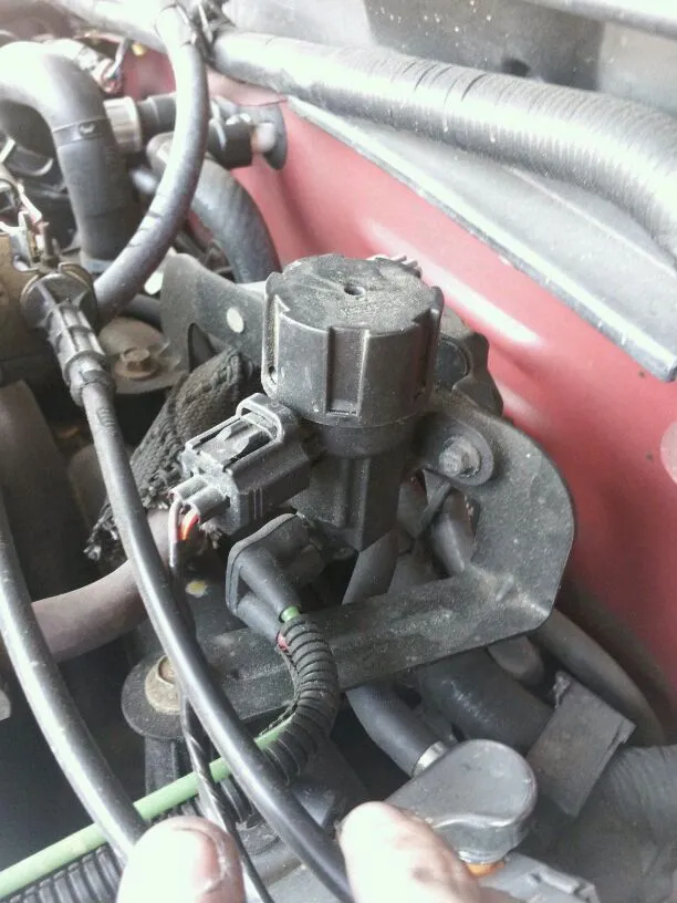

Is this the DFPE?

Well just got back from the test drive after pulling the vacuum hose from the DPFE. I drove it hard, soft, backwards and sideways ;) and not one time did she spit, spudder, chug, or jerk.
Looks like I'll be picking up a new one on my lunch break tomorrow.
