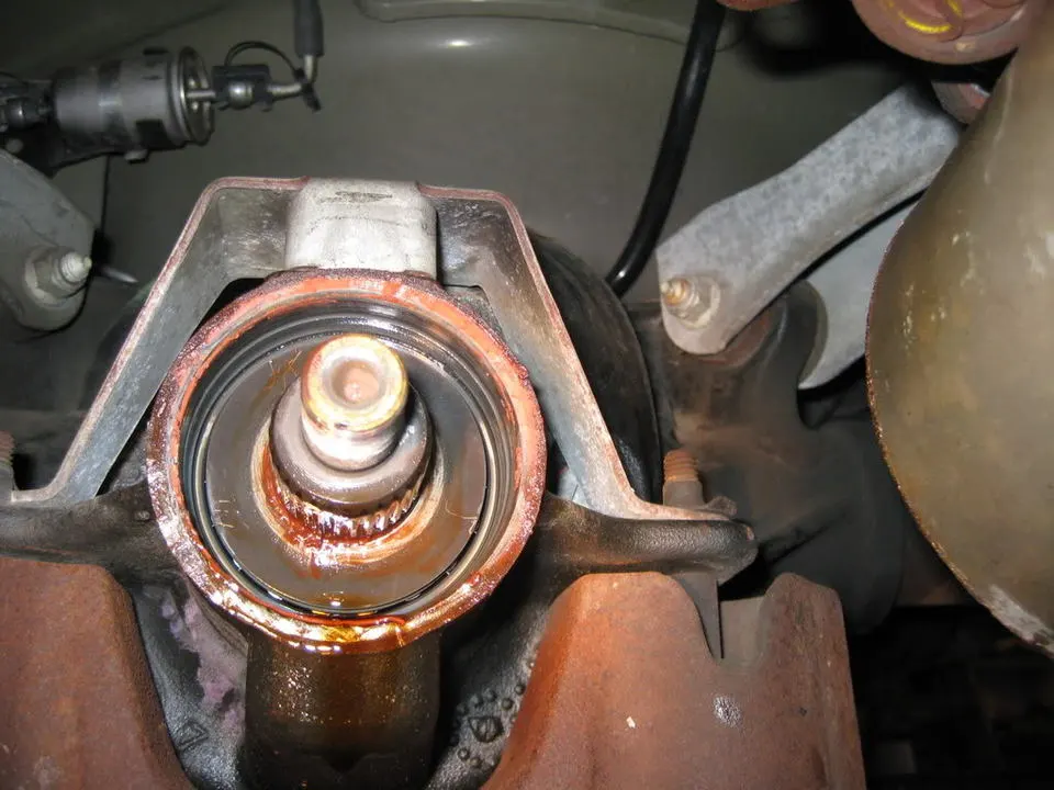

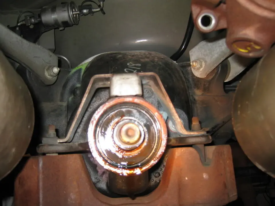

Ive got it up on jackstands now haha. And I did go ahead and snug it down then realizing that i didnt even use the sleeve.......here is what I saw with the pinion nut off right before I put the new seal on.
If you're just replacing the seal you don't absolutely have to replace the crush sleeve. Doing so requires the axles to be removed and the diff carrier to come out. Kinda involved and nasty for just a seal...
If you measured the torque required to turn the pinion before removing the pinion nut, you could reassemble it and tighten the nut until you see that, or slightly greater, preload torque.
If you didn't record the preload prior to disassembly, you'll just be guessing and should probably take it all down to put a new one in.
awesome yeah i have the preload it was at 9 lbs which is in the the ok range in the haynes manual. I just second guessed myself when i didnt see the sleeve int he first place. thanks for the help!
