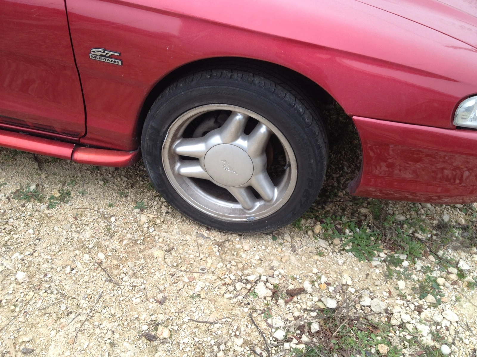

Anyways, here are the pictures.
The wheel is set back pretty far

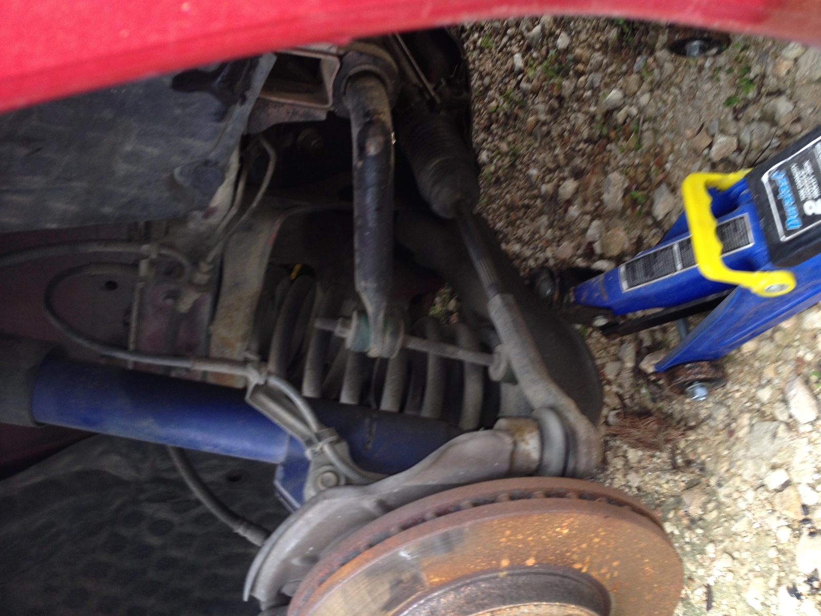

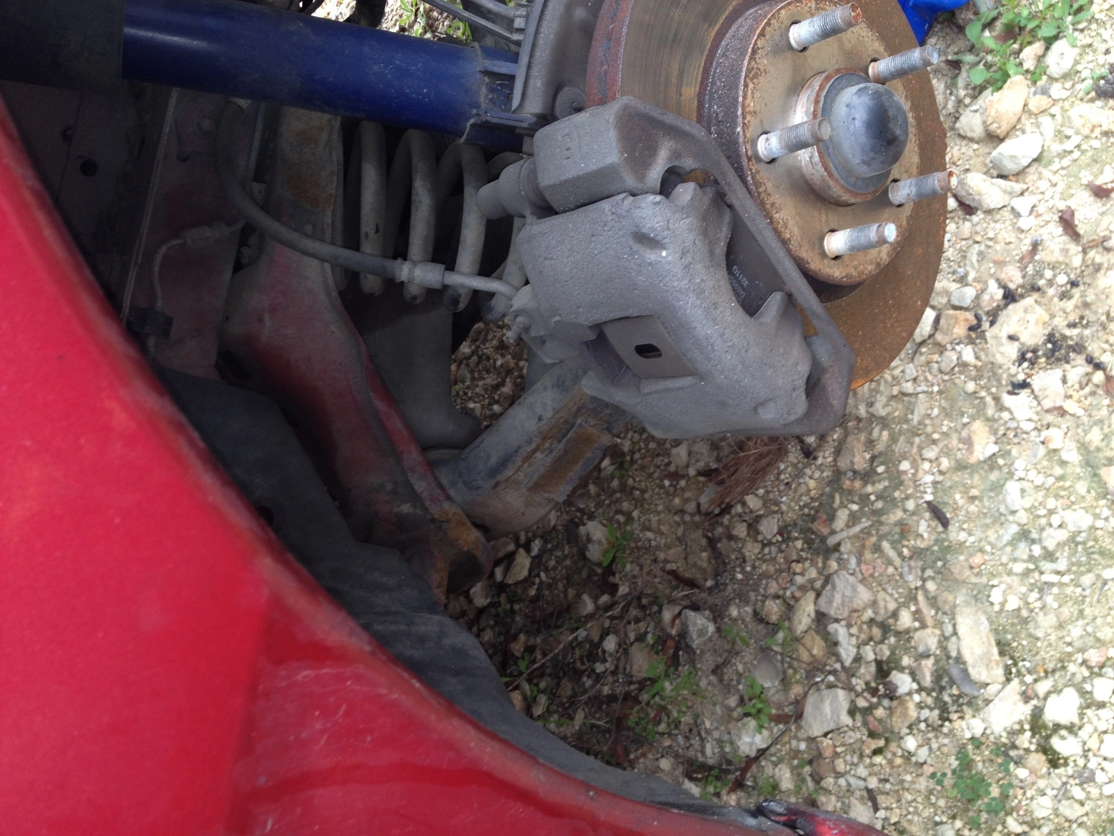

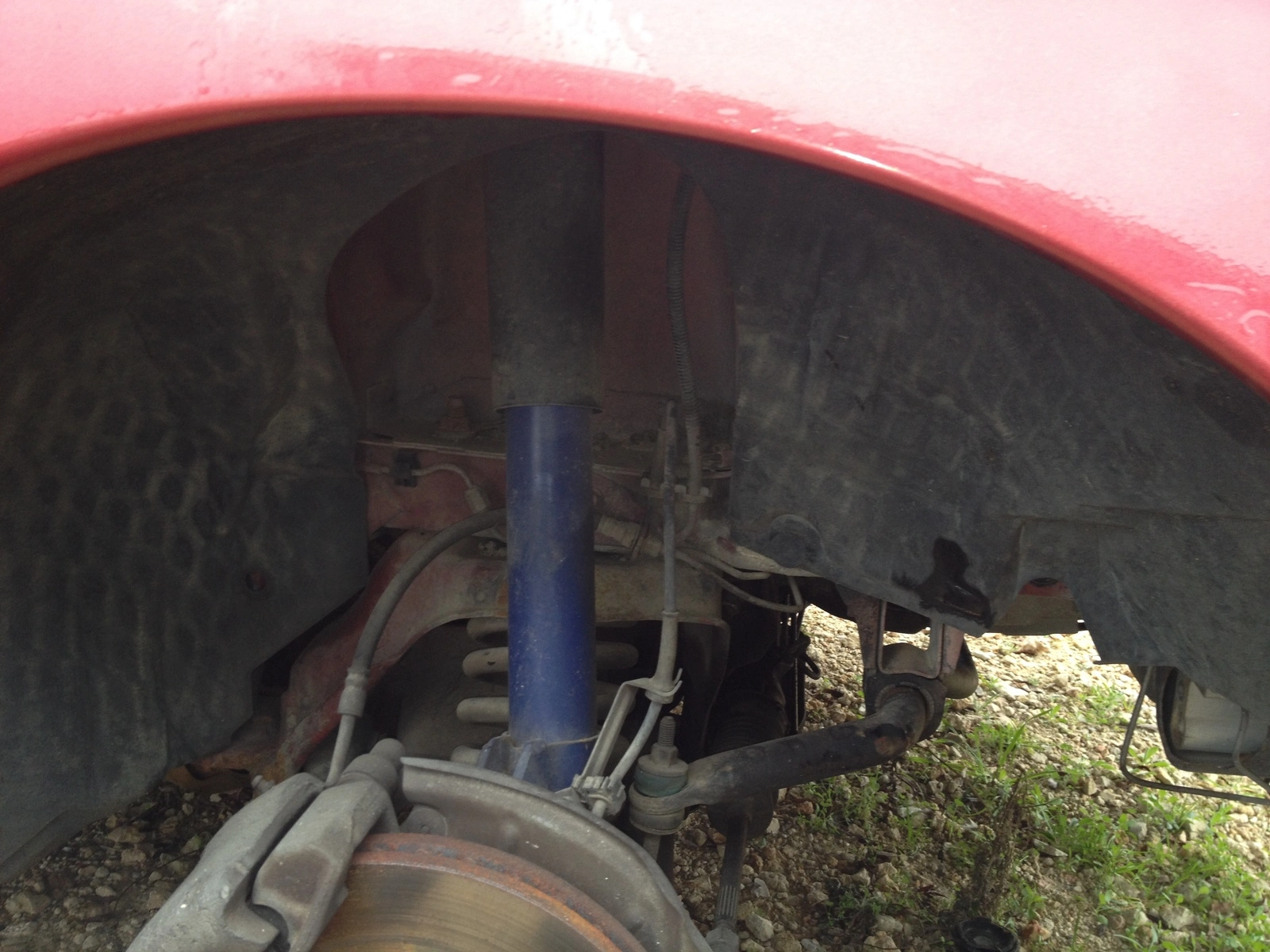

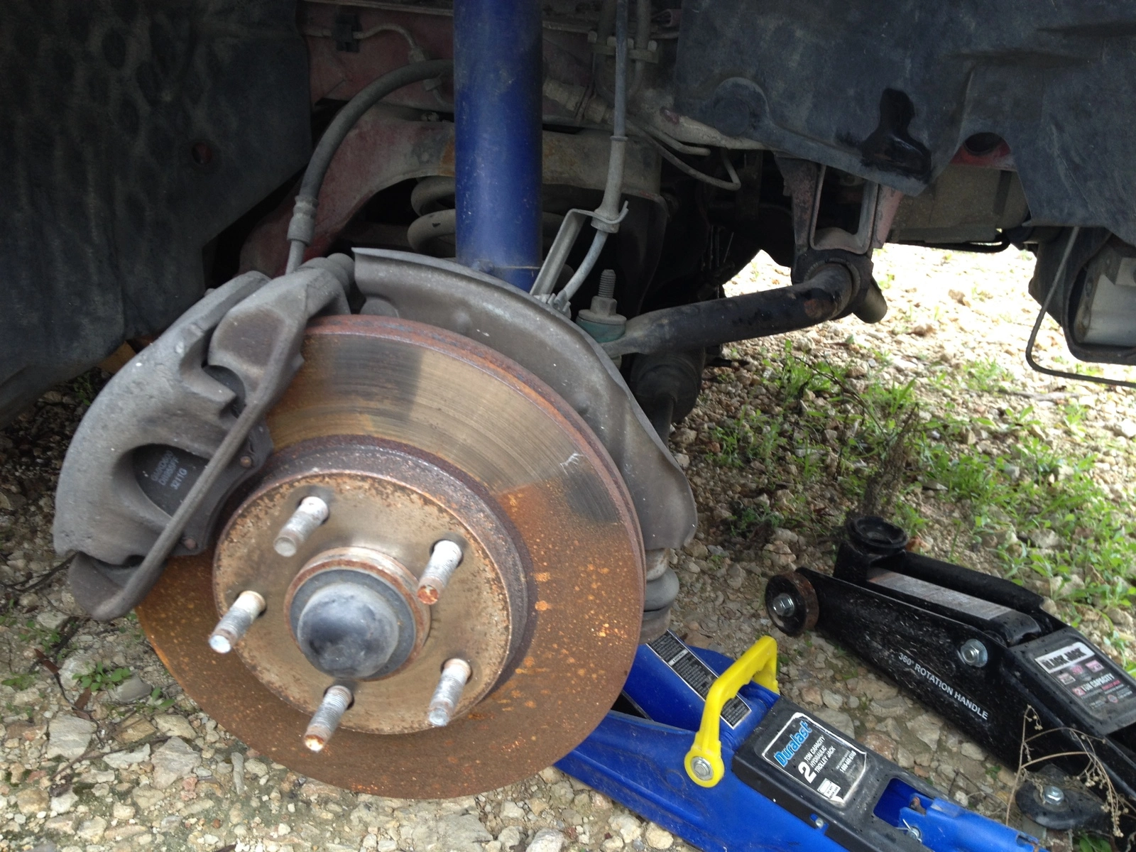

The spindle and a-arm (along with k-member) look fine to me, control arm looks questionable, but you guys are the experts so whats say you all now? :D

Those aren't the best pictures.
The wheel is clearly not centered.
it looks as if the lower portion of the sway bar endlink is going towards the rear.
these should go straight up and down, no?
I can't tell the condition of the a arm or spindle.
I would start at the k member.
Look for signs that it has shifted to the rear on the passenger side.
I agree with Davis, the k-member looks misaligned. The brake lines that go under the subframe look pretty far from the k-member; mine hug pretty close to my k-member.
When you check the k-member, start measuring distances from parts like the radiator support; both sides should be pretty close.
