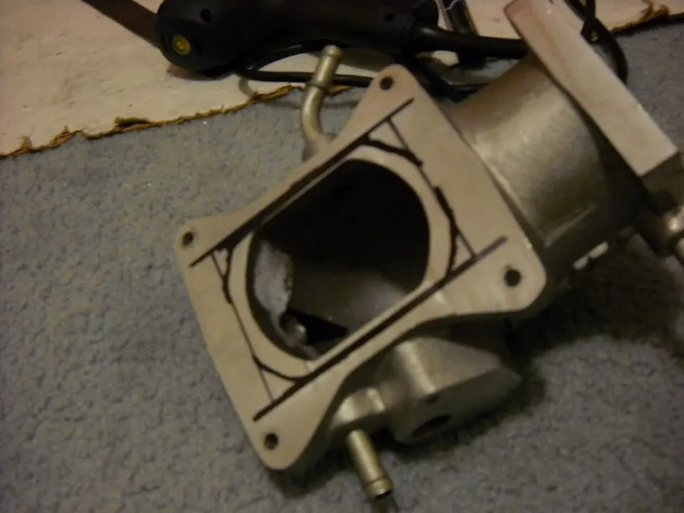

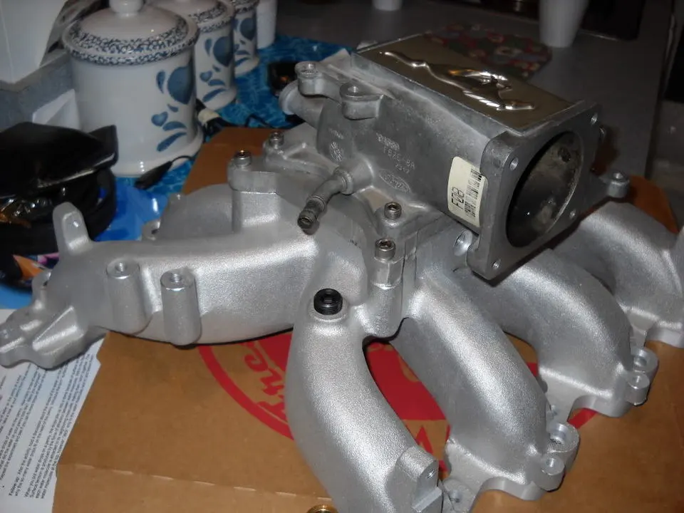

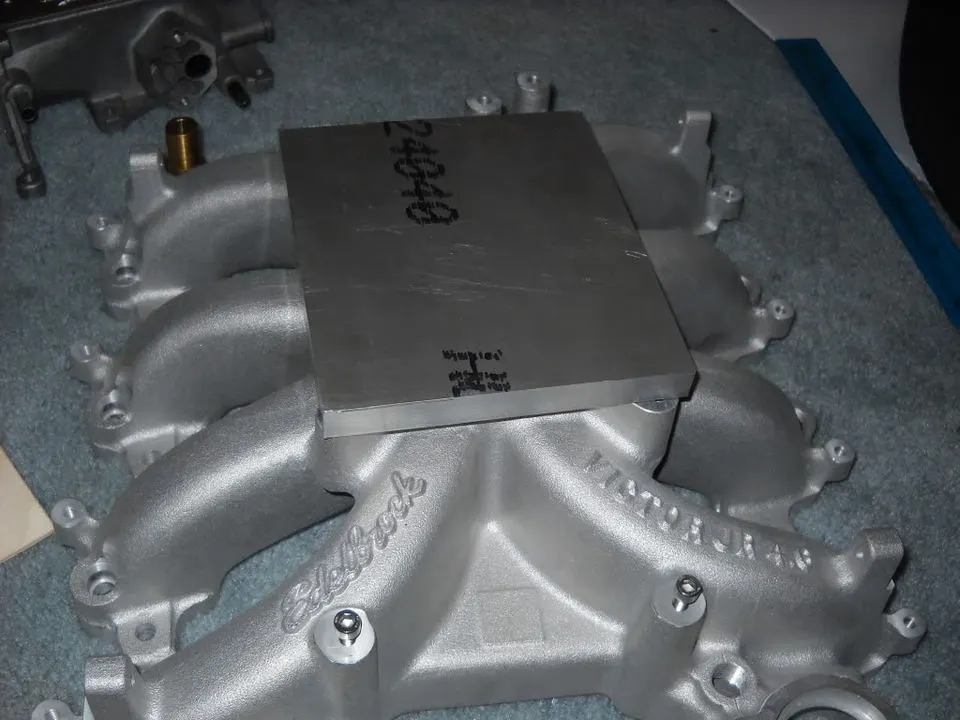

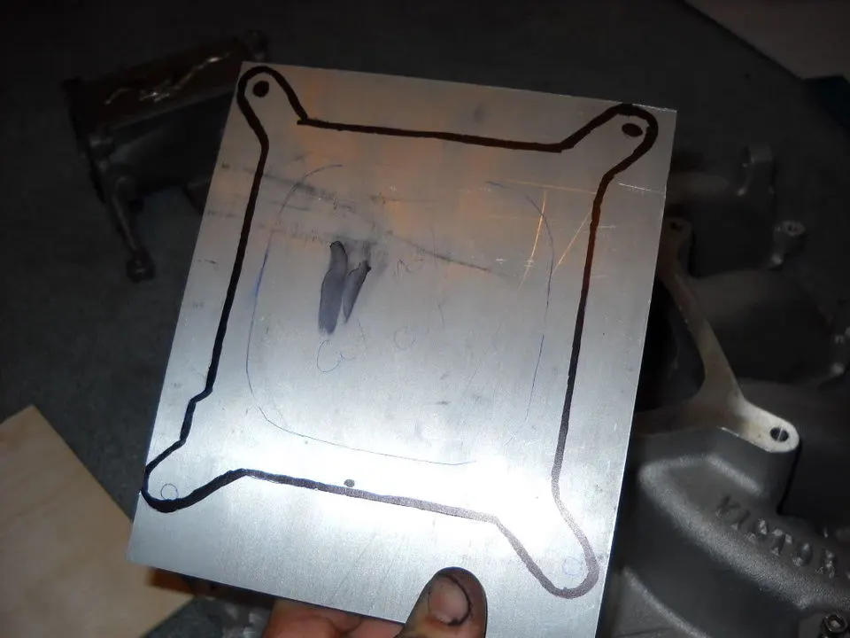

started out with a peice of aluminum 6 x 6 1/2 x 5/8

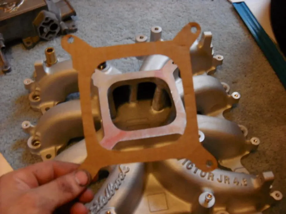

made a template
after about an hour and a half of work on the scroll saw and drill press...
just using the stock plenium as mock up
its not complety done yet, i still want to clean up some of the edges and sand blast it to make it dull to match the intake and C&L plenium
tell me what you think. btw MMR plate = $70 plus shipping, mine = about $40 and about 2 hours of work............

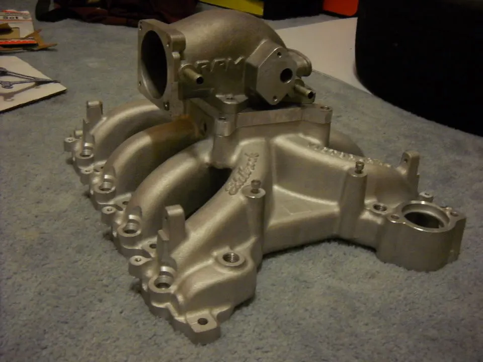

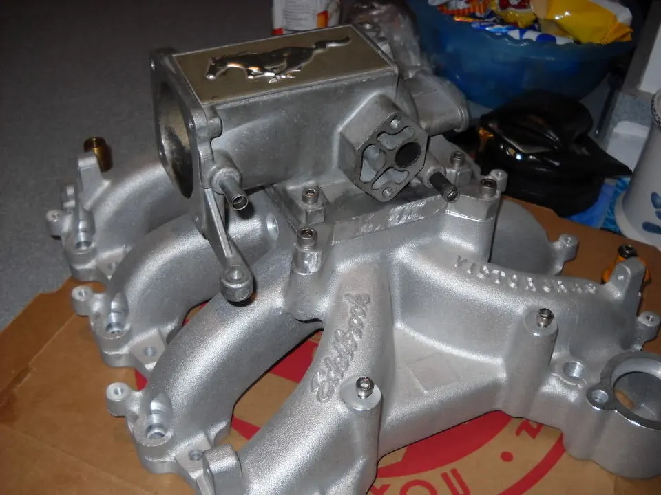

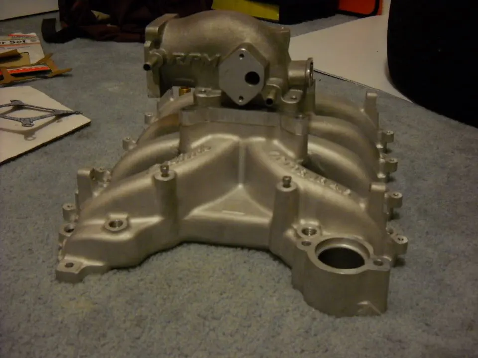

with the stock plenum it might clear the hood , but with the C&L i doubt it would.... not a chance.... especially that i heard this intake is actually taller then stock , you might wana check clearance but i guess you can slice it into 6 slides and make money off it
my car aftermarket plenum didn't clear with a similar raise with the direct port nitrous kit , so this is something to look out from.

the C&L it 3/4" taller then the stock one, but i have a 2.5in cobra R hood, so i think it will fit

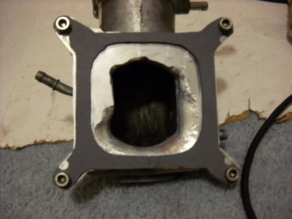

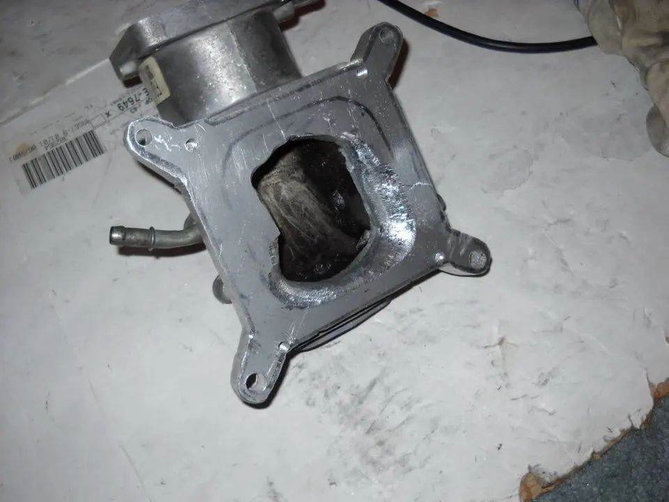

In regards to your custom adapter, did you blend the smaller intake elbow opening into the large square bore opening to help eliminate turbulence?

i was waiting for some one to ask! im working on it now, ive been doing it with my cardide bits, but it 6160 aircraft aluminum, to its pretty hard, ill be sure to update this with pics when im done..........

ive been working on matching the stock plenuim with the 4 barrel flange, i started out with a rough cut on the scroll saw and im using the carbide bits to blend it in...
allmost 1/2 way done....lol

well started on the C&L, its very thick, so it will be opened up a lot, to almost match the intake!
oh yeah!!! its going to be ported to the max!
