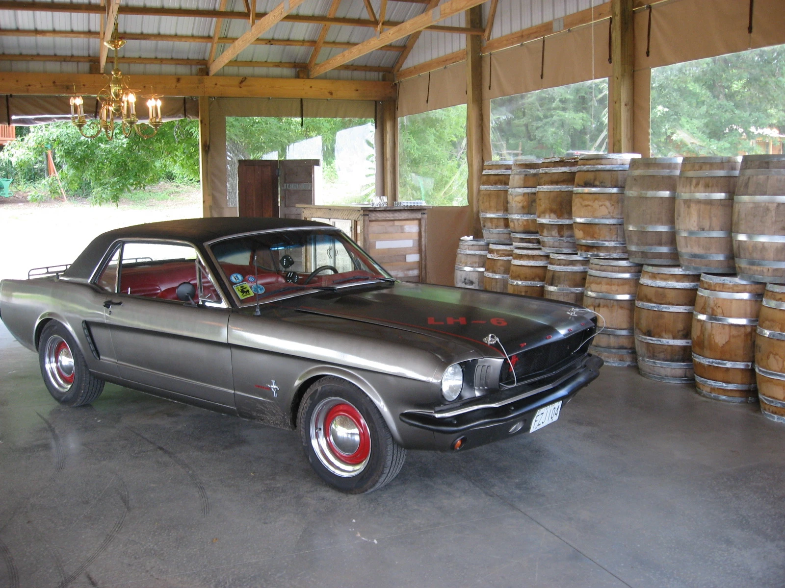

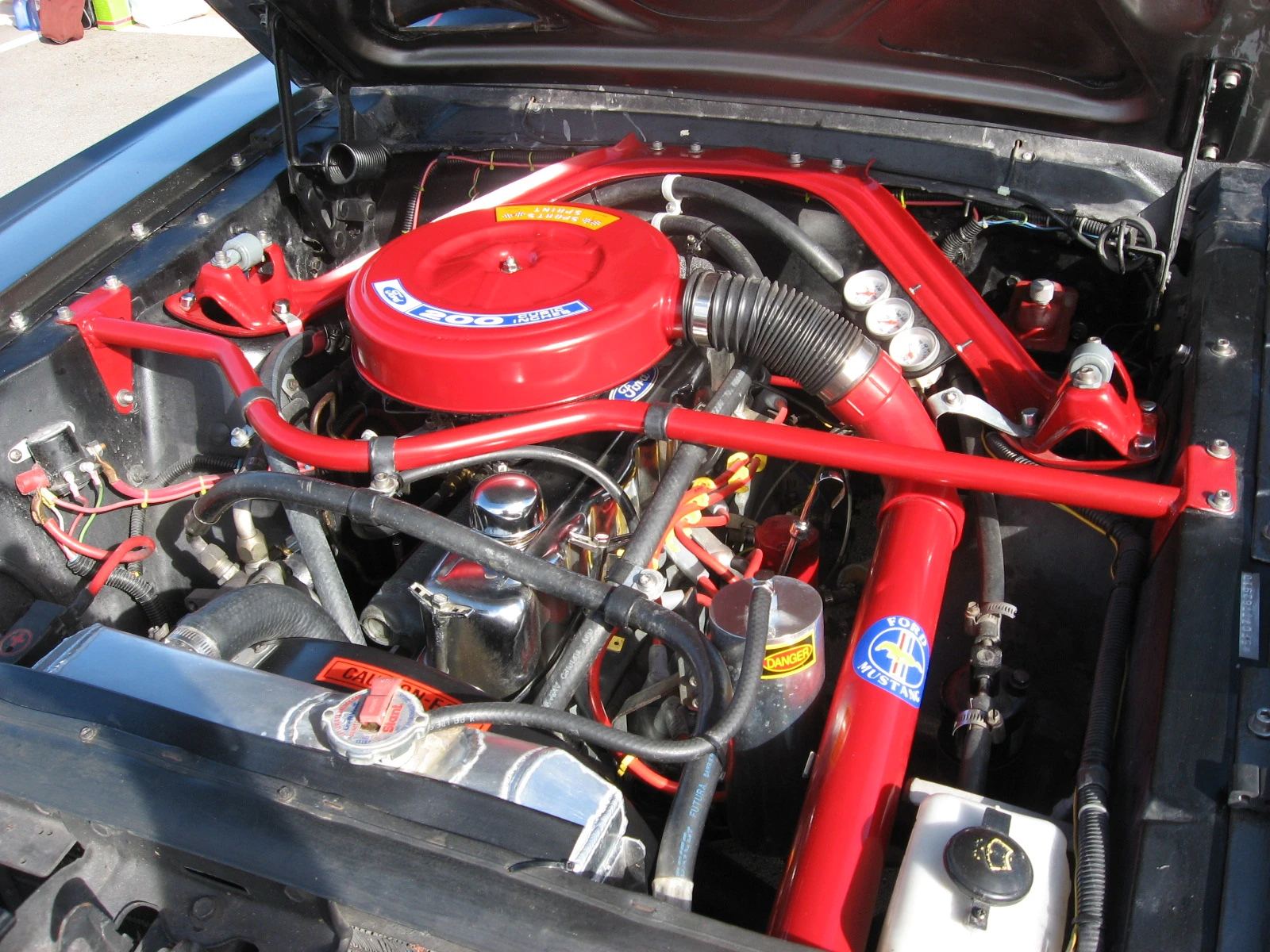

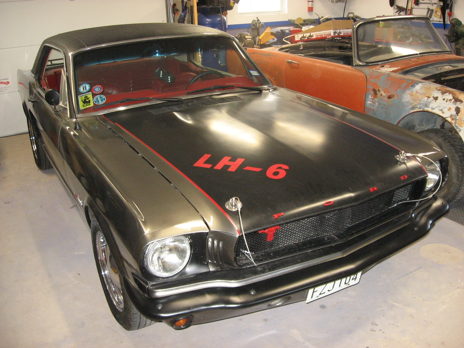

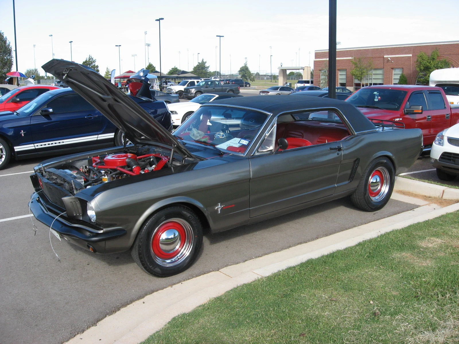

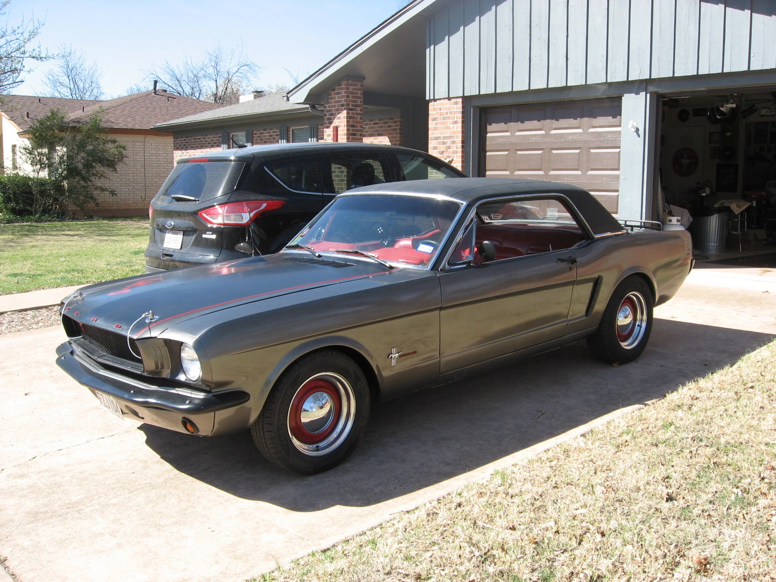

As a long-time car guy I decided to do work on the wife's 6-cylinder 65 coupe. After adapting a 2-barrel, boring it .060", opening up the exhaust, building a cool-air intake, installing a mild cam (basically a stock replacement with earlier closing intake valve), making a hotter ignition and doing head work for today's ethanol, it ran pretty good...for a six. Installing front discs with a dual chamber master and installing an AC compressor that uses about half the HP the OEM did, it needed suspension help. With V8 rear leafs (85 lbs. stock to 115 lbs. V8), 1" lowering blocks, a rear sway-bar, gas shocks, 15" 70 series radials, and poly bushings, the rear was much better. In front I replaced the stock OEM coils with V8 GT's cut 3/4 of a turn, replaced the sway-bar bushings with poly, installed gas shocks, a Monte Carlo Bar, Export Brace and wider 15" radials. With automatic and 2.83 gears it will never be a drag racer, but once up to around 2500 RPM it really pulls through turns with the modifications listed. The 6 is about 300 pounds lighter than a V8 and by adding about 35 HP it pulls much better than I expected. So much so...it is now MINE! For first generation Mustangs thinking about the expected V8 swap, give some serious thought to keeping the 6, especially if you plan to drive it on the street. I drove it to Tennessee from west Texas this summer and had a blast getting 24.5 MPG running 75 MPH with the Big Boys, running the AC all the way. It is always a shock when I open the hood. The LH-6 on the hood stands for Long Haul-6 cylinder, and we drove it 2,275 miles this summer on just one vacation having as much fun as the V8 guys.
