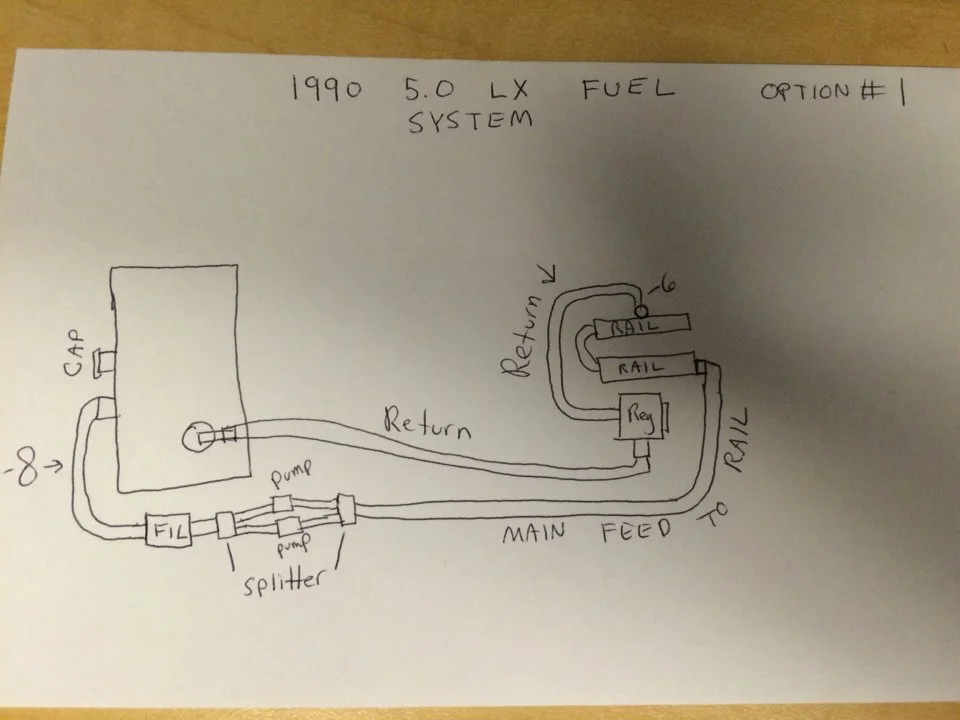

Hello,

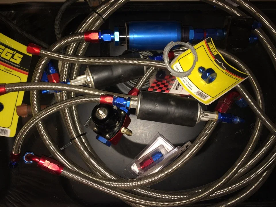

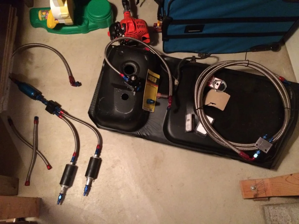

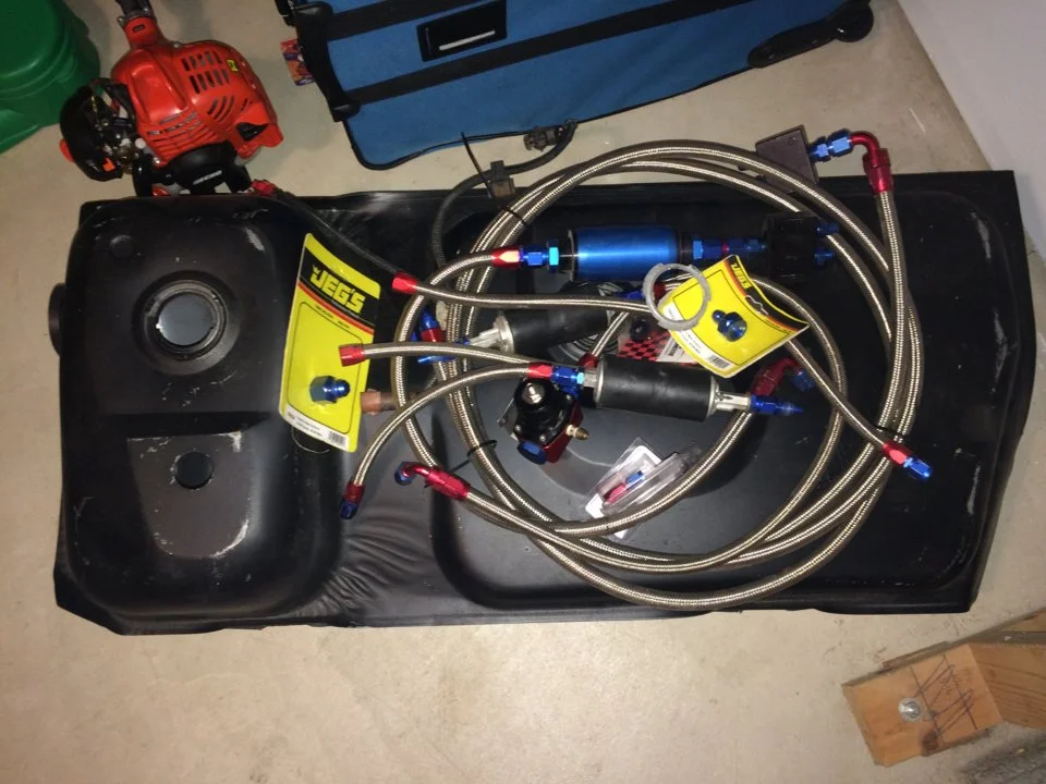

I have attached my proposed diagram for my setup. Keep in mind, I bought the system with the car and it came off of a Fox Body 5.0 and is going onto my 1990 5.0 LX hatch. The main line is -8 and the return from the rail to the regulator is -6 fittings. I got all the parts together and they are a little older. They are Aeromotive but the parts dont have parts numbers on them. Pics are attached so any help identifying them would be great. I think the large blue thing is an older style fuel filter and it came with two pumps (they have the "+" and "-" for power on both). So far my engine is N/A and is pushing 350-400hp. Anyways, comments or suggestions would be MUCH appreciated. Should I run a duel pump or single for now? I will put a Vortech on it soon too. Thanks!

I don't like your return coming from the center of the second rail. The best way would be to feed the back of the rails in parallel via a Y block and then another Y block on the return side and then into the regulator. Some regulators can be used as the return Y block. Requires a few more fittings, but you'll have equal flow across all injectors.
Ok. Do you think I should drop down to a single pump for now or install both? I can definelty wire in the inertia switch too. Ill buy a kit from Aeromotive. Thanks so far.
How much flow are the pumps rated for? How much current do they draw?
What are your HP goals?
Answer those questions first, and the answers will be much simpler.
