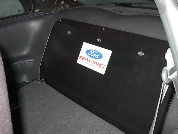

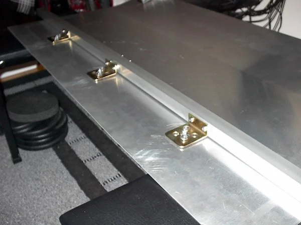

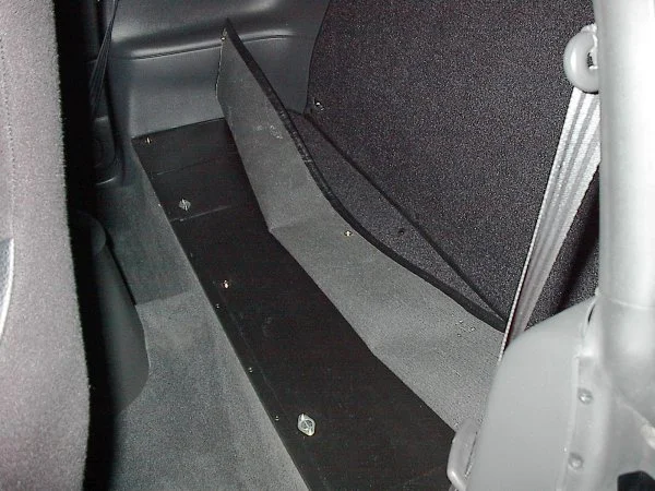

Bugman.dave said:
Hear is some shots of my rear seat delete,..it's made out of aluminum and the carpeting is held on with dome fasteners. The aluminum is removeable and held in place with Dzus fasteners,...
That's a very clean set-up. How much did that all cost you?

If I was to do it all again it would cost me less as I had made some mistakes and only through trial and error came to this completed look. The carpeting was done by an old hippie for $80 CDN,...the sheet aluminum would have been cheaper if I had done it right the first time also. You'd have to check on the price of aluminum in your area. The back portion of the bottom piece rests on fasteners secured through a hole in some sheet metal that originally was used to hold the back seat brackets. I have to take everything apart again so a fabricator can install an 8 point roll cage,...I'll take more pictures of the brackets etc. actually very little fabricating that had to be done by a pro,...The dzus fasteners are quite expensive and a real pain to fit properly,...but hey it can be done.
Back to the old hippie,..he had a male cat in his shop,...I had put the carpeting in the car and the first day in the sun, I remembered he had a cat,...damn cat peed on the carpeting,....took a while to find a cleanser that would remove the smell,.....Ok I vented,...I feel better now,...want help let me know

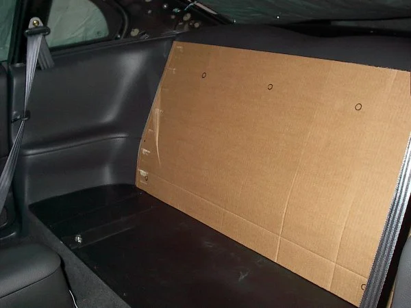

The cardboard is real slick.

Yes, that's my favorite part also,...I had it fitted there first,...then realized that hey, I can use it for a template and maybe make the seat delete out of something else,...something stronger, lighter, faster,......so I tried aluminum and ya know it worked even better,....
Ha, thanks for the interest in my seat delete,..if you want help with installing your cardboard, just let me know,....
