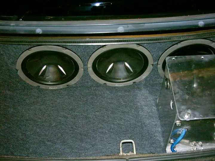

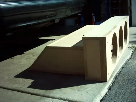

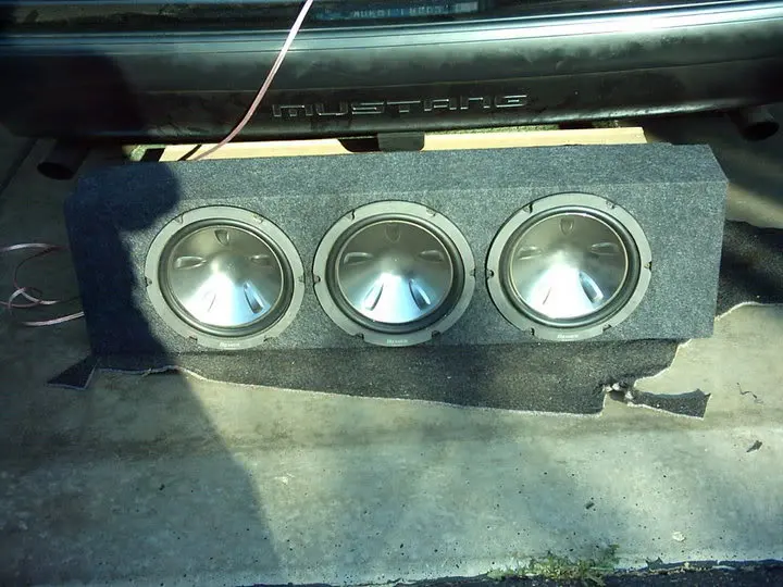

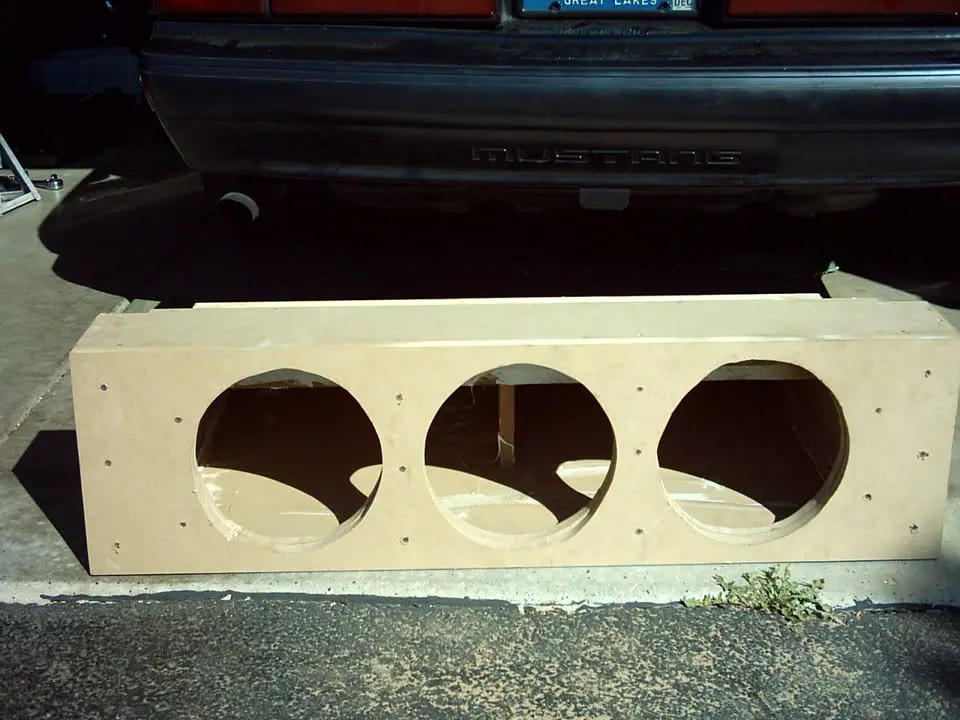

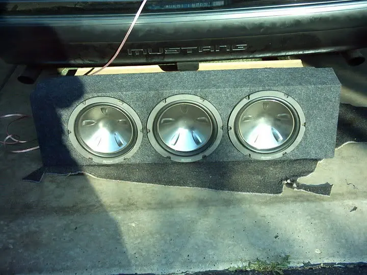

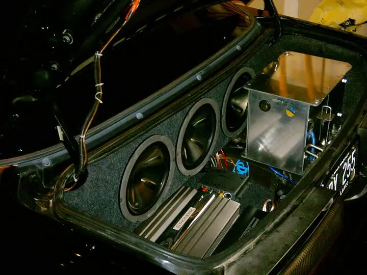

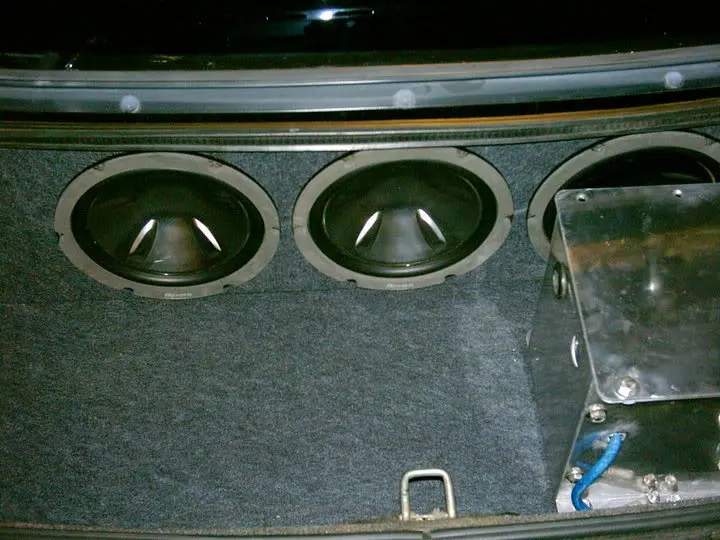

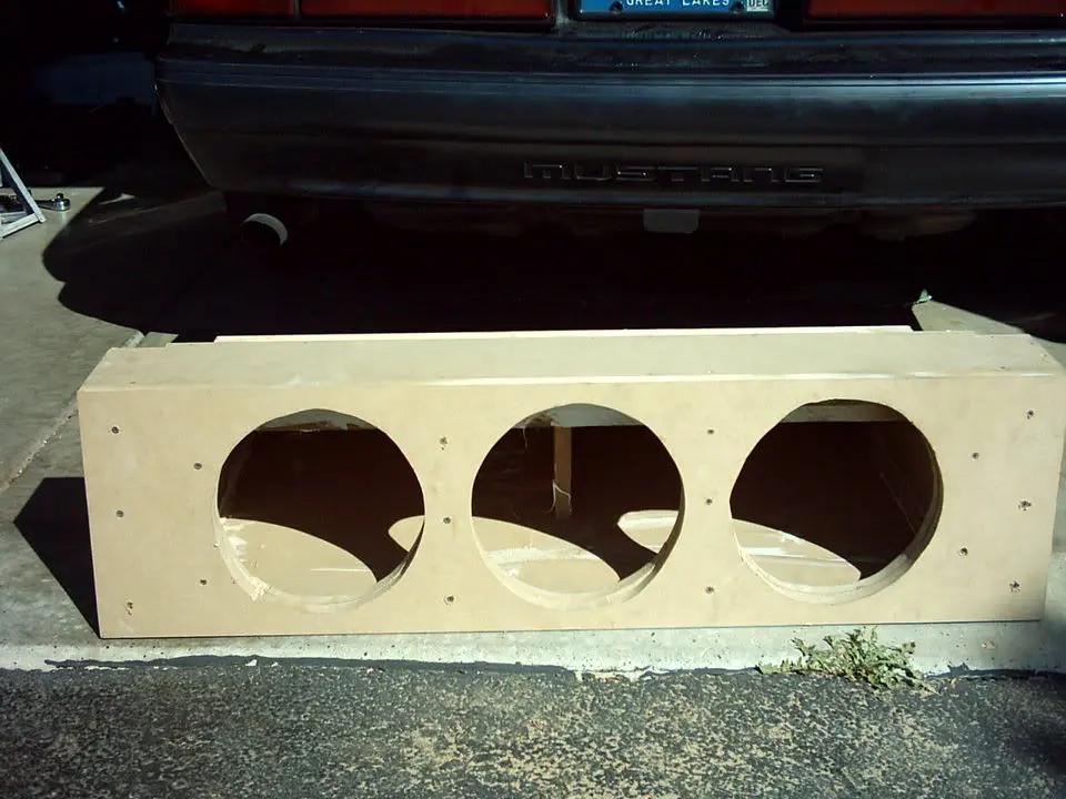

this is the box, fits like a glove:

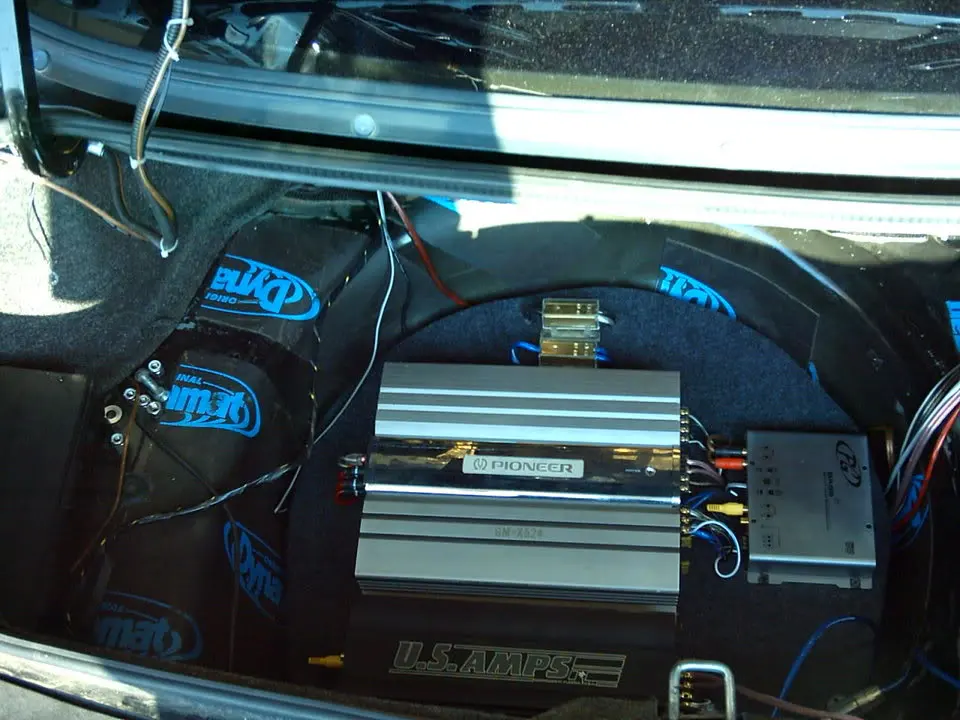

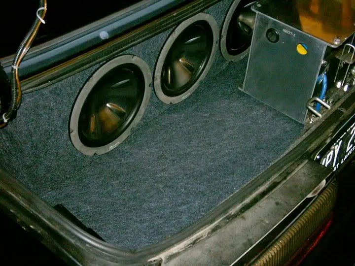

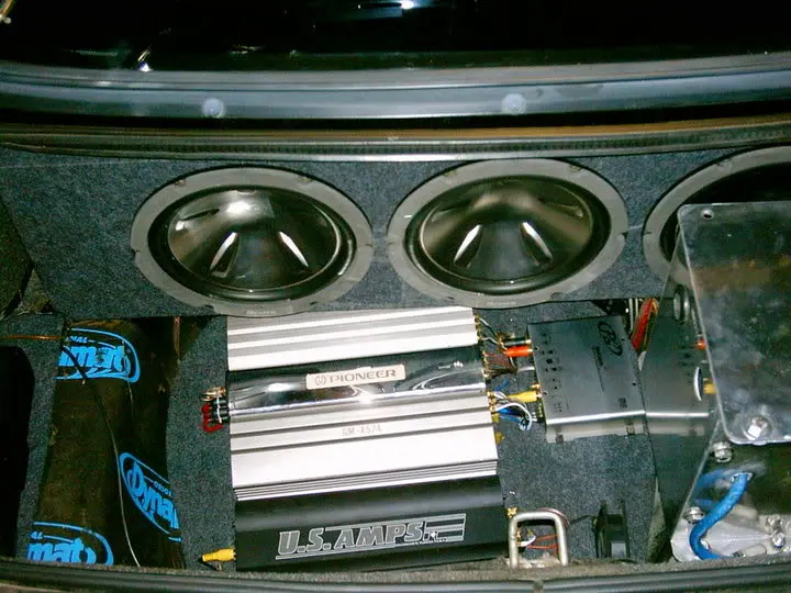

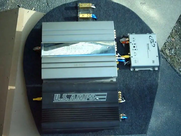

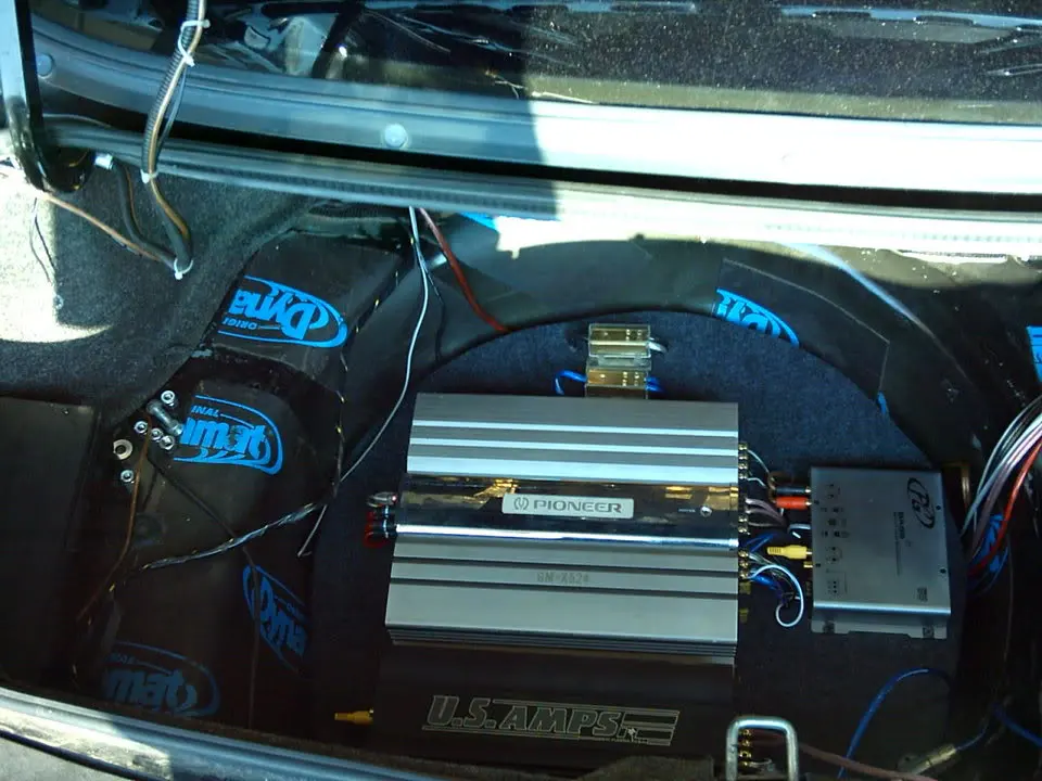

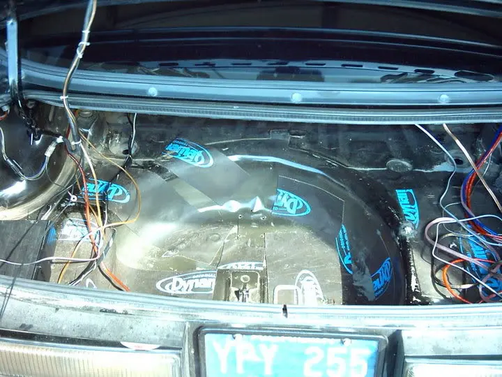

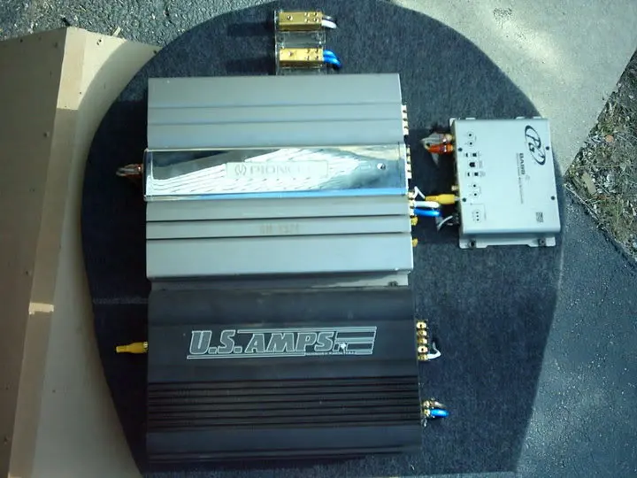

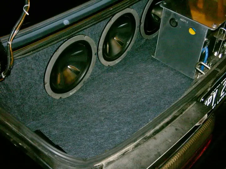

This is the amp rack that goes where the spare used to.
in the car
subzzz
man i cant believe you found a way to do that. the coupe's trunk is a PITA for space. ill get a pic of my box in there as soon as i can (pre-fab). i cut a piece of wood (not perfect..just to do its job) similar to your amp rack, and then dropped the box on top of that in the spare well. looks good man, and what subs?
those are pioneer premier subs, i had (6) in my explorer, and this is half of them. they run of that tiny :lol: us amp at 1.33 ohms.
the box fits, so tight that, if this was a woman id be in jail for 3-6 years.
the amp rack fit in there rially tight, and i drilled a hole in the loop in the botom of the well and put the screw through there, i was very cautious of the fuel tank.
If i had more time i would have fabricated a gas operated shock to open the trunk, i hate those bars, but i just built the box to keep em' air space came out @ .788 for each sub :shrug: i put some polly fill in there, and there deep as all hell, i have a rear seat delete, ill get some more pix up, no one responded for a while so i thought this tread was dead.

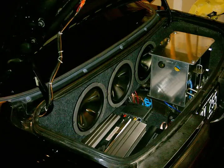

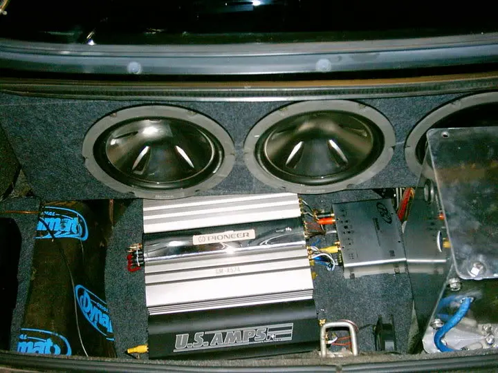

yeah, i went out for about 2 hours and had the music loud, the amp that runs the subs went in to shut down. So as you can see in the pic sorta, i added a cooling fan you can see b/c its the only set of wires i didnt fish under the amp rack, b/c i cant get the amp rack out when the subs are in, and i cant get the subs out when the batts. in. and taking the batt out is a bitch :lol: :rlaugh:
but it fits so im happy..

if you have a circular saw, jig saw, and drill, you can build your own
use MDF (medium density fiberboard) and 12x12x12=1728 which is 1 cubic foot of airspace, find out what your sub needs and go from there, its soo simple you cant mess it up..
