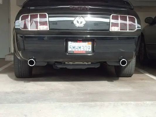

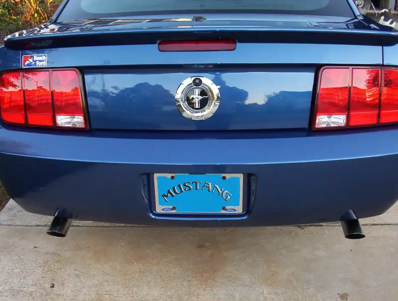

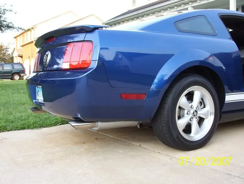

Below are a some examples of the cut out. You can also go to YouTube and type in 2007 Mustang V6 Exhaust and you'll get some video images of it.
The Vista Blue Stang is mine, the black one is member from another forum;

Looks fine. There are some trim rings available too that would help cover any rough edges or mistakes made while cutting.
If you sand it down with fine sand paper then touch up the edge with Motorcraft Touch-up Paint, then you will never know it has been cut.
The advantage to having the trim covers is making sure the tail pipe never touches the plastic.
Just take your time and don't make a mistake. :)
