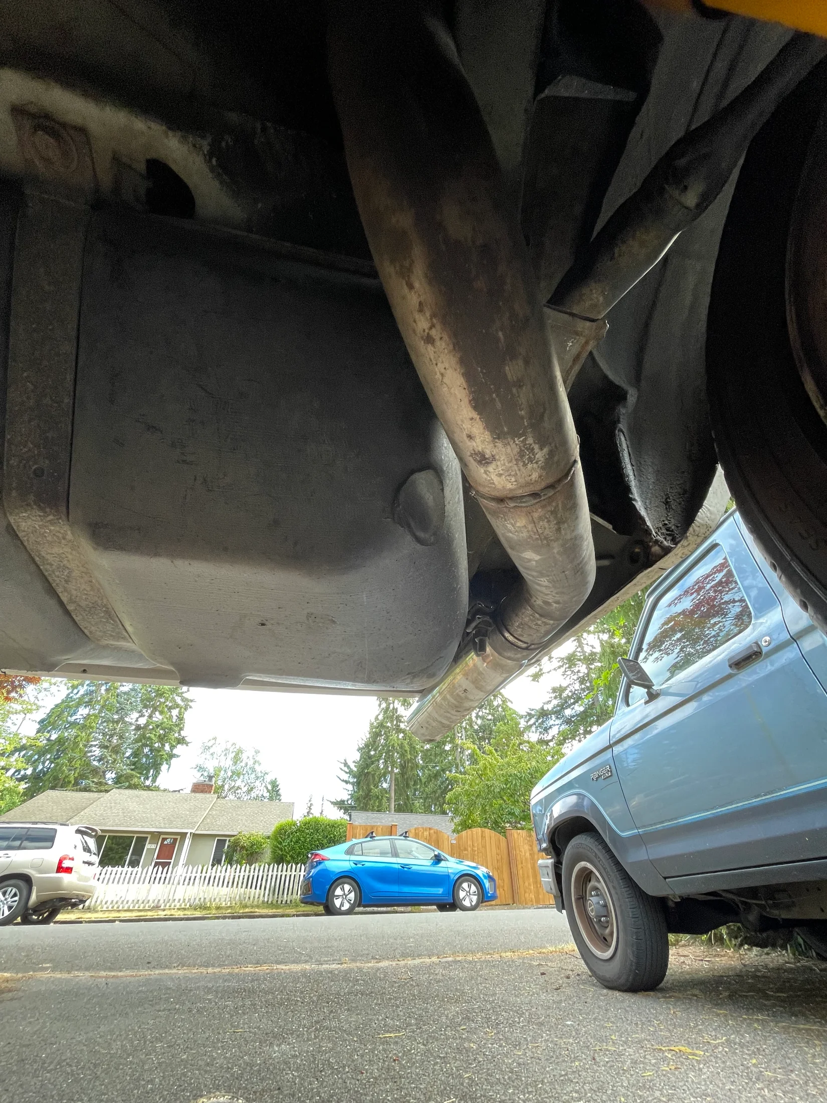

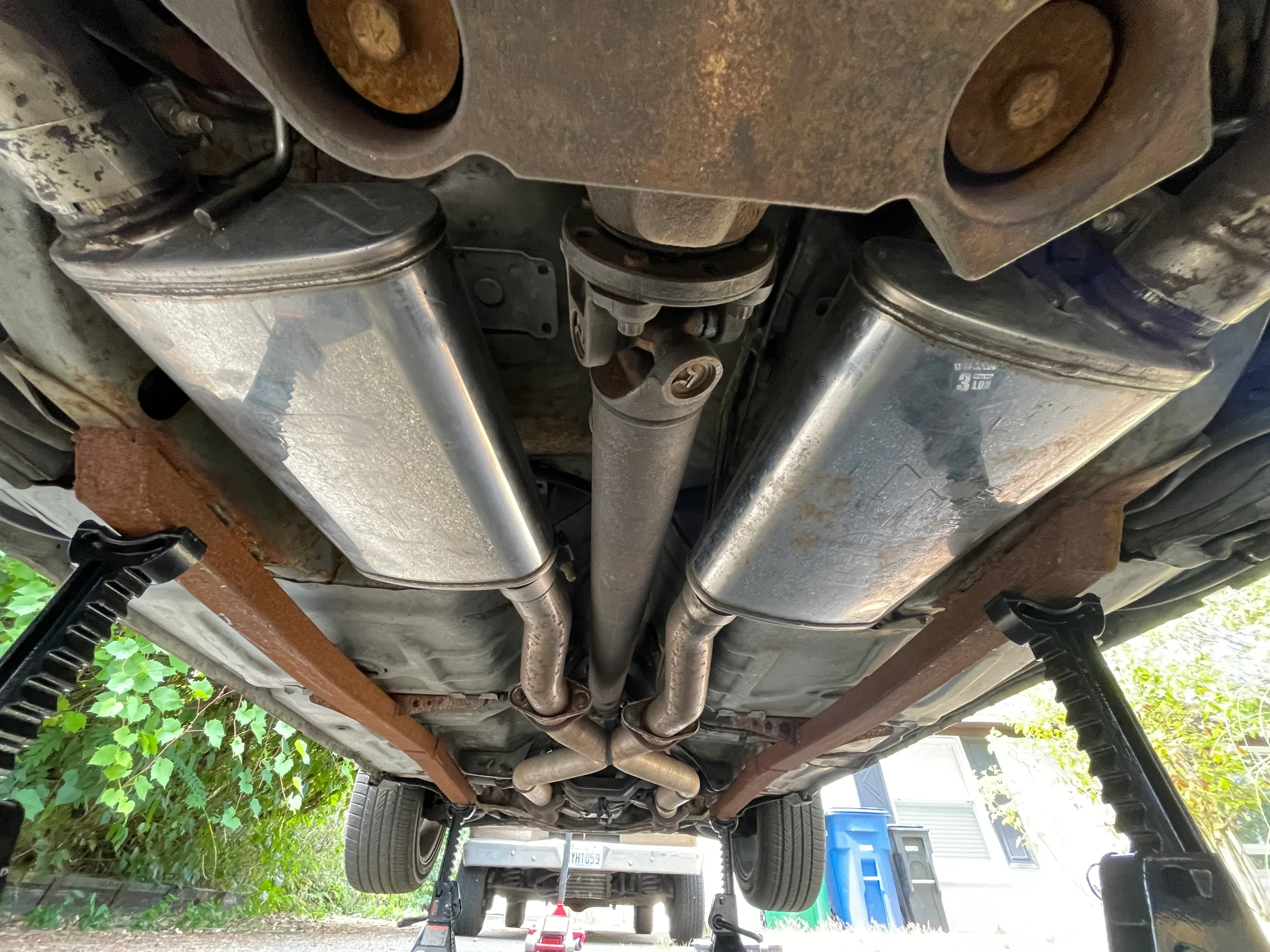

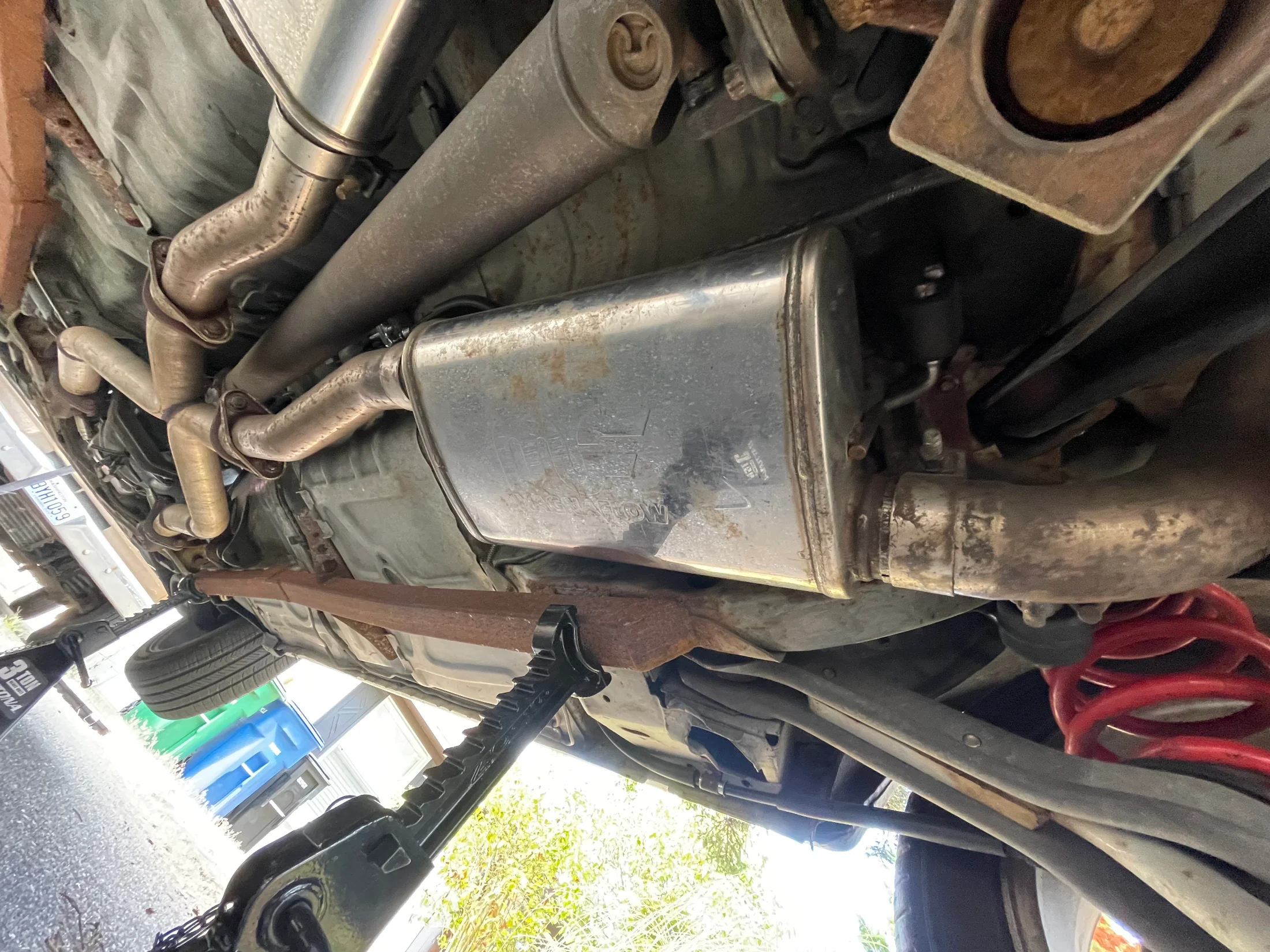

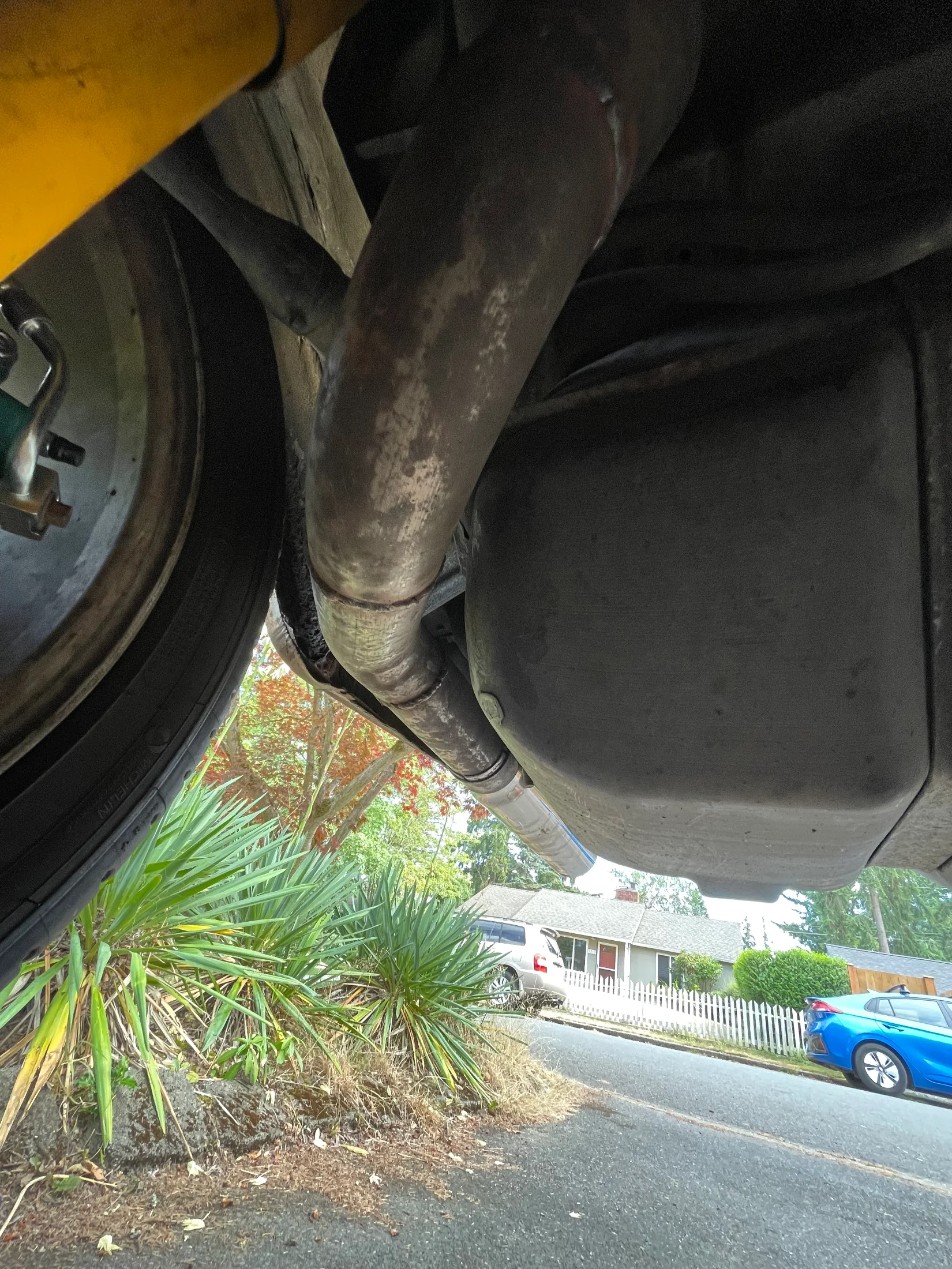

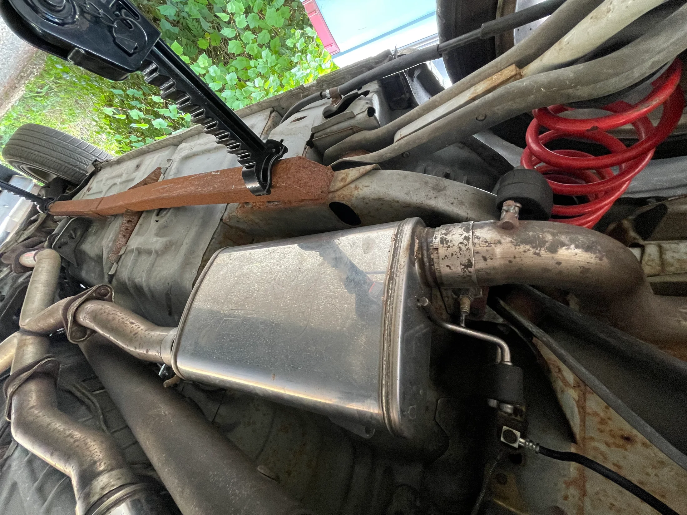

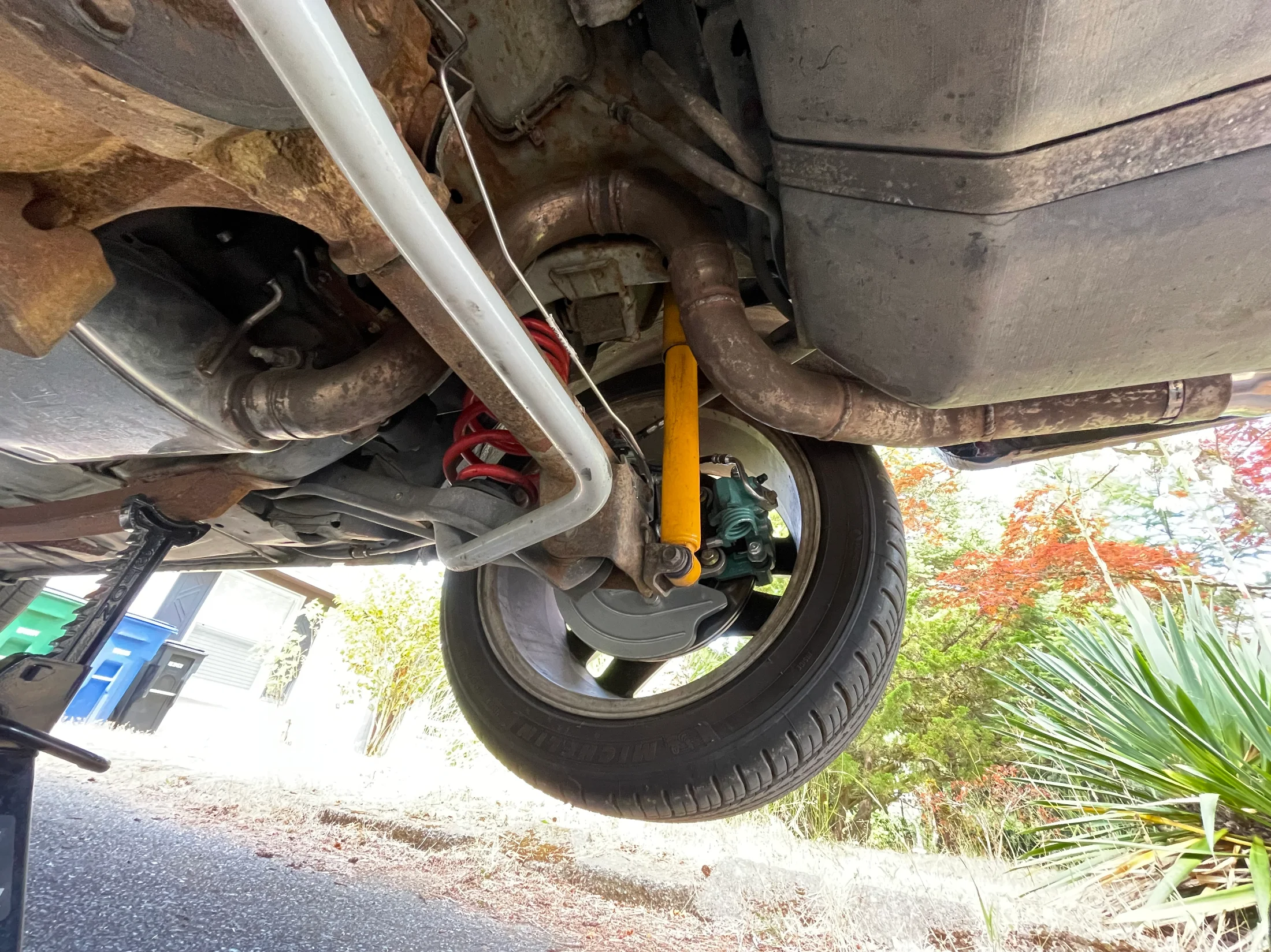

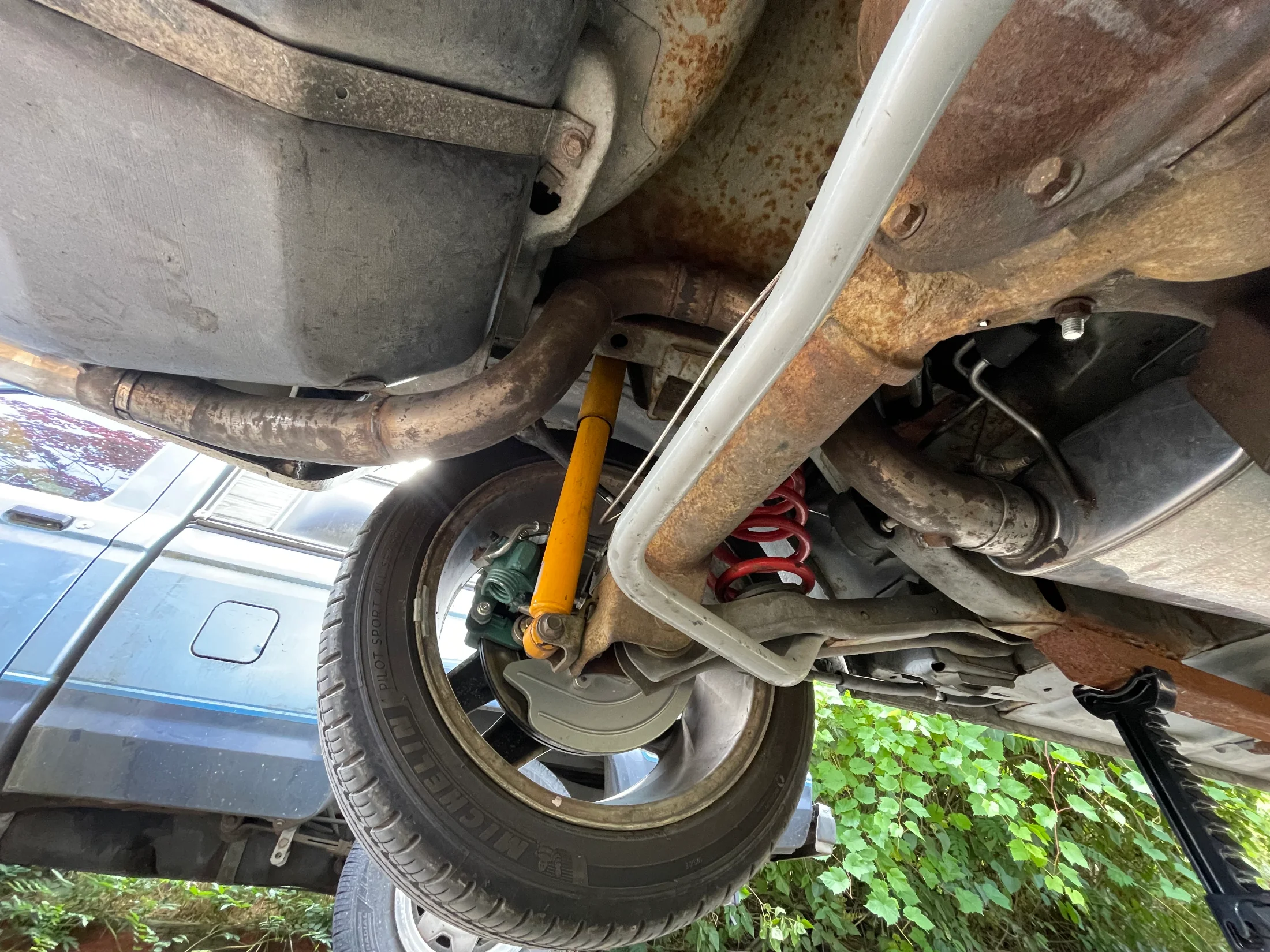

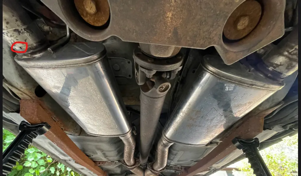

My catback was interfering with my rear sway bar when going over bumps and stuff (I have a Magnaflow system and it seems like this is a common issue with these) and so I cut it up and welded it for better clearance. The exhaust clears everything great now but in doing so it seems like I changed some of the acoustics.
I now get some nasty constructive interference at roughly 1800-2000 RPM that almost sounds like I dropped a cylinder or something, like a wavy, chopping/chugging sort of thing. Really sucks when I'm on the freeway since I'm sitting at that RPM range right at 75 MPH. Every other RPM is fine.
Anyone know how to smooth out the sound back to how it was originally?
I think the drivers side has a slightly longer tube after the mufflers.

I've never seen the exhaust welded a second time under the frame right behind the muffler.
Could just be a vibration from that.
I'd say i've never heard of such a thing as the sway bar hitting the exhaust, but when i looked back, i posted in a thread about it, so did karthief, lol.
Reactions: General karthief
in that last pic, are you positive it isn't hitting the rear frame rail as it vibrates?
I don't think so, the tube is held in there pretty good and I've had it hit the frame rail before and it's more of a clunk. For any of you musicians out there that have tuned instruments before, its like the "beat" of two pitches that are close to each other but not quite the same.
This isn't a open hole to the exhaust is it?
No, the ends are slip fit so they have slits cut in them for expansion. That gap you are seeing has a second tube underneath it that extends out of the muffler. I haven't seen any evidence of leaks but I may try clocking the exhaust clamps to see if that closes up anything I can't find.
Also hard to see in the pictures but the mufflers themselves do have some minor dents and stuff from me banging on them with a mallet when I was trying to take all this stuff apart. That could be a factor too.
The Steeda rear sway bar I've got is much bigger than the stock one, I never had any issues with the stock sway bar. Yet another example of creating problems for myself by doing upgrades... :doh:
Are you talking about the weld that is on the bend going over the axle tube?
I'm referring to the one that is near the spring in picture two.
Maybe you know this, but also, to troubleshoot what is causing the noise (which i think it a vibration), you have to have the jackstands under the rear. The clearances change drastically when the rear is hanging.
Alright I got under the car and started shaking some stuff around and I found that two of my passenger side header primaries were slightly contacting and would rattle and buzz against each other when I would move the exhaust around. (I have BBK long tubes not sure if this a documented problem or not with these.) I was able to get them to stop rattling by loosening all the exhaust hardware to relieve stress and then retightening everything. Seems like when I was modifying my tail pipes I introduced a bending force somewhere that was just enough to make my header primaries to touch.
Noise seems to have mostly gone away now.
