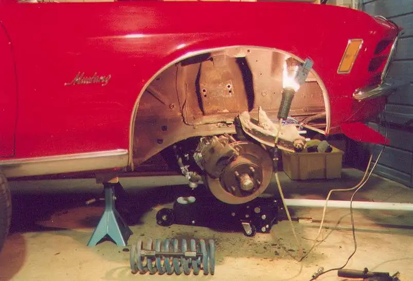

You can't beat relocating the upper arms down 1" for cost-effectiveness. You drill four holes and reassemble the car. The only cost involved is a wheel alignment, and if you are replacing suspension parts, you'll need that anyway, so the mod is free. Makes a BIG difference, and as i said, lowers the front 5/8" as a side effect. With a good spring compressor, you can have the whole job done Saturday morning before lunch, then carefully drive over for wheel alignment. Special springs etc. are really nice, but this is more than enough to satisfy the performance goals of most, and you don't even have to sacrifice ride comfort or suspension function. Holy cow, it doesn't get any better than that.
http://www.thecarsource.com/shelby/restore/lowering.html
I agree, you really need to drop the A-arms first. Not only does it drop the car ( I measured 3/4" of drop on mine) but it greatly reduces body roll. From there you can decide if you are happy with the look and feel or if an additional drop is what you want. There is absolutely no downside to dropping the A-arms. The tires wear more evenly, the car handles better and ride quality is unaffected, plus, it's free. Free is good.
Cutting a portion of the coil (don't cut the flat end or top, cut the pigtail or bottom) will give you negative camber and also affect the toe. I just cut a 1/3 of a coil from a pair of one-inch-drop 620's and the front dropped another 3/4". The alignment added -.4 degrees of negative camber with that change. I also recommend swapping out the rubber bushings in the spring perches with greased polyurethane ones. That change made a huge difference allowing the upper control arm to freely move with the bumps in the road and I think they were only about $20.
I should mention that if you have the upper control arms out you can add or remove shims from the front and rear thru-bolts of the upper arms. This will affect camber and caster. What part of your alignment is out of spec? And which specs are you using?
