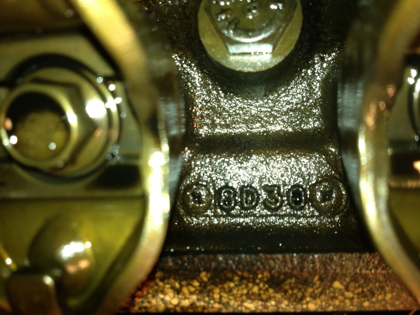

LilBerx Active Member Jan 11, 2012 340 26 29 Logan, UT Nov 10, 2012 #1 Nov 10, 2012 #1 Pulled my valve covers, and found these casting numbers on the heads... 8D30 It's an 88 GT. what head is this? I thought 87-93 5.0's come with an E7TE? Attachments image.webp 431.5 KB · Views: 249
ratio411 Founding Member Apr 21, 2002 3,870 73 109 Pensacola FL Nov 11, 2012 #2 Nov 11, 2012 #2 That is a date code, not the casting number.
ratio411 Founding Member Apr 21, 2002 3,870 73 109 Pensacola FL Nov 11, 2012 #3 Nov 11, 2012 #3 The casting number is on the bottom of the intake runners. The cylinder head has to be off the engine... unless you pull the intake and use a mirror under the head.
