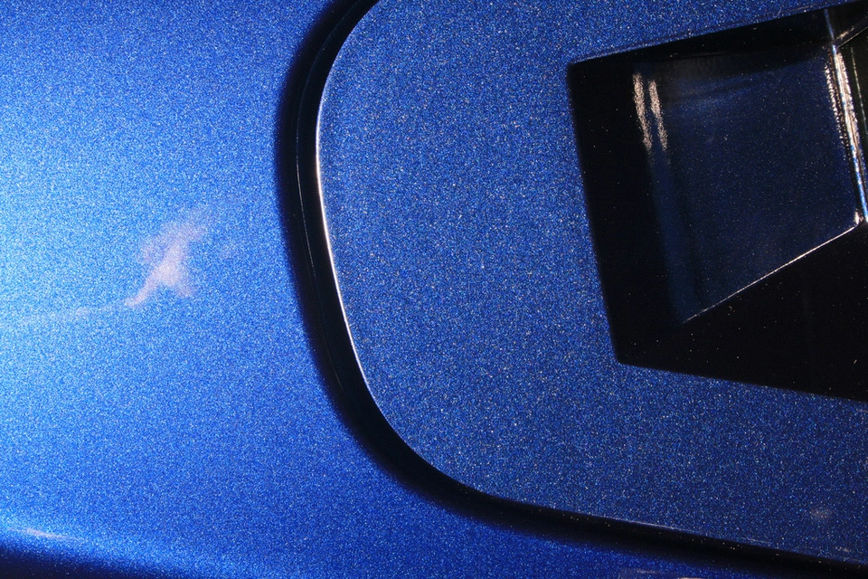

With the right light direction, the plastic to metal paint differences are easy to see on the Fox body when you look at the front fender and bumper cover! It looks as if the bumper is a few shades lighter! I haven't really noticed that on the S197s, but advances have been made in the past 17 years
Here is how well the Visa Blue from Atlanta Mustang matched Ford's right after I installed my GT500 wing!
And here is how well SHR matched it on the flush mount louvers!

on my friends legend lime 05, you can really tell the diff between the bumper and the fender. or bumper and quarter panel. i think its certain colors that really stand out when there is a difference.
i don't know if because its part of my job or what but i can pick things out so quickly on cars, that people could own the car for years and not notice, and i could see it for 3 seconds and pick every little bit out haha.
which definitely sucks, because that makes you ultra picky for your own things.
one thing also to look at, orange peel. fords newer paint seems to lay down pretty damn smooth. if you get a part with a real heavy texture to it, its going to throw it off a little bit appearance-wise.
isn't vista blue such an awesome color kool? haha, after a nice fresh bath the metallics just pop right out at you.
