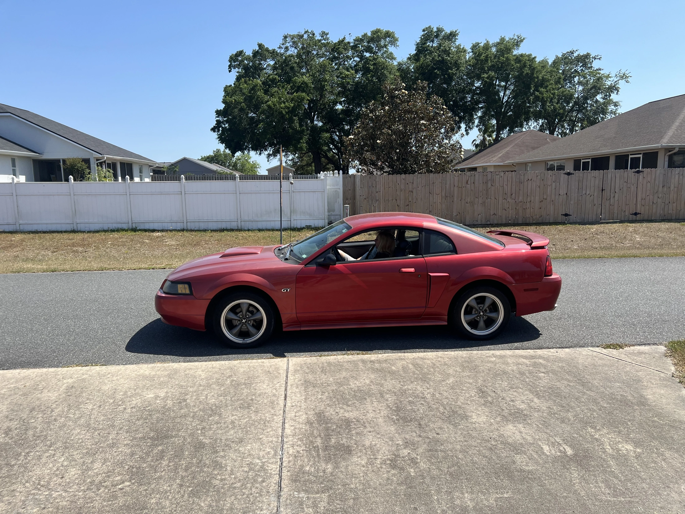

Great news. Thank you everyone for your comments. I will probably never know where the transmission knock came from, BUT, it’s gone. How? By changing out the fuel injectors, which also fixed my lousy idle, shaky motor, and no power.
You may remember the it only knocked with the clutch out. Which makes this an even crazier thing. But apparently the shaky motor was causing the knock from somewhere from behind the motor. No idea from! No idea why only with couch out!
So anyway, she purrs like a kitten, hauls ass, And ready for some cosmetic.

Anyway, all the posts and all the work ending up being the fuel injectors. So glad I stuck to my guns refusing to believe it was the throw out bearing…it made zero sense!!
