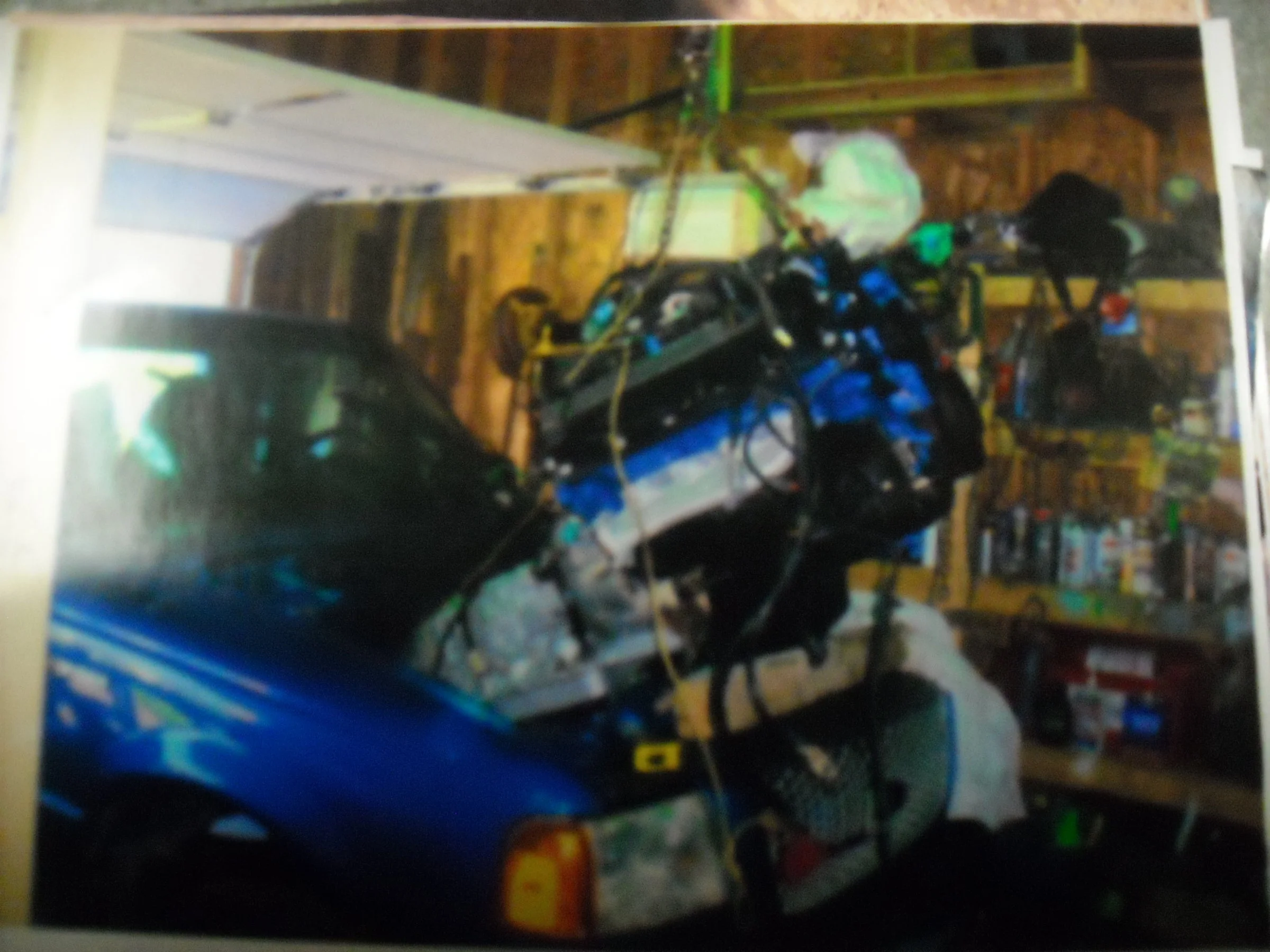

I did this a couple years ago as my daily knock around hauler, and haul it does.
2001 Ranger
4.6 / AOD / 3.73 gears
Can you say : AAAAAHHHHH !!!
Hey guys thanks for the input.
I had a build post over on the ranger station web site.
My post name is rjaaaaaa and it was project " Outrangerous"
It was a fun swap to do but it had it's moments, such as the computer electronics. I had quite a few wires hanging everywhere that had to be chased down and rewired/
all in all it went in pretty well, almost handed on the original motor mounts, made up a plate to move mounts forward 3/4", slide motor over 1.5" to clear steering issues and driver side exhaust.
Did this over the winter by myself after I retired. Bought this truck new in 01 and put 236,00 miles on it, so since I wasn't commuting 120m per day anymore I figured I could beef it up a little.
here is a link to the build, hope you find it interesting
http://www.therangerstation.com/forums/showthread.php?t=116900
I have put about 30k on it since the install and no problems.
