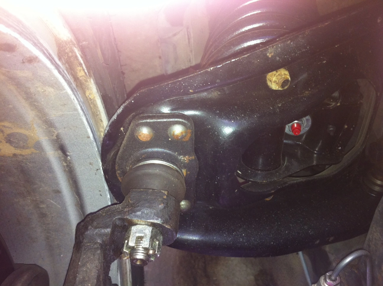

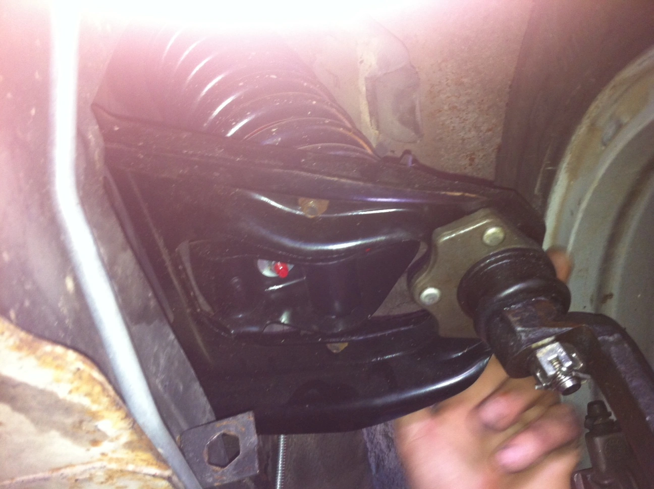

If that is the case then what do you think actually happened here? I attached photos of my control arms, notice the 3 bolt (1967-1973) control arm and the corresponding item from DM's website. Then below it is the offending 4 bolt control arm with the corresponding link from DM's website that says it belongs to a 65-66. Could someone have installed the wrong bushings on the control arm therefore making the bolts fit, but the actual length of the arm wrong?
http://www.dallasmustang.com/mustan...-1967-1973-UPPER-WITH-3-BOLT-BALL-JOINT/19848
http://www.dallasmustang.com/mustang-parts/product/CONTROL-ARM-ASSEMBLY-1965-1966-UPPER-4-BOLT/7168
