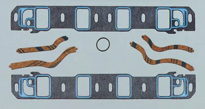

ozanracing New Member Nov 28, 2006 172 0 0 Jan 31, 2007 #25 Jan 31, 2007 #25 Well I just pulled a head off today. Backwards. Ordered some felpro graphite hg's and some 1262 intake gaskets. Do you guys use the cork seals that go from one head to the other, or just use rtv sealer? Attachments fpp-20-1262.webp 15.3 KB · Views: 142
S superhuaman New Member Nov 8, 2004 907 0 0 Harrisburg, PA Jan 31, 2007 #26 Jan 31, 2007 #26 black rtv
