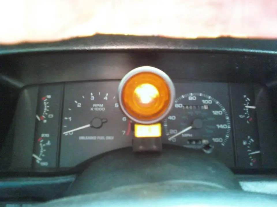

why does my speedo say 160 MPH and certified calibrated then
