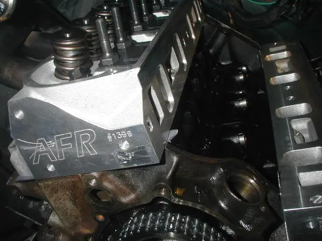

Ok I finally got all the rockers adjusted as per the general requirements i.e lifter preload, torque value etc..
I put the timing cover and water pump back on with new gaskets, RTV, and anti seize on the bolts this time ( i learned my lesson, broken bolts are teh w1n).
Now i want to bolt the headers up to the heads. This is a b1tch, the AFR heads are so hard to align perfectly with the headers. I dont know if its just me but the threaded holes in the heads wont let the bolt start unless its perfectly perpendicular. Long tubes are being blocked by the H pipe which i unbolted from them. Its still not working, dammit!!! Anyone have any tricks?
Anyway when thats done ill just bolt on the lower manifold and then the AC and PS brackets. Wish me luck!!!

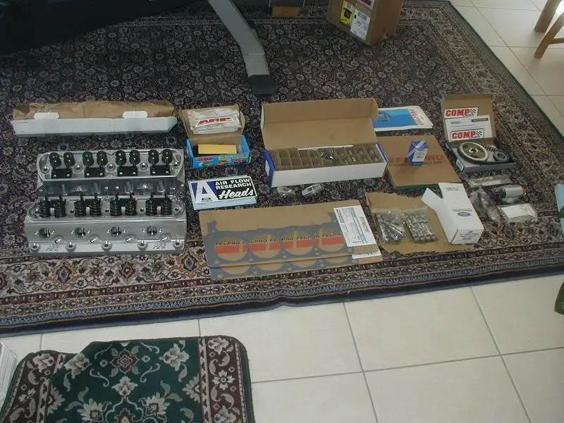

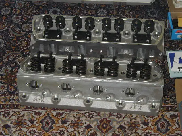

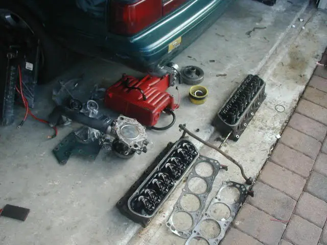

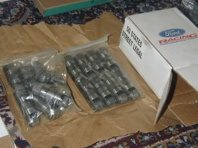

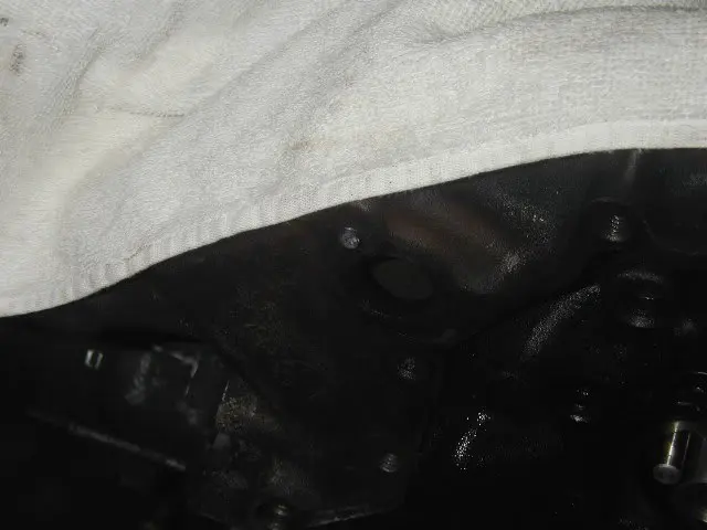

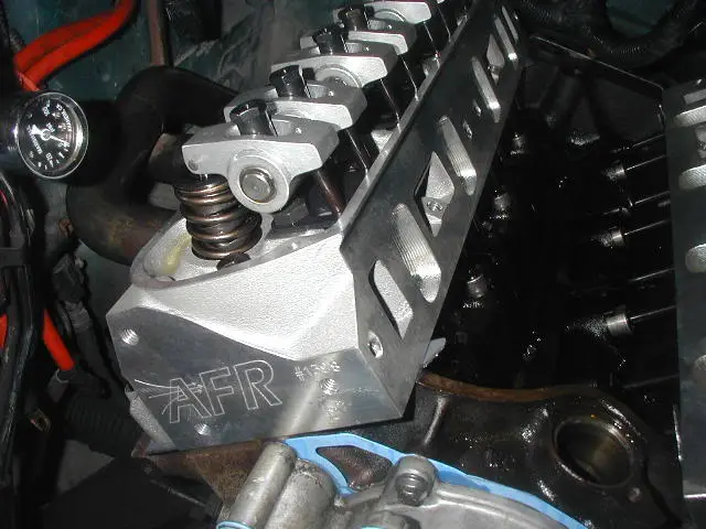

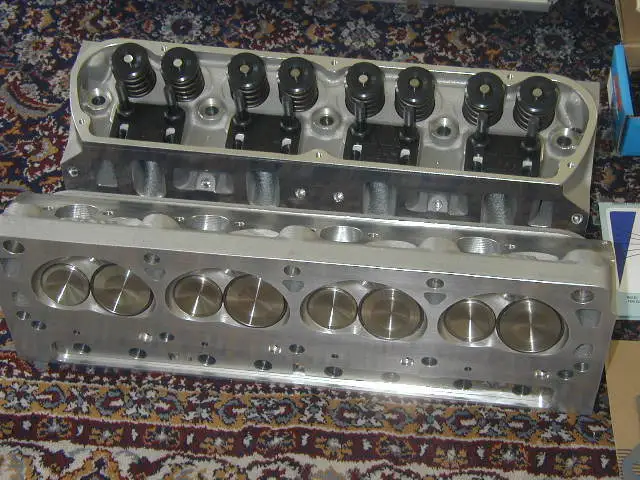

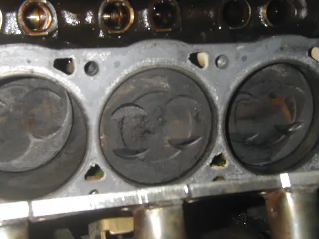

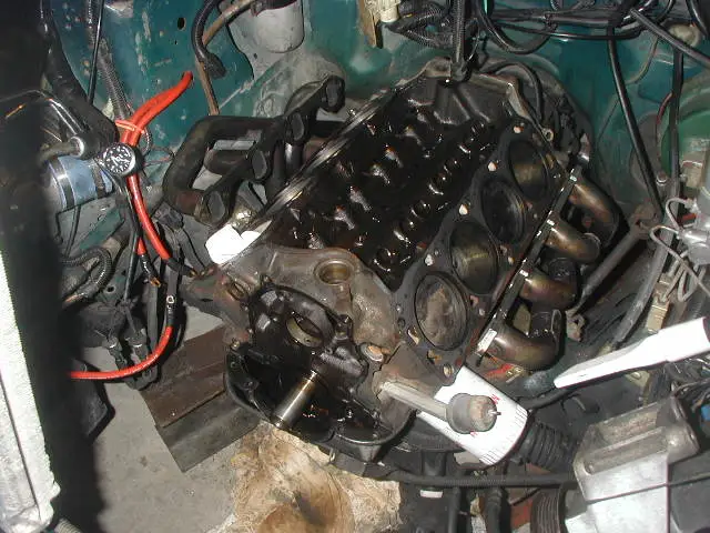

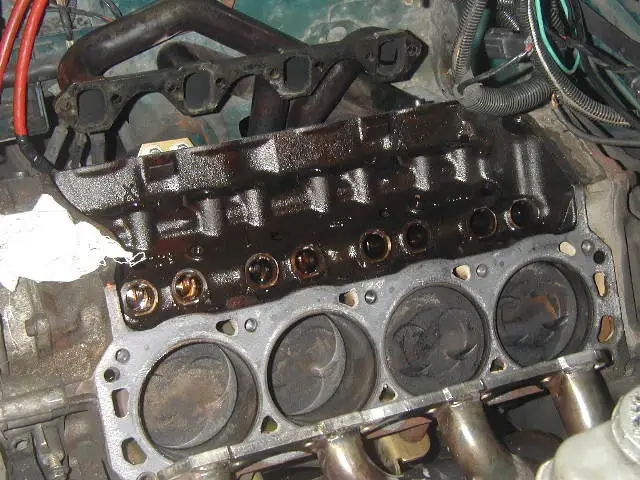

Picture time.
This was last week.
Notice the broken bolt in the block, Awesome!

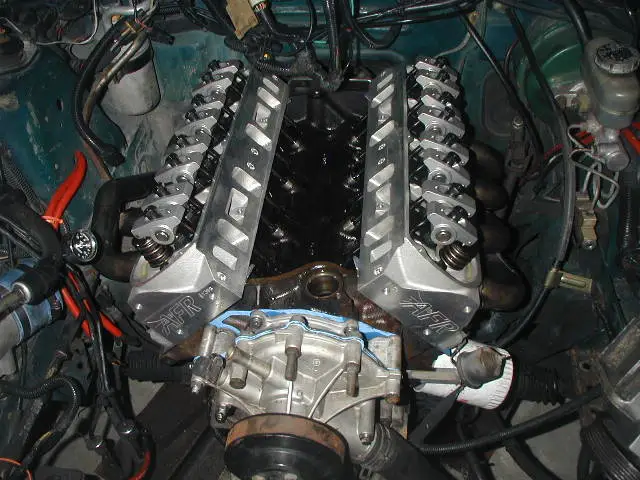

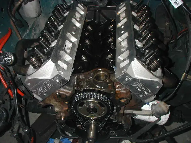

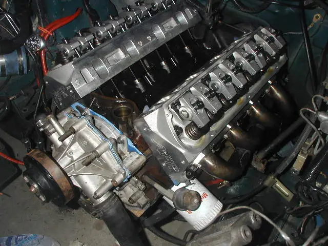

Dbeck002
Apr 30, 2005
710
South florida
Sep 2, 2005
  • Sep 2, 2005
This was the past 2 days.
Heads are torqued down.
Rockers are adjusted.
