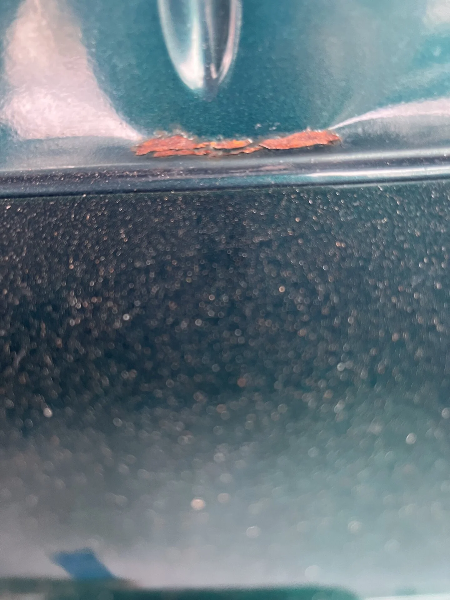

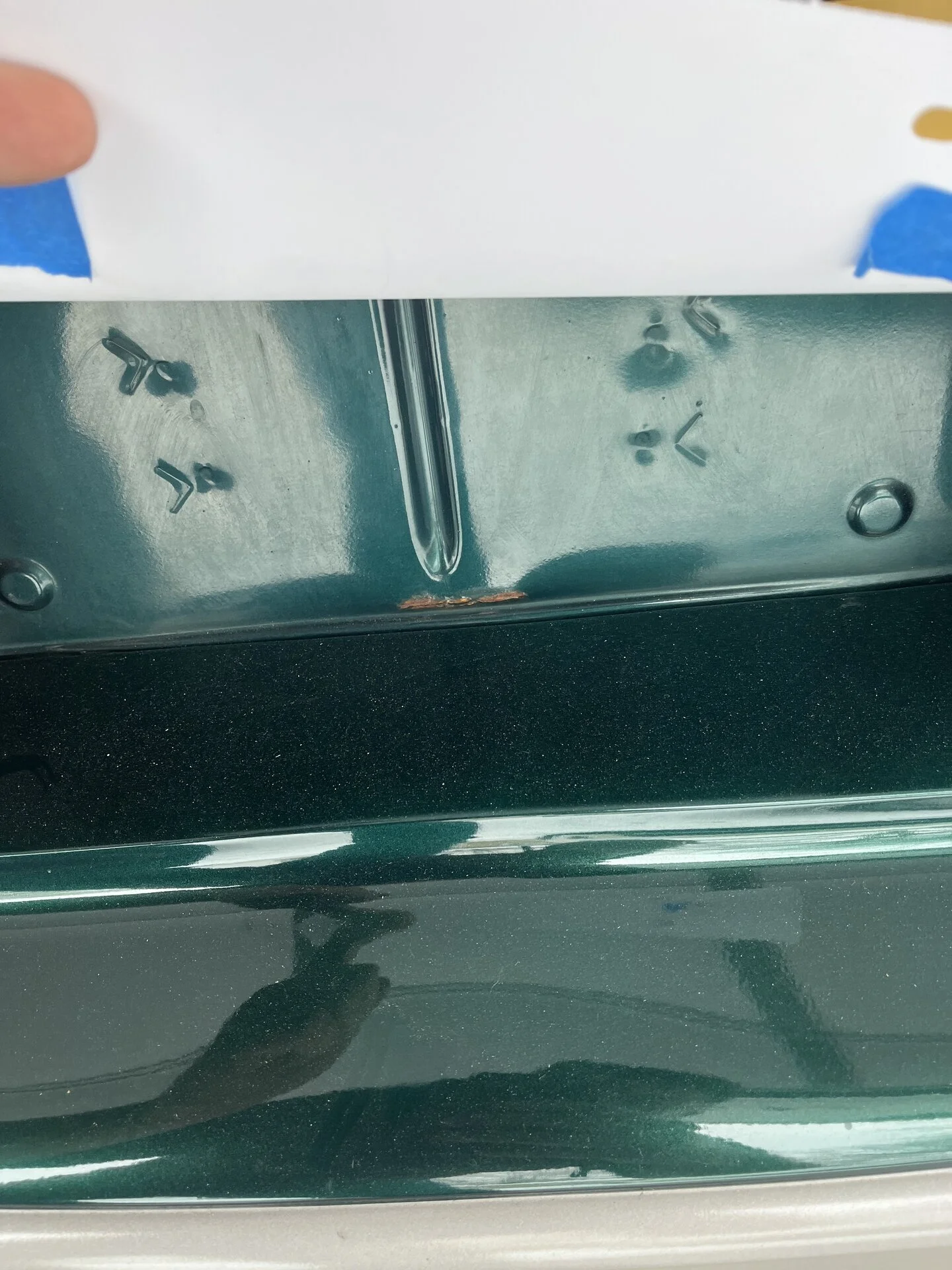

I have a small rust spot behind my license plate area. Looks like the plate rubbed the car. I have matching touch up paint. Looking for suggestions on removing/naturalizing the rust without having to do a major job. Something that’ll remove it and protect it, even two different products is fine. Thanks for your help.

What's it look like on the other side?

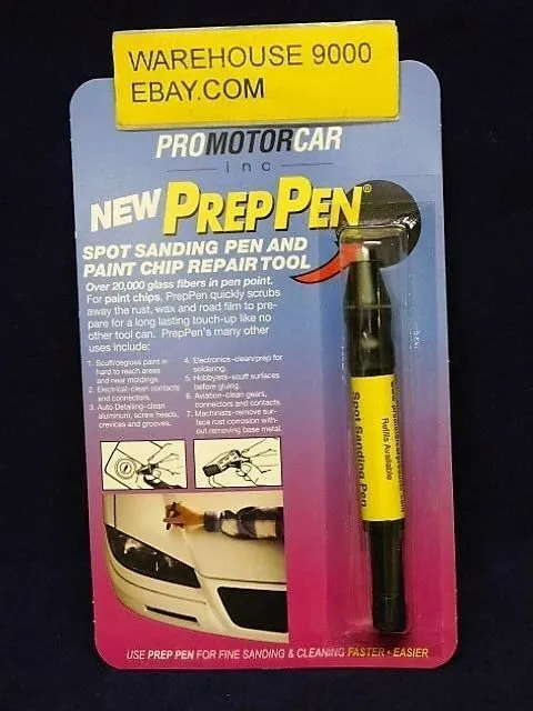

budget way ~ Fiberglass rods on tip of pen to scratch small spot clean.

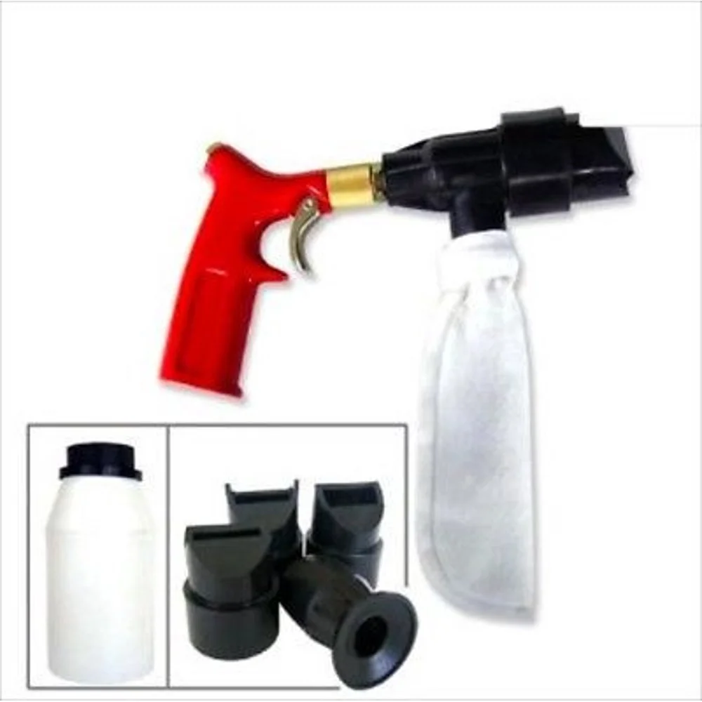

And the spot sand blaster gun with tips you hold against car and catch / recycle your medium.
Probably not using your touch up pen after this though.

like nothing. it's just surface rust.
Started on it today. It cleaned up just fine. Looks like it was a small scratch or maybe wear spot from the plate. Letting the primer set up before paint.
