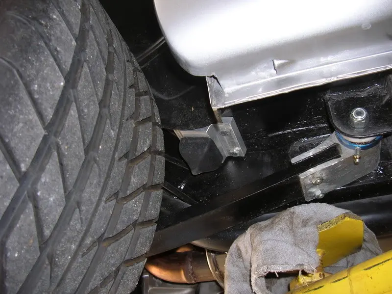

250lb springs. That sounds heavy but Flex-a-Form must measure the rate differently. They do not feel stiff. How much power? It's a "mild" Genesis aluminum sideoiler 482FE, 500HP/525Tq going through a TKO600. Tires are BFG KDWs 275/40/17.
Crappy picture of the upper mount, I just slid under there to take it. I will get better pics next time it is on the lift.

Thanks for the information. Would love a better picture of the body side of the mount when you get a chance. I'm assuming there is a bracket or something that you made that is welded to the frame there for extra strength?
I'm looking for rear suspension ideas for my 70 with a 03 Cobra motor with 500rwhp/500rwtq going through a T56. I'm going to be running a slightly larger (295 or 315) and more sticky tire (drag radial) on the rear. So I might have more chance for wheel hop.

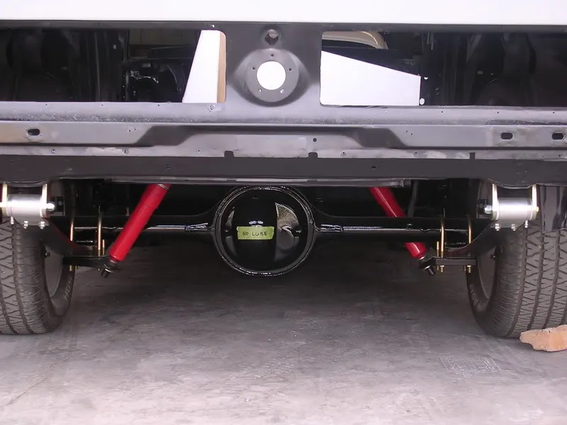

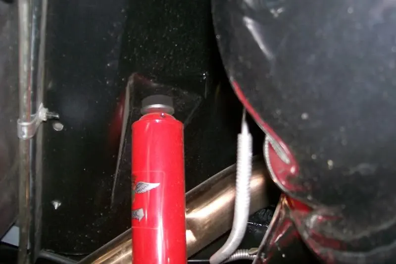

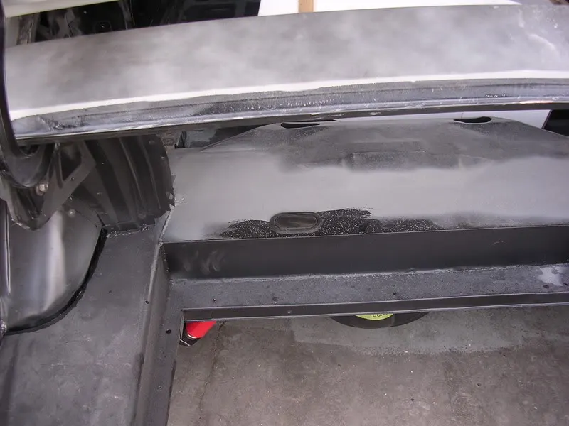

Here's some pics of an original mount and a link to a guy who makes reproductions:
stagger
I didn't use his parts but it looks similar. My upper panel doesn't have the tabs on the edges, it's welded directly to the trunk floor/sides for a more seamless look and the lower panel is not two piece since I didn't have to worry about frame variation. Also the hole in my lower panel is smaller and welded to the upper panel shock mount.

Wow, great information! Thanks. Did you just use a stock shock mount from the front side welded on the back side for the actual mount?
SNAKEPILOT
Jul 8, 2005
112
Mar 9, 2009
#33
  • Mar 9, 2009
  • #33
Chappy, it's all custom fabricated. Check out this link:
