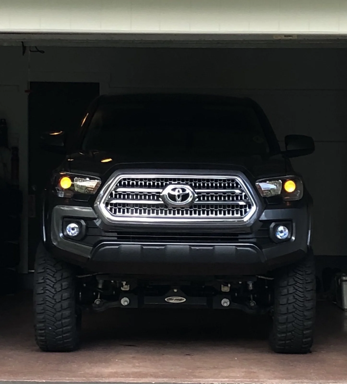

I wired demon eyes in thru a relay and to a separate switch located cleanly inside at the owners preferred location.
the led’s do NOT like the heat of the projector. Running the demon eyes with the projector on at the same time, will prematurely kill the leds. So, put a manual switch to it.
