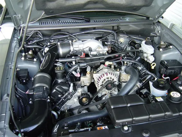

its great I have it on my car & got one for my Dads GT along with the C&L intake & Roush T body
his car

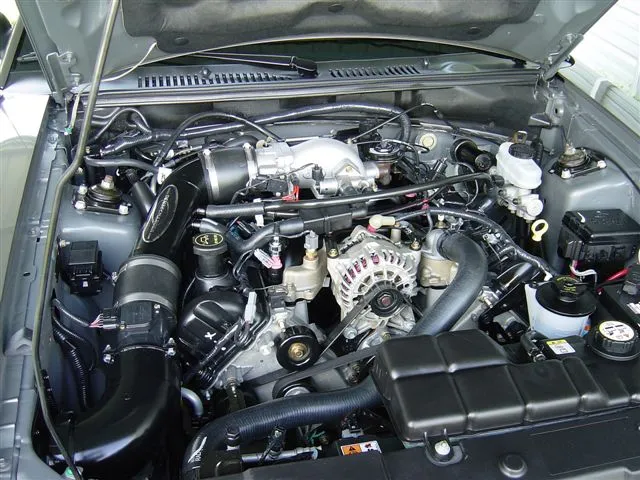

my car
