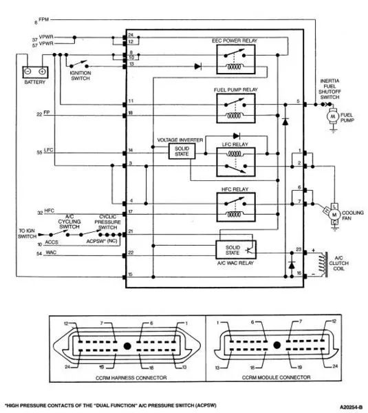

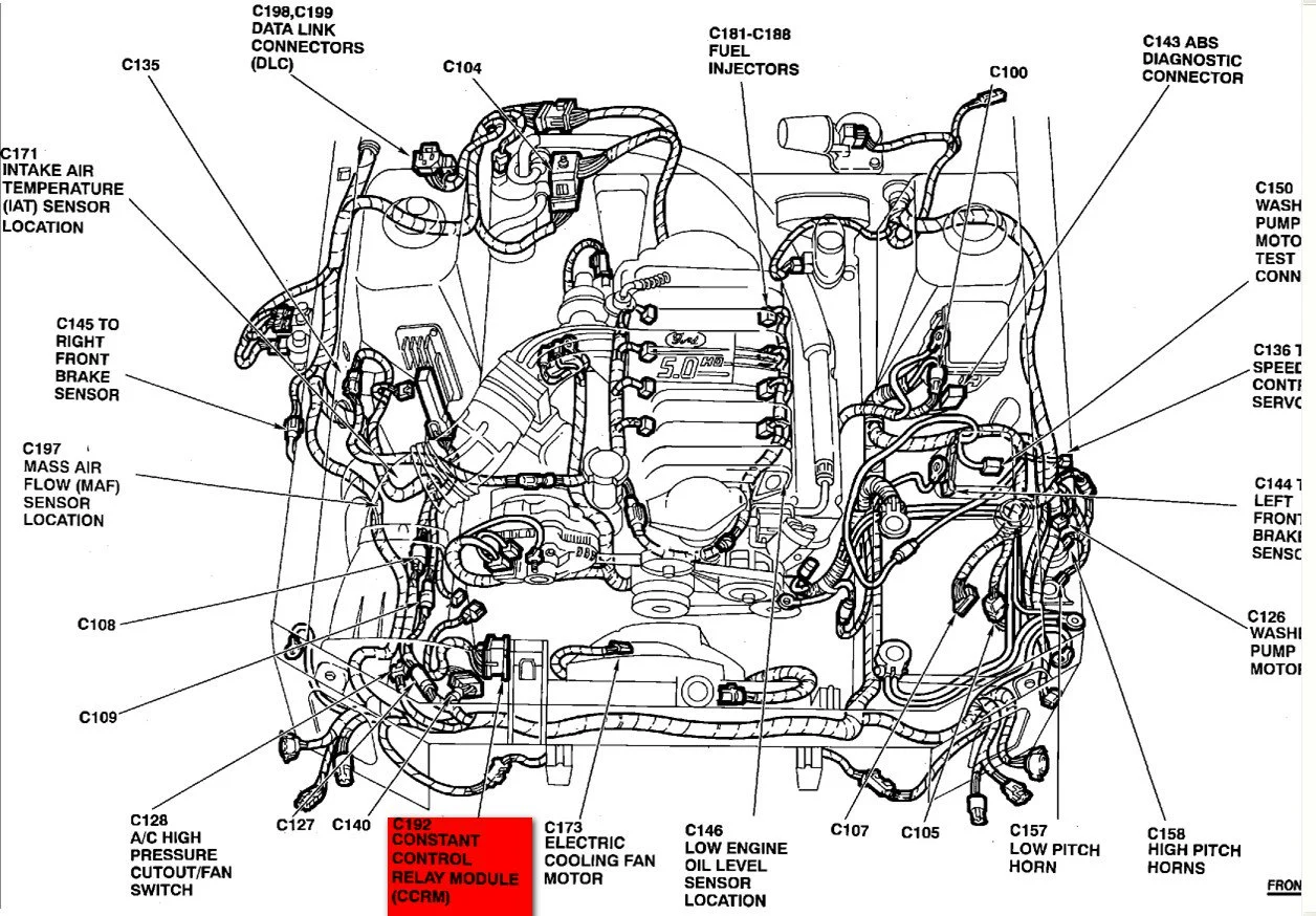

CCRM relays - all CCRM relays are located under the hood
CCRM location
Diagram courtesy of http://ww2.justanswer.com
Click on diagram to enlarge it
CCRM Diagram
Diagram courtesy of http://diagrams.hissind.com/

So I been thru the check list.
Battery 14.3v
Fuel pump fuse 14.3v
Power into ccrm 14.3v
Power out of ccrm 10.2
So before I move further I need to know why the ccrm to fuel pump voltage drops below 12v. I've replaced with 3 brand new ccrm. Surely they can't all be bad right out of the box. Any thoughts?

Measure the voltage between pins 11 and 5. Put one voltmeter lead on pin 11 and the other on pin 5. Check the voltage; you should see full battery voltage across the two pins. Then turn the ignition switch to Run and check the voltage again. More than 0.25 volt is a bad connection inside the CCM or a bad fuel pump relay in the CCM or problems with the wiring between the CCRM and the computer..
