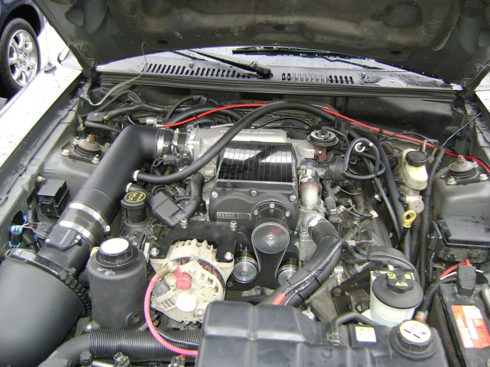

did i ever show you guys this??
04GTMustang
Feb 28, 2006
348
Stafford
hmmmmm i wonder what that red line is for going into my intake system???:rolleyes::D
yea thats the kenne bell intake system. ill eventually get a nicer one but i wanna get that new kb manifold that modular powerhouse put out so its not worth buying a new one until i get that.
but yea the meth is sweet. helps with the positive displacement blowers a good deal up top with cooling that air charge.
im confused. have u always had meth? i been debatin on gettin a kit. did u have the blower b4 the meth kit, if so how has it changed it.
i have had meth for about a month now. i think the car runs awesome on meth especially on the 11psi pulley. pulls very hard up top from the cooler air charge. and yea i got the blower before the meth kit. I just felt the difference really on the top end cause its not tuned up yet and advanced timing. but up top i def. felt the difference because before you could definitely tell at the top of 3rd gear that heat was getting to it and now its not a problem at all. I mainly got the meth though for the detonation protection instead of really making more power.

Now you are the first person I know with meth on a positive displacement supercharger. Others have told me it doesn't do anything for PD S/Cs :shrug:
How much does it cost to fill? How long does it last? Do you run it all the time? What size tank do you have? Does it vary the flow by throttle or is it on/off set at a certain point?

it runs off maf voltage. i think i have it set to start spraying at 10% at like 3 volts or something like that. which is just over 3000 rpms. or once i get into it it comes on. cost can be cheap depending on where you get the meth from. but the snow perf. stuff is 30 bucks for 4 gallons. I have mine tapped directly into my windshield washer container and usually just my windshield washer container can last a few weeks depending on how hard i am being on the car.
but to make it last even longer i am going to install an on/off switch so it wont come on at all. I have seen a few cobra guys around my area with meth and they love it.
I got it though cause this spring im gonna put the 14psi pulley on add some race gas and see how she does on a stock motor lol. I wanna see how fast this baby will go on the stock internals could blow could live. who knows:shrug:lol
