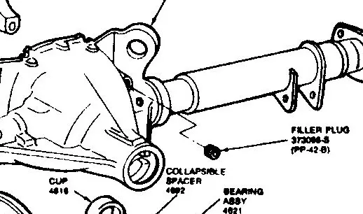

Diff Oil level check
Front, driver's side of the housing, above the reinforcing web. It accepts the end of a 3/8" drive extension so you can remove it.

A word of advice. Before you try to take it out make sure that you clean the hole that the 3/8" drive goes in . It usually gets filled up with gunk and if you don't clean it out you can easy bust your knuckles on the underside of the car. And mine was really tight.
Wise advice here. Most extensions these days are wobbles, and they suck for this application. Also, wear mechanics gloves, as more than one fellow stanger has ripped a nice chunk out of his hand when that plug lets go.
+1 for mechanics gloves. I never thought I needed gloves, but after getting a pair I can see the many uses for them. They protect from heat and that almighty slipping of the wrench.
