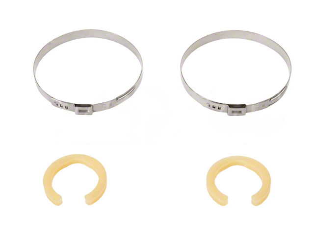

This should be all you need. Steering rack stops. $11.95.
Get Yours
Get Yours

Are those just steering rack limiters?

Yes. If your Mustang came with 18 inch or 19 inch wheels from the factory you don't need these.

Yea, I remember seeing the plastic clips on the inner tie rods of the stock steering gear now that you mention it. I assumed all gears came like that. I remember they wrap around the inner tie rod where it screws in to the rack? Shouldn't be difficult to put on with the right grease involved (not to mention it comes with new c clamps for the boots) and steering centered. More work to jack up the car and get access really.
