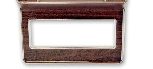

Has anyone installed a DIN size stereo into a 1969 using the aftermarket CD Dash Bezel available from the vendors? I'd like to know how the stereo is supported - is there room for a sleeve, does the bezel hold it up in the front?

http://mustangsunlimited.com/ProdImages/AB69W-C.jpg
I have the black version of this bezel, and I have to say that it is without a doubt one of the cheapest, most flimsy pieces of crap I've ever purchased.
I had to glue in wood to the bottom portion below the radio to stiffen it up to the point where it would support a radio.
In hindsight, I think that the standard reproduction bezels you can buy for $25 new from any of the Mustang vendors are FAR better!! If I had it to do over, I'd probably get one of those and modify it to work!

Maybe someone else makes a reasonably priced single DIN bezel that is worth getting, but I haven't found them yet . . .
I got mine from a different vendor than MU. It was around a hundred bux when I bought it. Mine came with a cage to hold the radio, and has worked fine so far. I want to say I got if from mustangs plus, but I just looked at their page, and they don't show the same one I bought.

I was afraid that that bezel would be a POS. I have a repo or the original that I was thinking of cutting, but I've been hearing some good things about the Retrosound Model One shaft style radio which would fit perfectly. I may go with that.

I have the JME piece and it works great. Highly recommend. Yes, it's pricey but no issues to deal with.
yeah, i would rather pay the big bucks for the JME bezel than pay 100 bucks for that thin flimsy abs plastic POS the other places sell. i just wish that someone would make something more like the original plastic piece with the chrome plating on the raised perimiter and the correct sharp edges rather than the rounded edges of the $100 pieces. i would buy one of those in a heartbeat, but until someone does make something like that i'd rather use the JME bezel.
