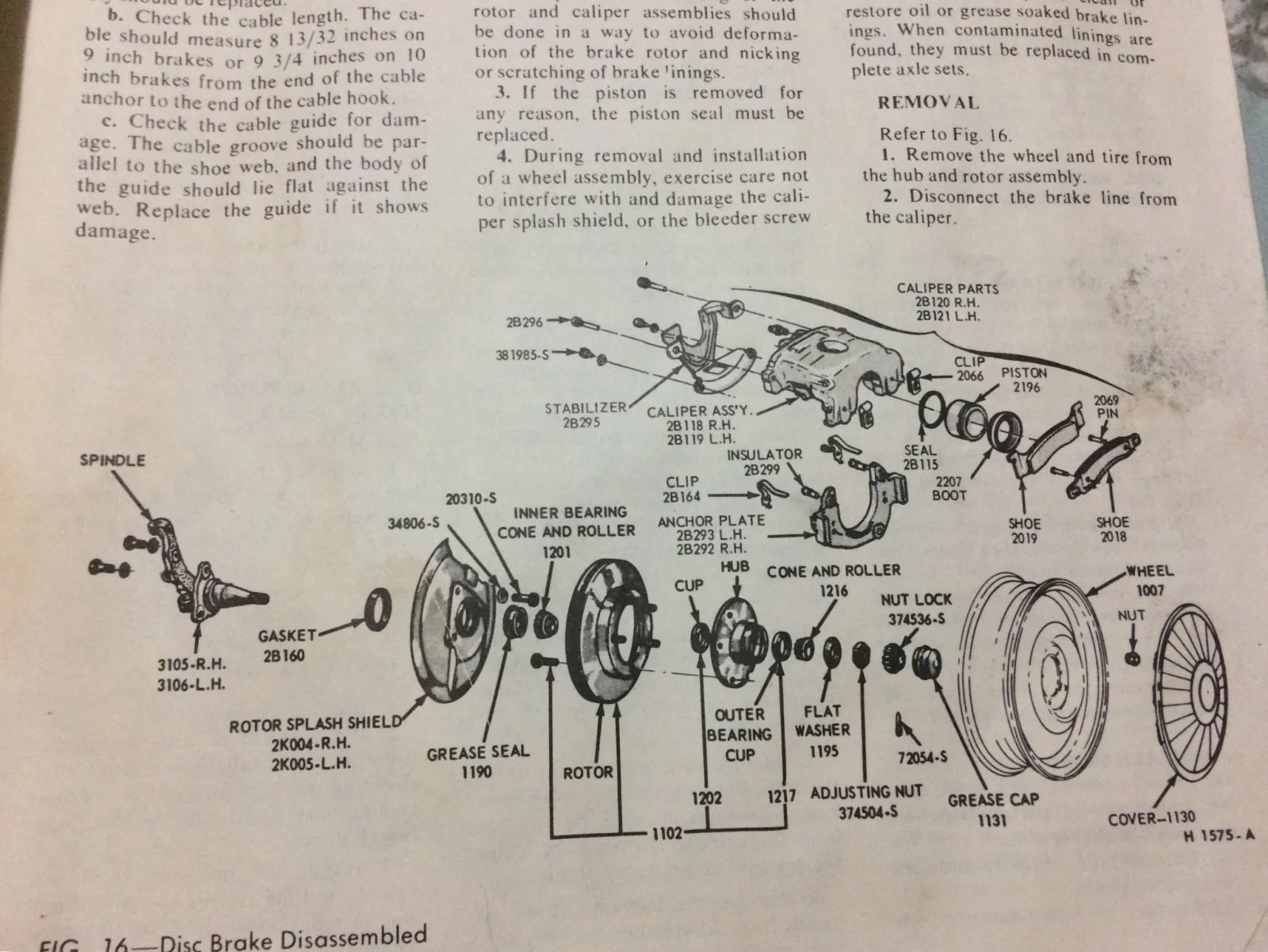

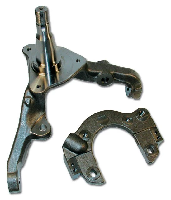

R rustaddict Active Member Aug 23, 2014 218 55 38 May 24, 2019 #4 May 24, 2019 #4 The diagram shows what I’m talking about as an anchor plate. The other pic shows the bracket separate from the caliper Attachments 85361DEC-C4D7-4F0F-BB4A-9E893ABB31D8.webp 189 KB · Views: 243 1531888D-1BED-45B0-B12F-3F002D39E143.webp 33.7 KB · Views: 238
