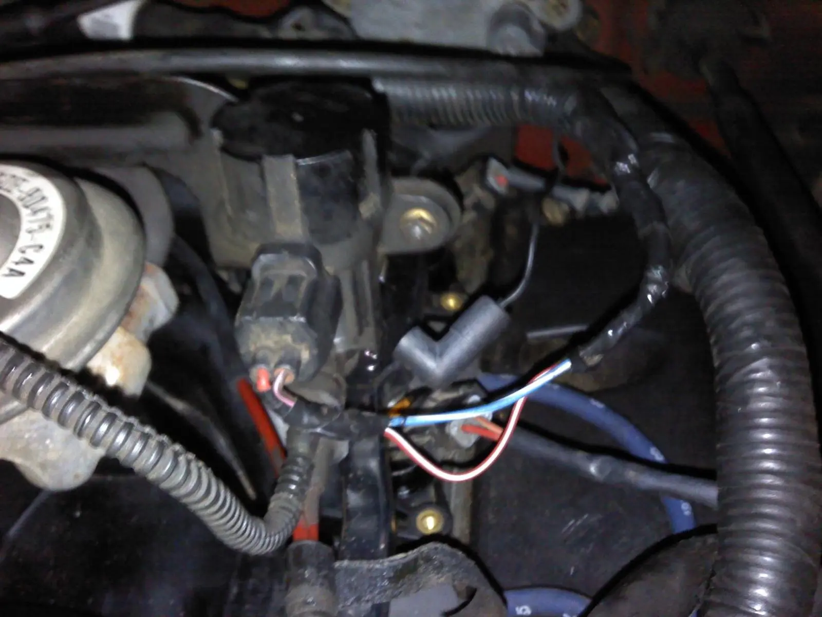

shaunspengler Member Mar 29, 2011 51 1 8 west covina Apr 24, 2011 #1 Apr 24, 2011 #1 i have a little black wire and cant figure out where it goes can anyone show me a pic? Attachments 0424111650-00.webp 70.1 KB · Views: 125
trinity_gt 10 Year Member Jan 31, 2003 3,125 81 99 Canada Apr 24, 2011 #2 Apr 24, 2011 #2 Looks like a ground terminal. Is there an extended stud within reach of the plug?
Ares Founding Member Feb 4, 2002 720 0 16 Pittsburgh, PA Apr 24, 2011 #3 Apr 24, 2011 #3 Ground wire, look on the end if fuel rail where it bolts to intake. The plug should go on stud.
shaunspengler Member Mar 29, 2011 51 1 8 west covina Apr 24, 2011 #4 Apr 24, 2011 #4 is it important like if i put it on a bolt that it fits is it ok?
shaunspengler Member Mar 29, 2011 51 1 8 west covina Apr 24, 2011 #5 Apr 24, 2011 #5 can someone take a pic real quick?
I ItsStock02 Member Aug 18, 2008 492 4 19 Westland, MI Apr 24, 2011 #6 Apr 24, 2011 #6 as long as its connected to something metal you'll be alright.

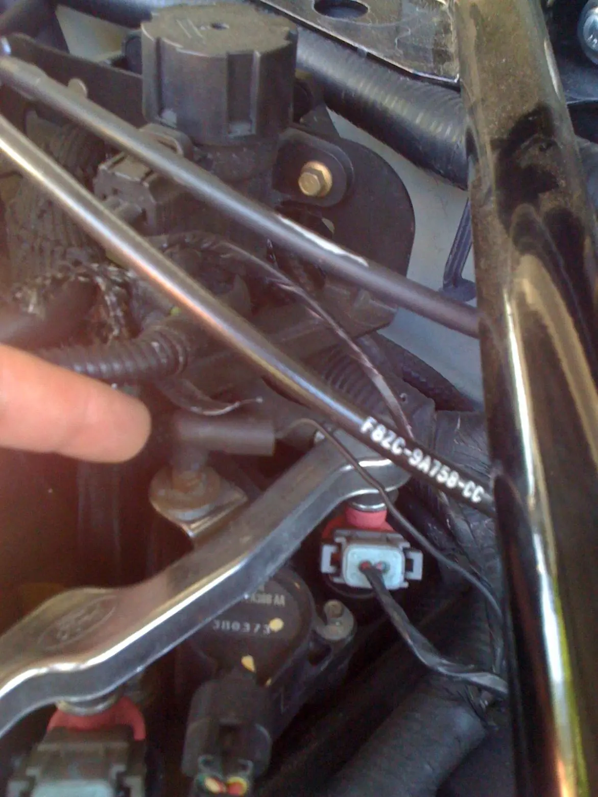

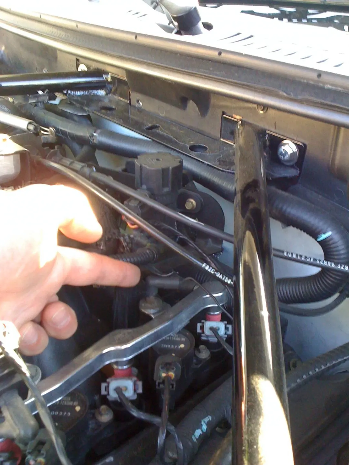

jjFORDmustangGT New Member Apr 21, 2011 6 0 0 Tampa FL Apr 25, 2011 #7 Apr 25, 2011 #7 Ares said: Ground wire, look on the end if fuel rail where it bolts to intake. The plug should go on stud. Click to expand... Here is your quick pics, location is as stated by Ares: Attachments Fuel Rail pic.webp 92.3 KB · Views: 131 Fuel Rail pic2.webp 87.7 KB · Views: 154
shaunspengler Member Mar 29, 2011 51 1 8 west covina Apr 25, 2011 #8 Apr 25, 2011 #8 thats were i put it and thank you so much for the pic you guys are great
