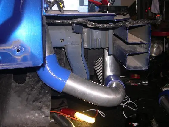

i ran that setup with the mini race for about 6 months. i did have to move the recirculating pipe closer to the blower to prevent backwash. i am now running a Tial BOV and a blow thru MAF so i can vent to the atmosphere

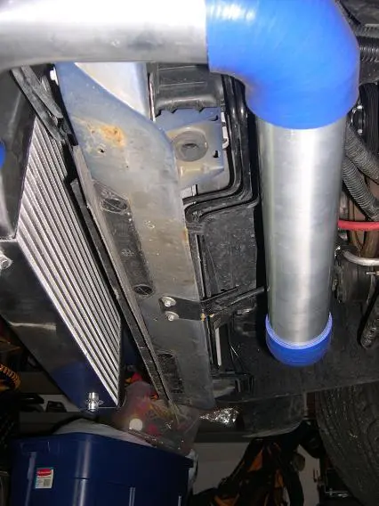

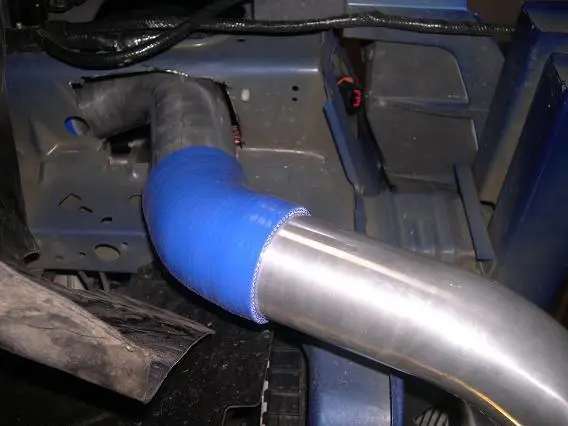

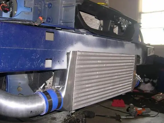

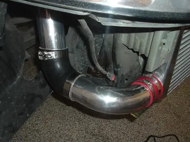

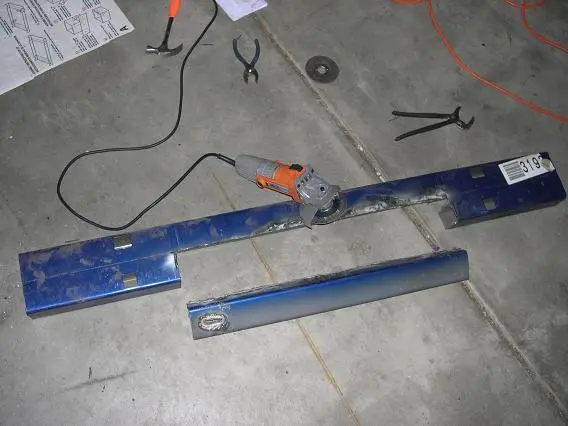

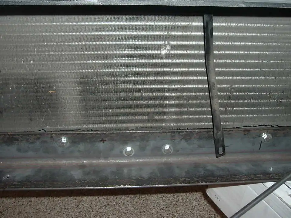

Here is my set up. I used a piece of angled iron to bolt up the IC. I just bolted the angled piece to my radiator support bracket. Way less work compared to cutting the metal bumper. The IC gets plenty of air as well. It was 100^ + out side and I logged 90^ IAT.
