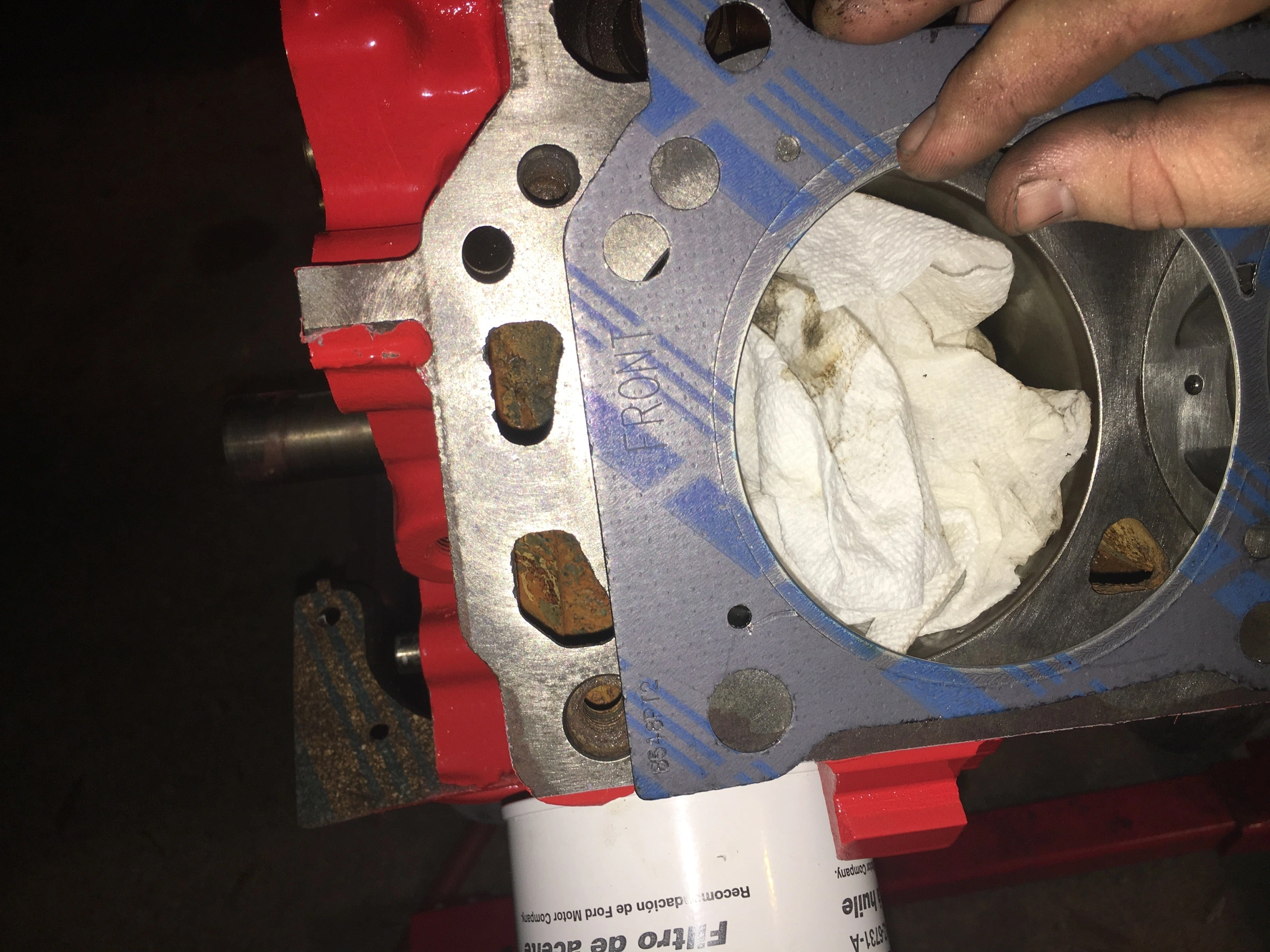

I was panting up the block and a bunch of other parts and I was checking the head gasket. I noticed that the gasket blocks off two of the water holes on the front of the block. Both gaskets do this on either side.
I'm assuming this is an issue?
Ok so after looking around, this is actually normal. Since the water pump is in the front, the holes in the gasket get larger towards the back to make sure the water pressures stays good and the water actually flows. Learn something new everyday .
