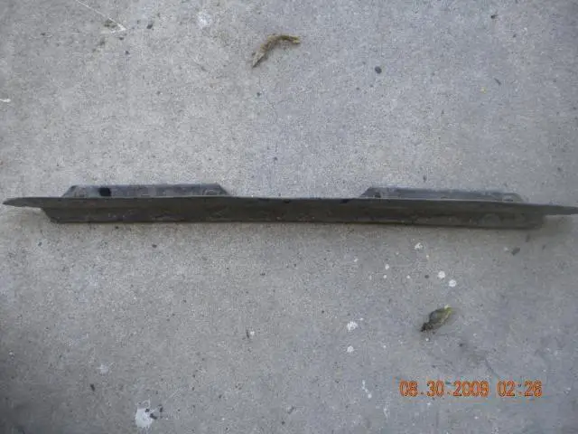

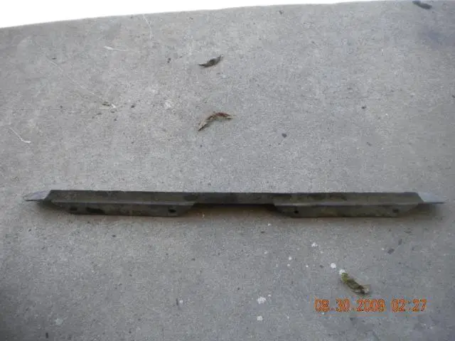

found the plastic air deflector at the JY today,$3.50.
it had part #F7ZB-8B384-AA.
came off a 94 v6 vert
no rubber deflector though:notnice:

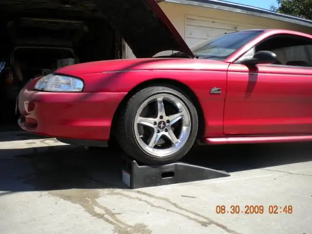

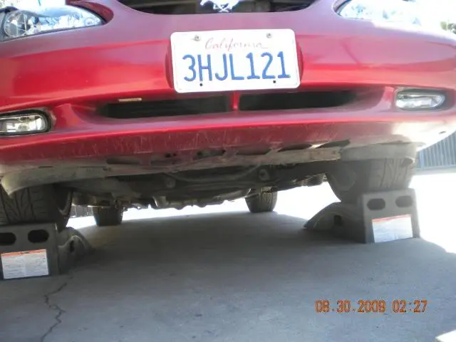

1.raise car.
if you are using the push pins and have stock springs,you may be able to skip this step.my car is pretty low,plus i wanted to change the oil.
i bought some ramps today at Pepboys,$32.00.
much eaiser than jack and jack stands.

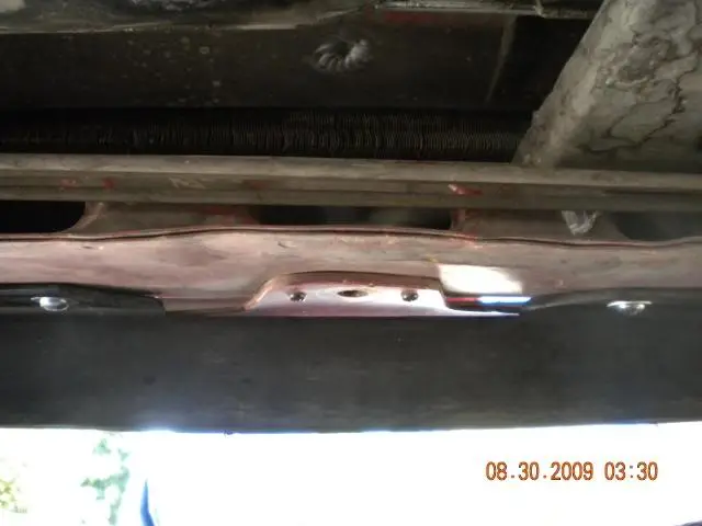

2.no deflector!

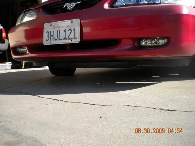

3.heres the deflector.
it is attached to the core support by 4 plastic push pins.
4.put in position.

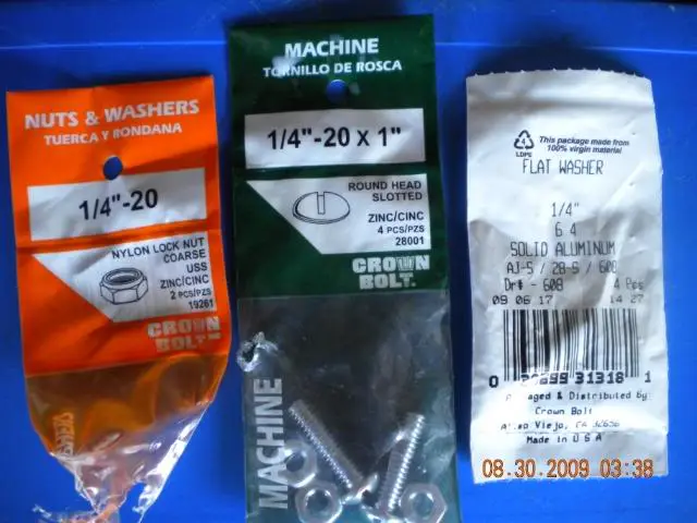

instead of the push pins,i used two bolts with washers and lock nuts.
i put the two in the center holes,and the plastic push pins at the ends,as there is no way too get the nuts in there.

5.put car down,all done.
