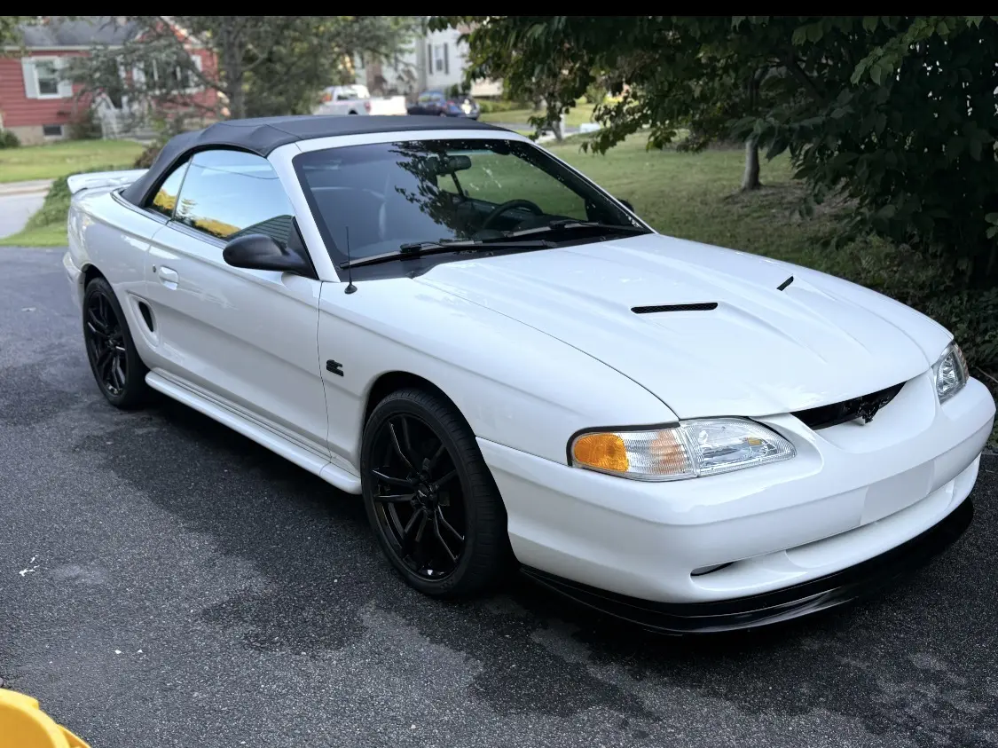

I recently got a 94 mustang after years of owning a foxbody . I have the driver seat out and see a bundle of wires running down sill plate side . There is about 20 wires in it . I would like to cut one wire and run it through a toogle switch to prevent the car from starting when key is turned on . any idea which of these wires would be a good candidate for this ? Thank you
