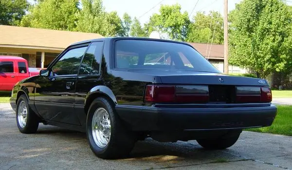

Does anyone know who owns this car? I`d really like to know the exact wheel
sizes and offsets...along with the tire sizes.
Thanks for any help.

Check out the november issue of 5.0 magazine and look at the white notch. It has a very similar set up, mabey exact same set up, but it gives wheel size, back spacing etc...

I went to the 5.0 Mustangs Website ,and it shows the cover of the November issue ...But does`n`t show the features from inside the magazine.
I`m thinking that the November issue is no longer on the racks at the store either :(

Can anyone take a stab at the size tire on the rear of this car,
If you don't know please dont guess.
275/50?
26/10.5? :rolleyes: :rolleyes:
I'm guessing 265/50/15....that's what I would run on a 15x8 with 4 1/2 back spacing. I've run the 5 1/2 backspacing too but my drag radials sometimes flexed and hit the inner fenders and the tailpipes. With the 5 1/2 backspace you could probably get away with a 285/50/15 Radial tire (regular radial).
