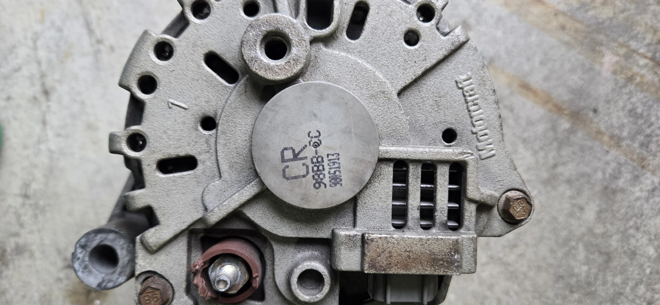

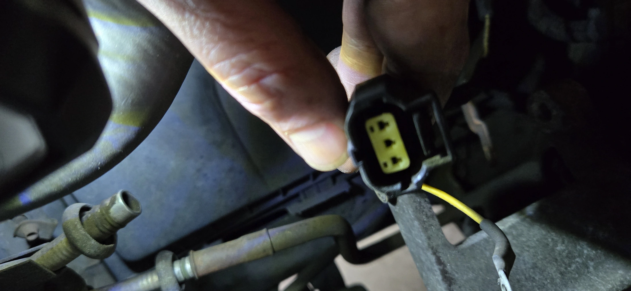

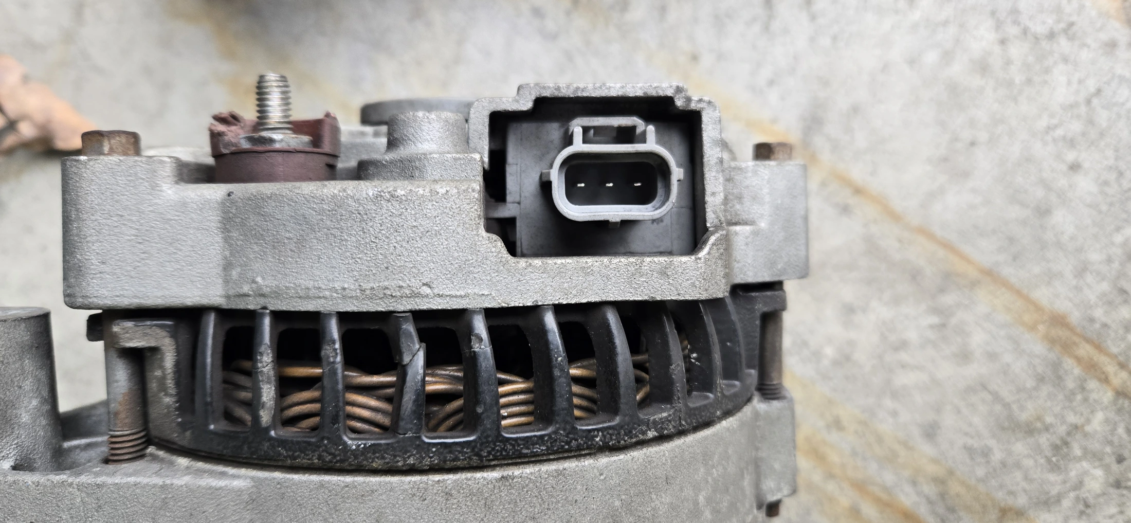

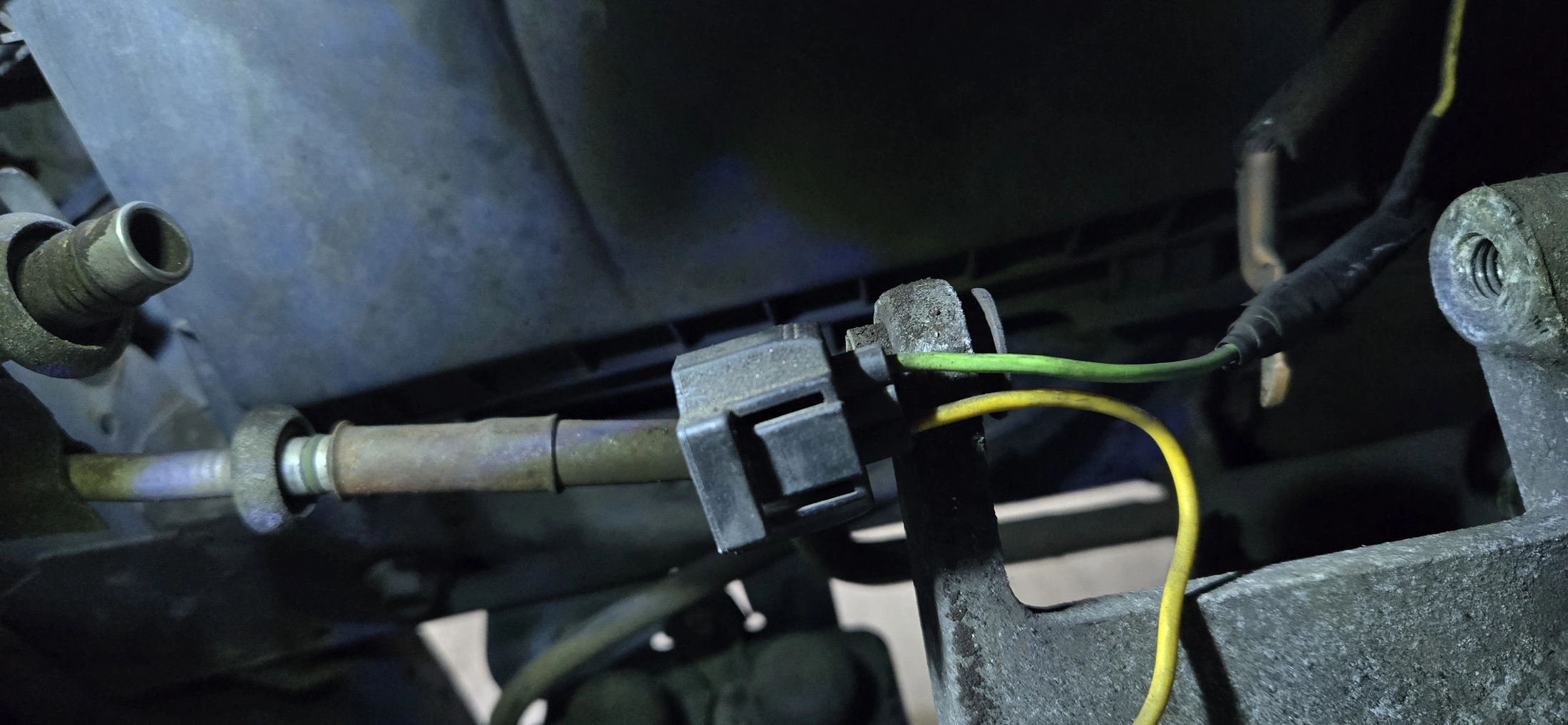

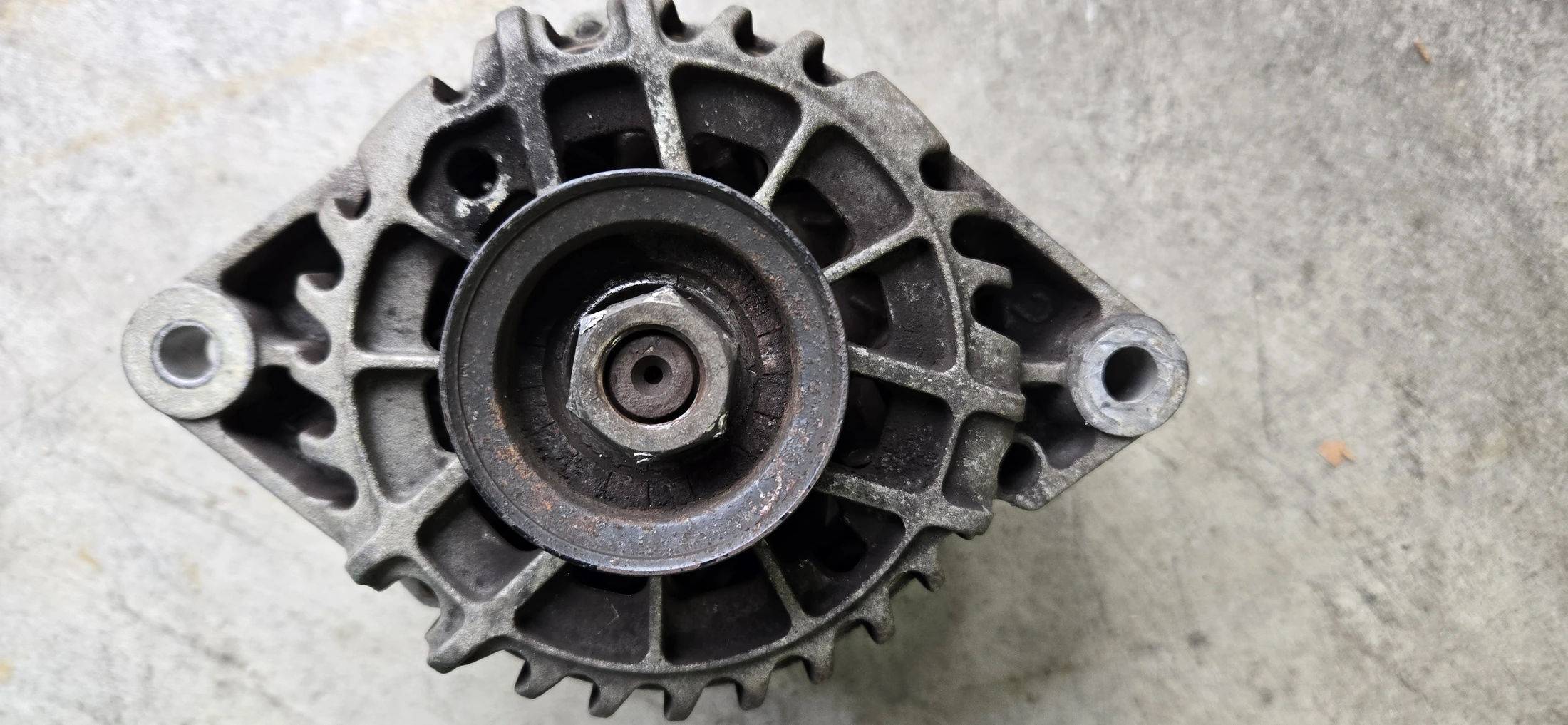

SuperStang83 Founding Member Mar 21, 2001 1,693 0 49 Boyertown, Pa Nov 10, 2024 #1 Nov 10, 2024 #1 Looking to find this alternator to replace but I'm unable to find one with the same mounting points and electrical connection. I imagine it came stock on some Ford but I can't find which one. Any help would be appreciated, thank you.
AeroCoupe lube between the nut and the face. I know my lubes Founding Member Oct 28, 2001 6,213 4,314 183 Claremore, OK Nov 10, 2024 #2 Nov 10, 2024 #2 Looks like a 6G off a 2001-2004 V6 Mustang. https://www.oreillyauto.com/detail/c/ultima/alternators---starters/alternator/f7cab2ae3cc0/ultima-105-amp-alternator-remanufactured/ost0/r111990a/v/a/5467/automotive-car-2002-ford-mustang?pos=1 Reactions: limp and SuperStang83
SuperStang83 Founding Member Mar 21, 2001 1,693 0 49 Boyertown, Pa Nov 10, 2024 #3 Nov 10, 2024 #3 That's exactly it, thank you so much @AeroCoupe, much appreciated!!
