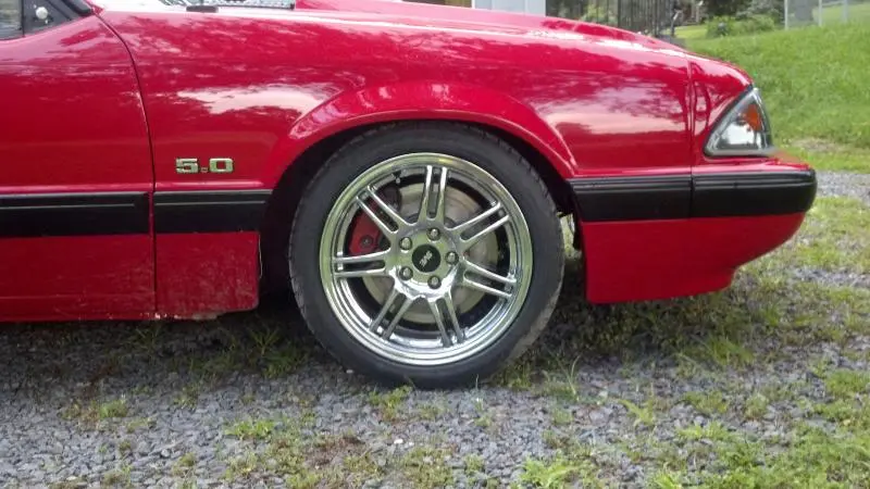

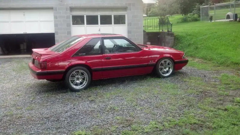

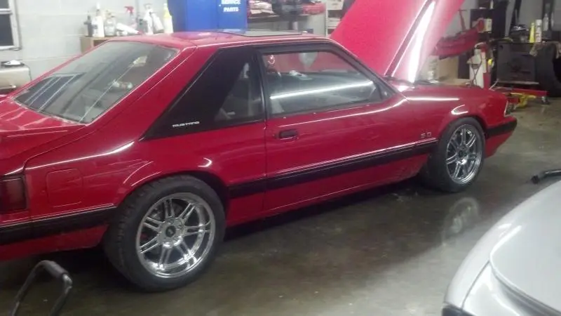

Just curious if anyone had a fox sit this low in the front. Tires tuck, but the fenders starting to tuck over them. Haven't had time to mount the fenderwells in yet. Front setup is Eibach sportlines, tokico blues, x2 balljoints, stock control arms, poly bushings, and MM C/C plates. The first time I set it down before I could drive it I had a small gap between fender and the tire. It's already settled to this after driving around a few times. Should I install the 1/2" spacers that comes with the x2 balljoints before I align it? Thanks. The rear is lower than that on flat ground. Don't mind the huge gap. It still has a rake to it though. The rear tires are outside of the quarter well line.

So far no. But the cars been down for 2 years for body work and a overhaul of the suspension and brakes. It's been on 2 trips to my dads store 100 yards up the road, two 3 mile trips to work, and one 5 mile trip on some backroads to test the functions. I don't want to drive it very far yet until I know everything is working properly.
I think it looks good up front. Brakes look good too..What are you running in the back?
Did you install the upper & lower isolators up front?
I am running the sportlines all around. I installed new poly isolators on my front coils a few months ago and there was a definite improvement in ride quality. Front end raised about 1/4" - 3/8". Tires 235/45/17 used to rub at the locks. Now, tires don't rub.
It looks great!
Like others have said, if it doesn't rub, then you have the first step beat.

That's odd, I don't have that issue, and I am that low. I don't know why either.
The only issue I have had, is that I can not run inner fenderwells. If I do, it rubs like crazy with every little bump or dip I hit. I am actually trying to find a way around this. Can you run your fenderwells with no issues? Its even worse with a passenger in the car.
