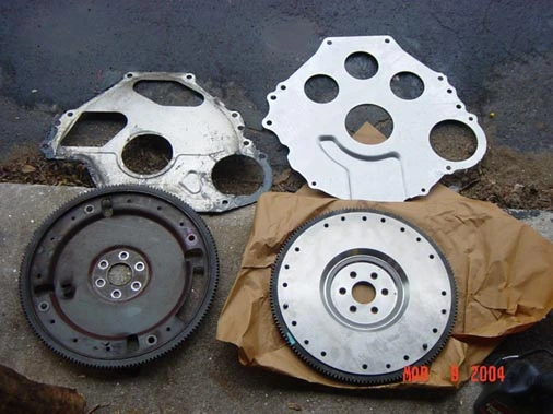

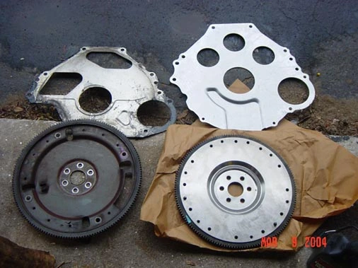

Here ya go, left side is AOD stuff and right side is T-5 stuff.

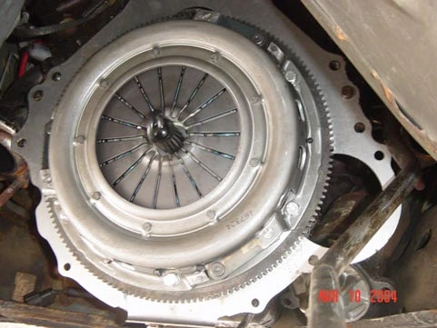

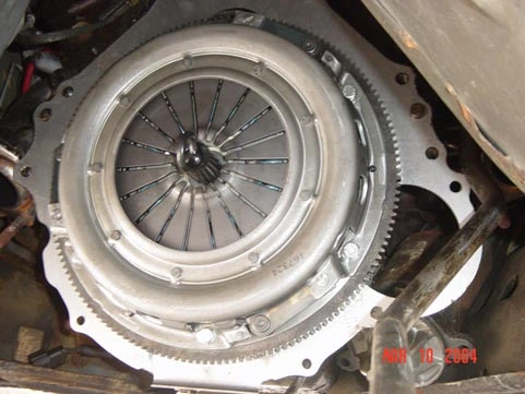

Here's another pic for the first guy for the order of the stuff.
