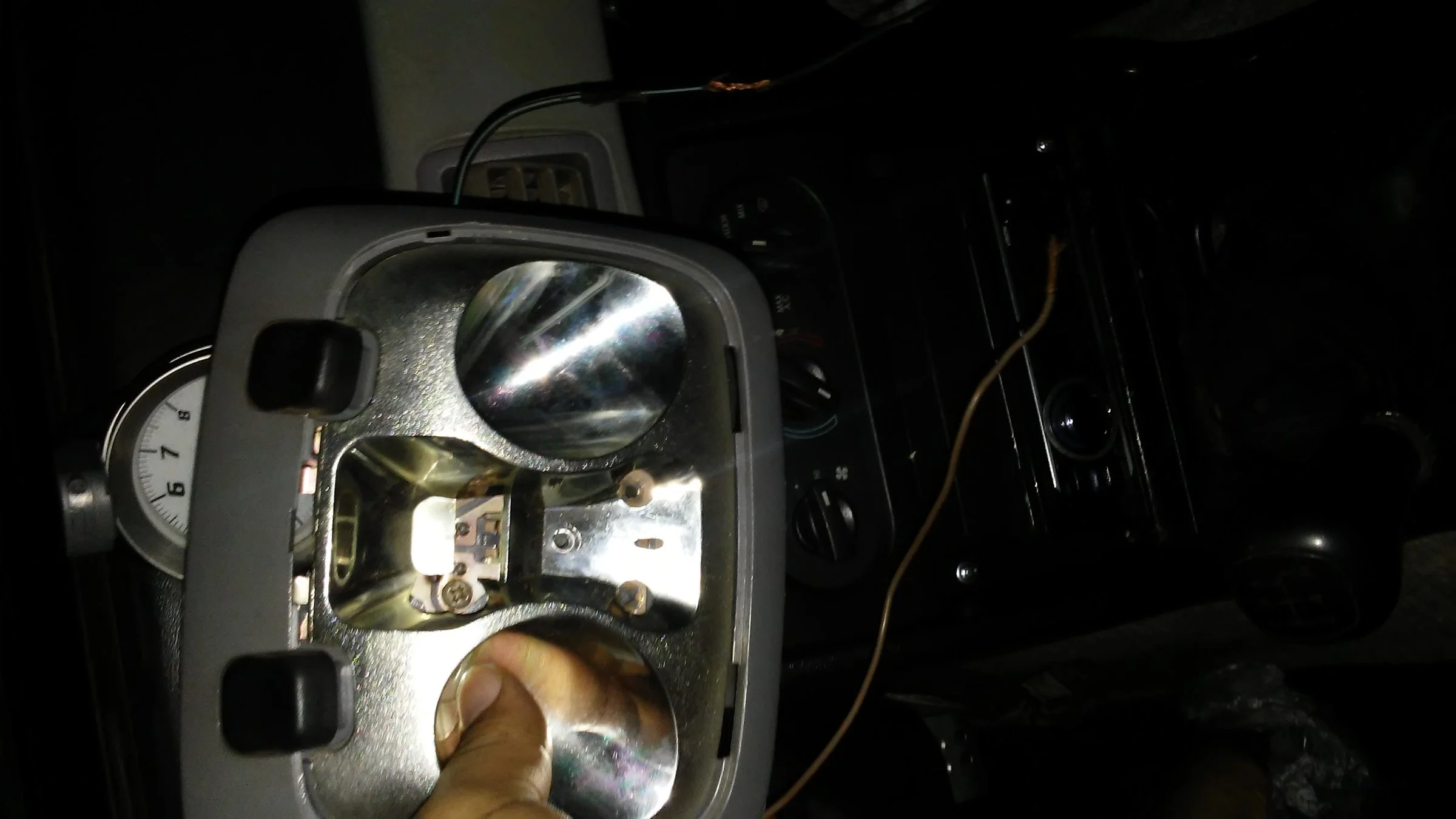

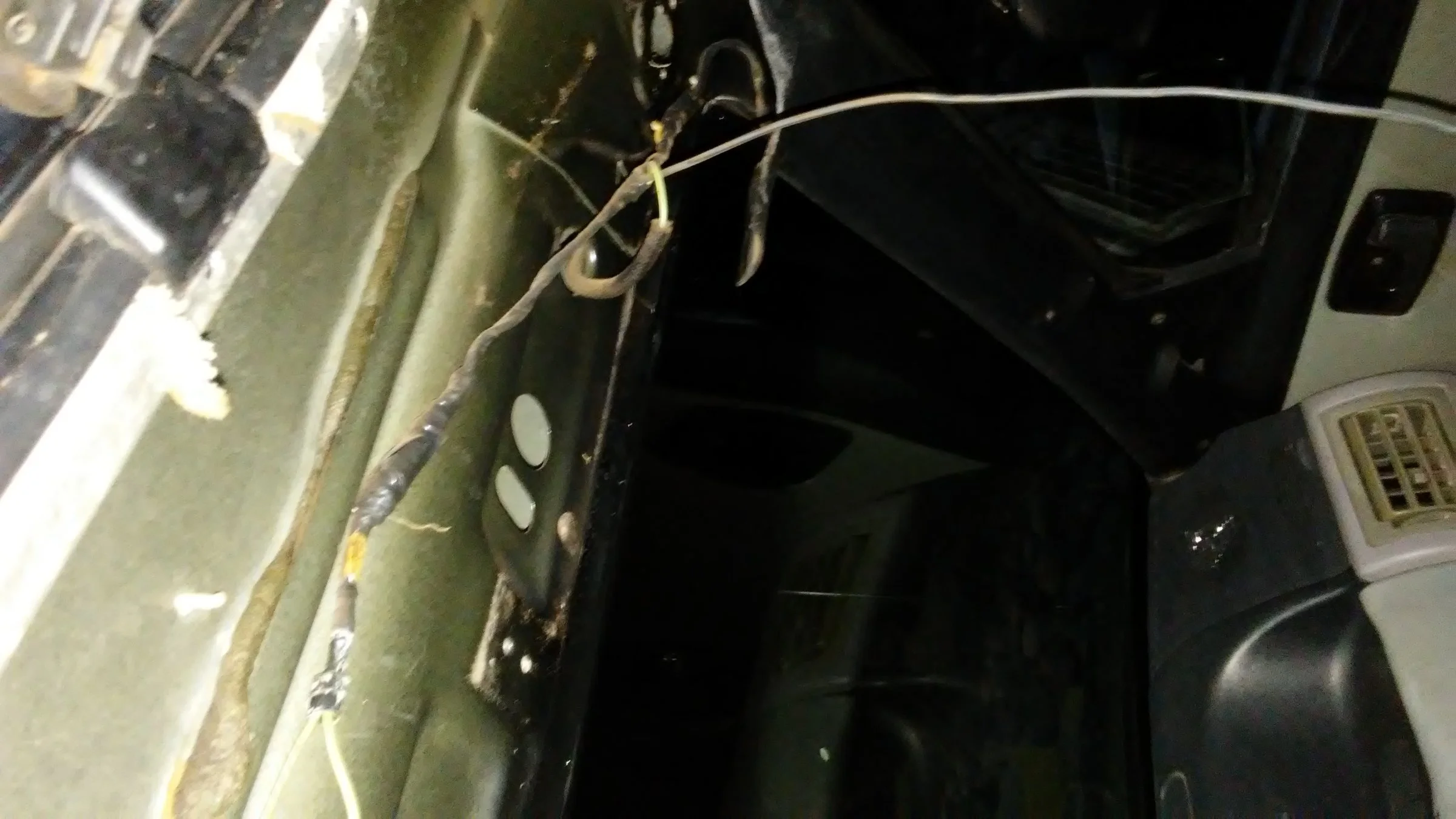

Hi I am new to the forums I hope I am posting this in the correct place, I searched for more info but have not been successful. I recently acquired a 91 mustang that has a LOT of wiring issues, so many in fact that I won't even bother trying to fix most of the interior lights. one that I WOULD like to fix is the dome light, I just want it to turn on when a open the car door. I don't even know where to start! right now is the best time for me to fix it because I removed my headliner to re-do it and I have easy access to all wires. when I took it apart I ended up with 2 dome light pieces and 2 broken wires. I see a brown wire which I assume is a ground and a blue/black wire which I assume is power, I don't know where to hook them up to where the light will work or if any of the parts work at all. I need help figuring this out. These are the best pictures I could get right now. I don't know if they are helpful but it got dark on me. if you need more pics just let me know and I will post them tomorrow.

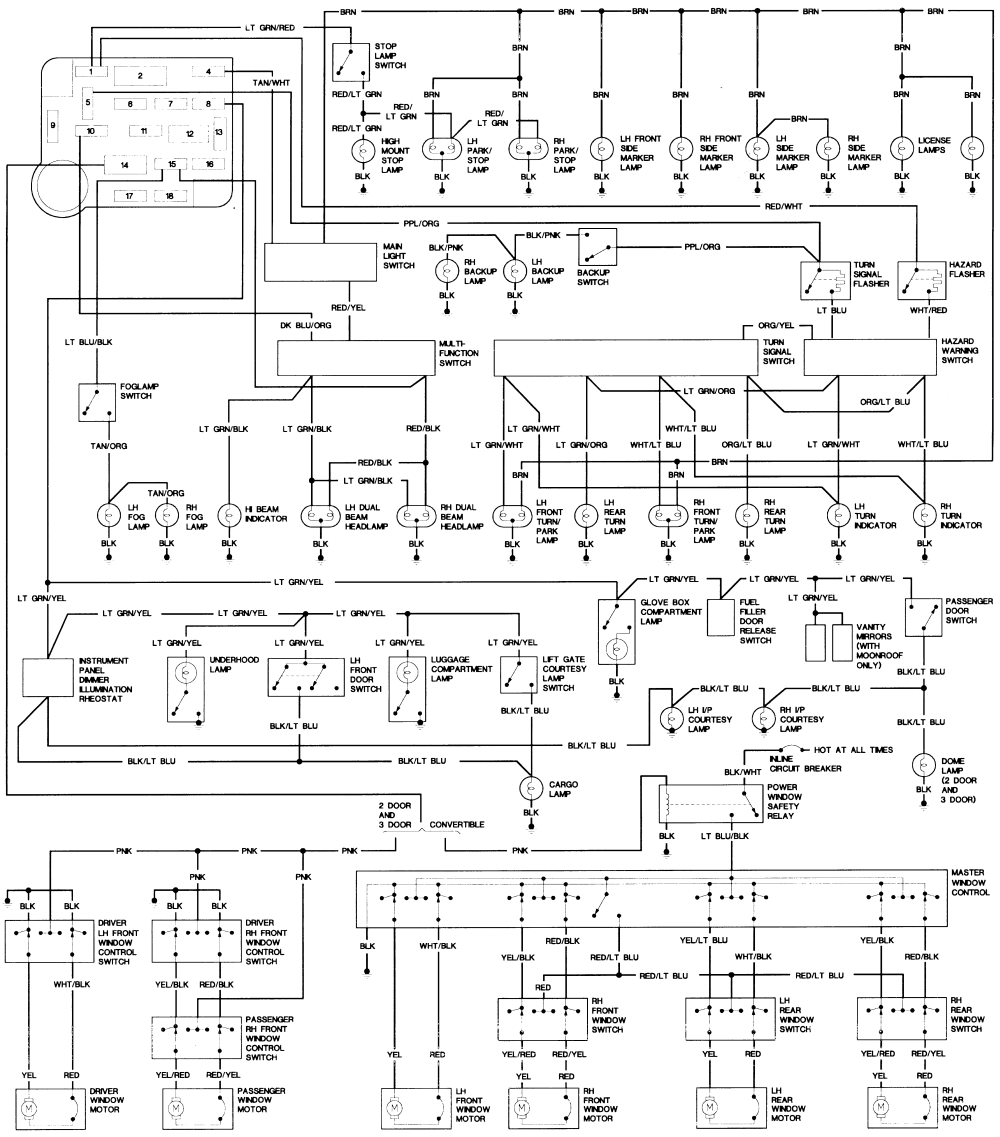

I'm not sure what exactly is going on with your dome light man. The button switches in the door jam cut the light on by grounding the circuit. That would mean that power must run up there constant. ( meaning it always should have 12 volts ) I believe the wire that runs to the door switches is brown.
This diagram is for an 87....the fuse location is #8.
I can't see the whole schematic in my phone but if you save it- it should allow you to see the whole image.

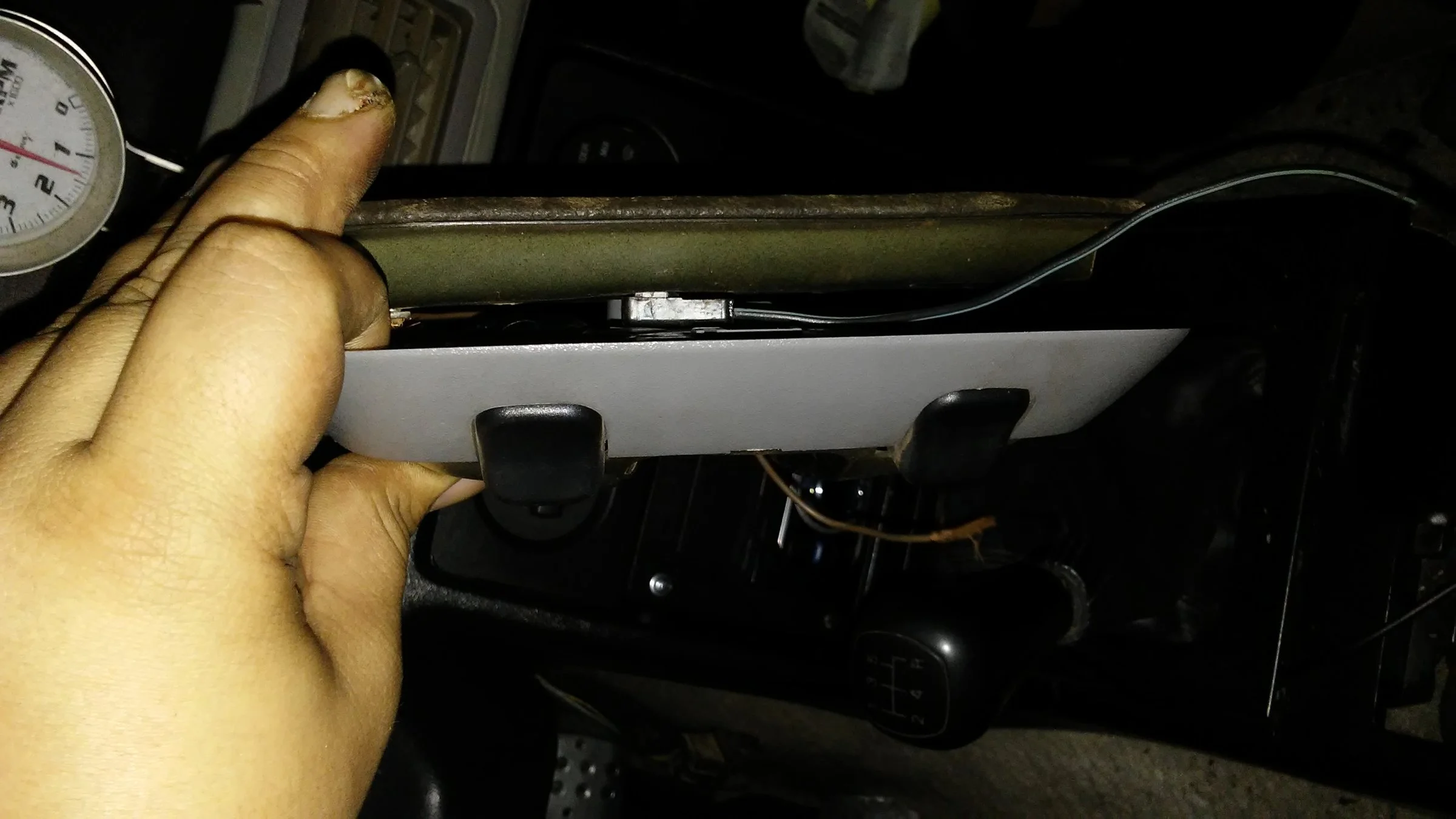

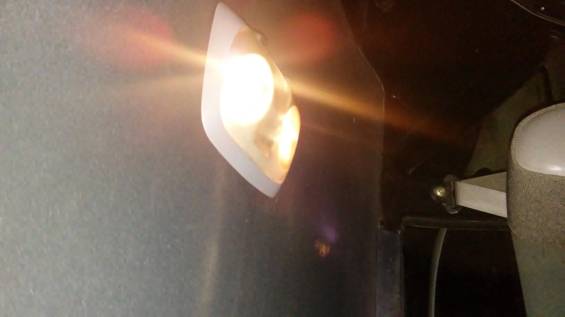

Time for an update: I got it all working! I am so happy to see that light come on every time I open the door.
I started by testing the fuse which checked out. I then tested the dimmer switch which was faulty I changed it for one I had gotten earlier at a junk yard. still nothing. I ended up tapping fuse #4 on the diagram and running a new wire, I grounded it and it worked, I had to replace one of the bulbs and then the door switch assembly and now I have a dome light that works.
This was all started with installing a new headliner (which was a much harder task than anticipated since the backboard disintegrated and spilled a ton of black foam dust on everything! I had to drive 150 miles to the next town over to get a new backboard. all in all it was a good project and the results are fantastic, sorry for the poor quality of the pics.
