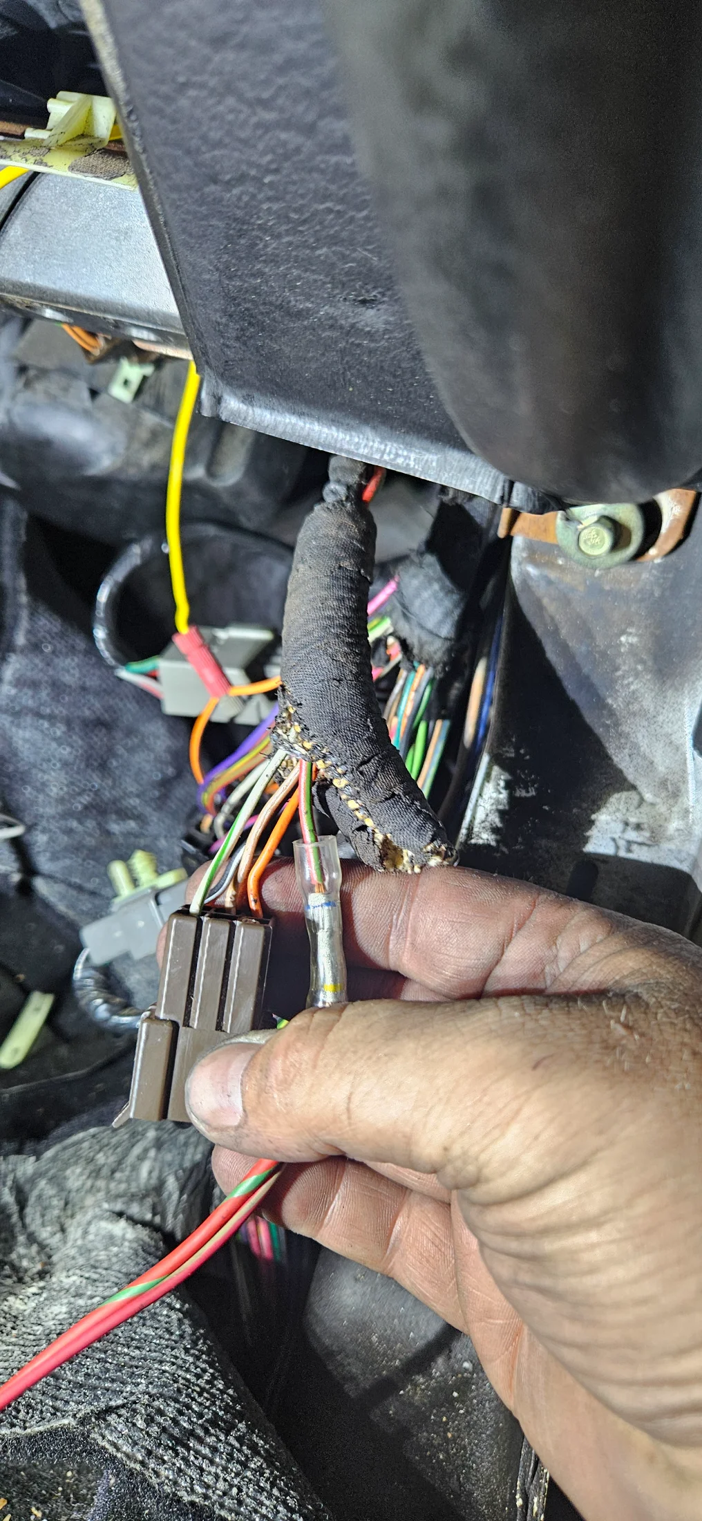

Can anyone identify this connector?
74delta
Jul 4, 2026
Massachusetts
Working on fixing a bad wiring job on my 1995 gt and found this plug not connected to anything near the ECM. Google wasn't a lot of help hoping someone here might know. The PO tapped into a wire on it for power and thats all I know. It is the brown one.

I do not possess a full diagram for a 95 but I think that connector is a diagnostic connector that is not used on the GT.
Check and see if the tapped wire is 12V with ignition on/off. The PO may have tapped that wire to power something.
