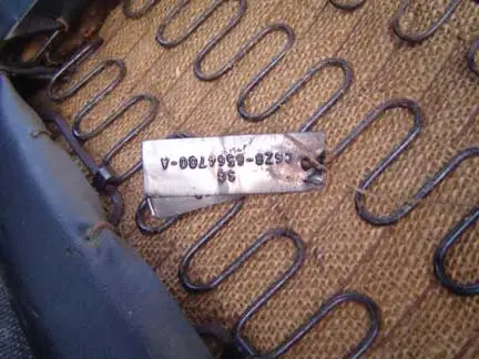

On my car the drivers side door is missing the vehicle identification plate(not the VIN on the dash). With the plate missing I cant tell what my cars interior code, or any other code for that matter was. Is there any way that I can find information about my cars options and other information?
remove your seat look underneat, you will fine similar code.
