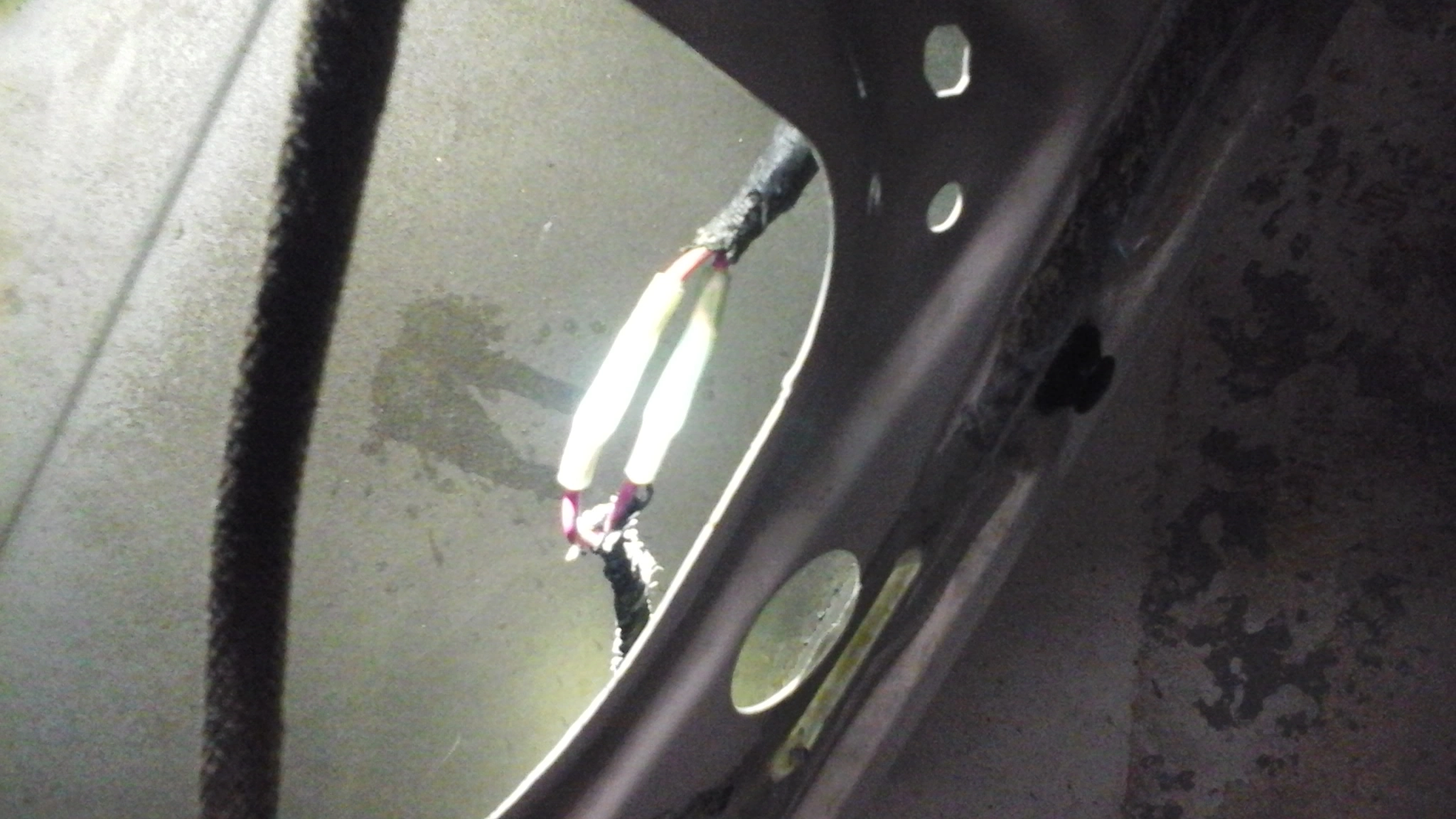

So i took the door panel off and I think I have new actuators in the car on the driver side. I wonder is this suppose to look like this ? Do you think this is my problem? Shoukd I cut this and switch the wires?

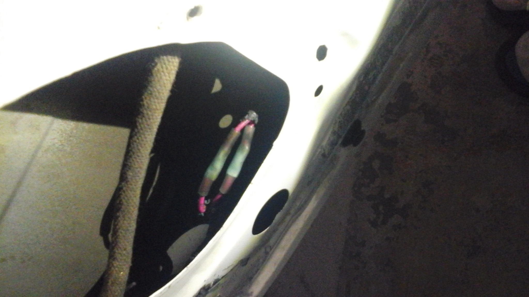

Well they are both backward. on the passenger side when I hit lock the passenger side locks but the driver side opens. on the passenger side when I hit unlock the driver side locks and the passenger side unlocks. it's the same scenario on the drivers door. so you think I'll have to take the other door panel off and change those wires too if it looks like the drivers door
It sounds like the drivers door is the one backwards. The passenger side is working correctly. Swap the wires at the drivers door actuator and see if it fixes your problem.
Thanks sick fox. last night I switch the wires on the drivers side actuator. Both doors now work in sync with each other. The funny thing is now when I hit unlock on the driver door both doors lock and when I hit lock they unlock. Now when I hit the passenger side door locks they work fine. I can live with that. Just wanted to say thanks again and tell you that.. There's always something
