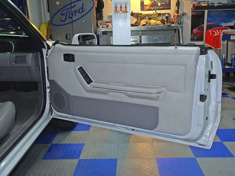

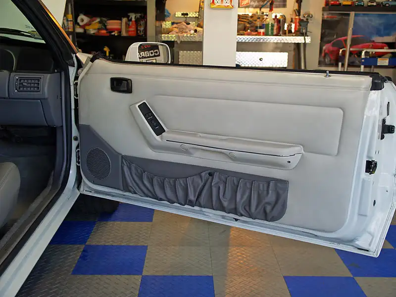

I replaced mine. They were under 100 bucks shipped on Ebay. They look much better. I like the pockets when they are nice. I like the factory FOX interior. Nothing against custom work though.

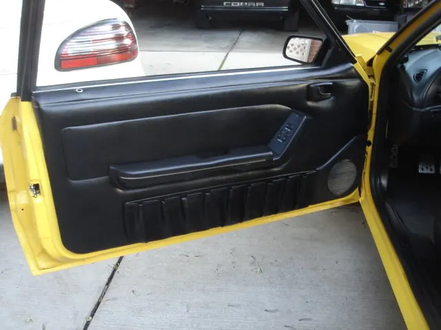

I removed the pockets and replaced them with leftover perforated leather from my seat project.
